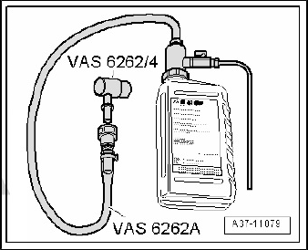

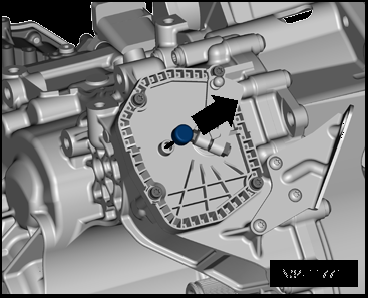

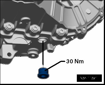

Drain plug - as on any gearbox
Filling is not straight forward. There is no filling plug, and there is no way to check the oil level.
You need to use a tube and insert it through the "air release hole" on the gearbox.
To be sure that you really get 1.9 litres into the gearbox this has to be 100% tight, and therefor the use of the original adapters are highly recommended

As @norsko says you need to get the quantity exactly right using something designed for the job
I have nothing against someone doing their own and more than manufacturers recommendations is sometimes not a bad thing as they often get it wrong, but if you are doing this sort of off-piste maintenance you should at least have access to these manuals preferably from the official source against your chassis number so the information is correct for your car. Some versions of this same gearbox have different quantities and filling methods. ErWin is not a secret.
