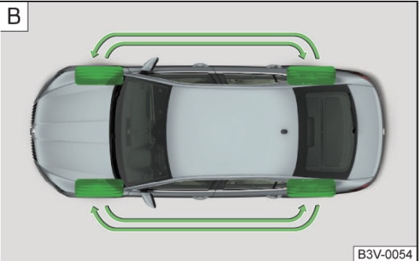

On FWD cars I'd keep the tyres with the most tread depth on the front. These are the driven wheels, they do the steering, and they do the most braking, in other words they do the most work and will likely be the ones that wear down quickest, whereas the rears are free rotating followers and Škoda appear to agree with me. This is what they say in the manual...
Notes on using wheels
Read and observe on page 217 first.
New tyres do not offer optimum grip during the first 500 km and appropriate care should therefore be taken when driving.
Always fit the tyres with the deeper tread depth to the front wheels.
As for how and when...
5a2dd6ebe0538_ScreenShot2017-12-11at00_48_02.jpg.1c190606473c8e8bccfa40c08f1aa5c1.jpg
For uniform wear on all tyres, we recommend that you change the wheels every 10 000 km according to the scheme » Fig. 236 B .
You will then obtain approximately the same life for all the tyres.
After a wheel has been replaced, the tyre pressure has to be adjusted.
In vehicles with tyre pressure monitoring, save tyre pressure values.
