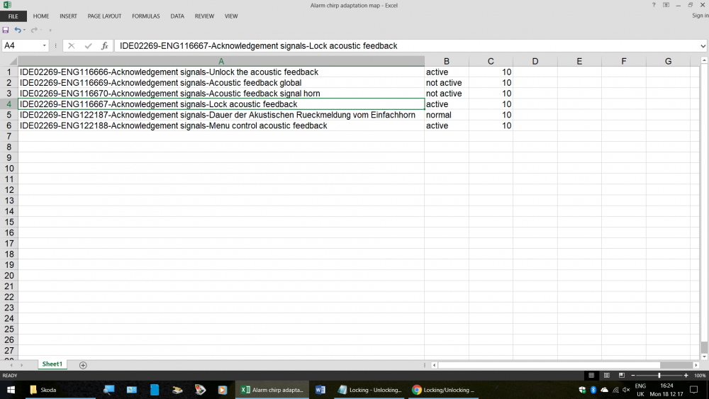

I enabled this today which leads me to ask if anyone knows the thinking behind disabling something which can be disabled anyway by the infotainment screen once activated by VCDS.
Why hide it behind VCDS or dealer diagnostics?

With VCDS you have to activate the unlock the acoustic feedback, activate the lock acoustic feedback and activate the acoustic feedback menu control. It should all work then from the infotainment screen. There may be another activation if you don't have an alarm fitted - google translate can tell you the details.
