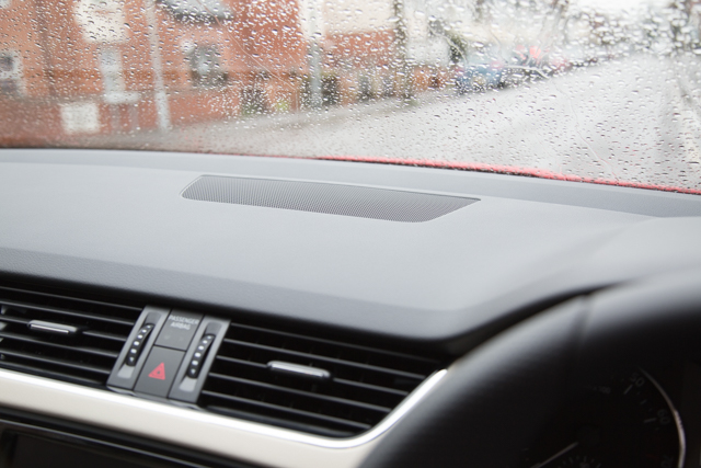

Also there is a loud rattle that is coming from the grill that is in the middle/top side of the dash :angry: - does anyone know if this is removable at all? Didnt want to start attacking it and wreck it.

The rattle definitely comes from the grill in the dash, if I tap it with my fingers it rattles (exactly the same noise). Is there a speaker behind there ?
What is this grill?
I dont have this grill on my 2014 vRS. Do you have the Canton audio upgrade? maybe an additional speaker?

I have no idea what is behind the grill, I thought it was just standard :blink: I am not sure if it had the Canton upgrade - it doesnt have the sub unit in the boot so i presume not?
Would be nice to have the hesitation sorted but as you say chances are VAG/Skoda are probably not as interseted anymore
Looks like a speaker to me though...
If you turn up the stereo & increase the bass setting do you feel a vibration?
I'd imagine this will be quite difficult to remove from the top...
I'd guess the best thing is to ask at a Skoda garage for advise how to remove yourself?
If you find a nice technician he may give you the removal instructions..
But my feeling is its a dash out kind of job...

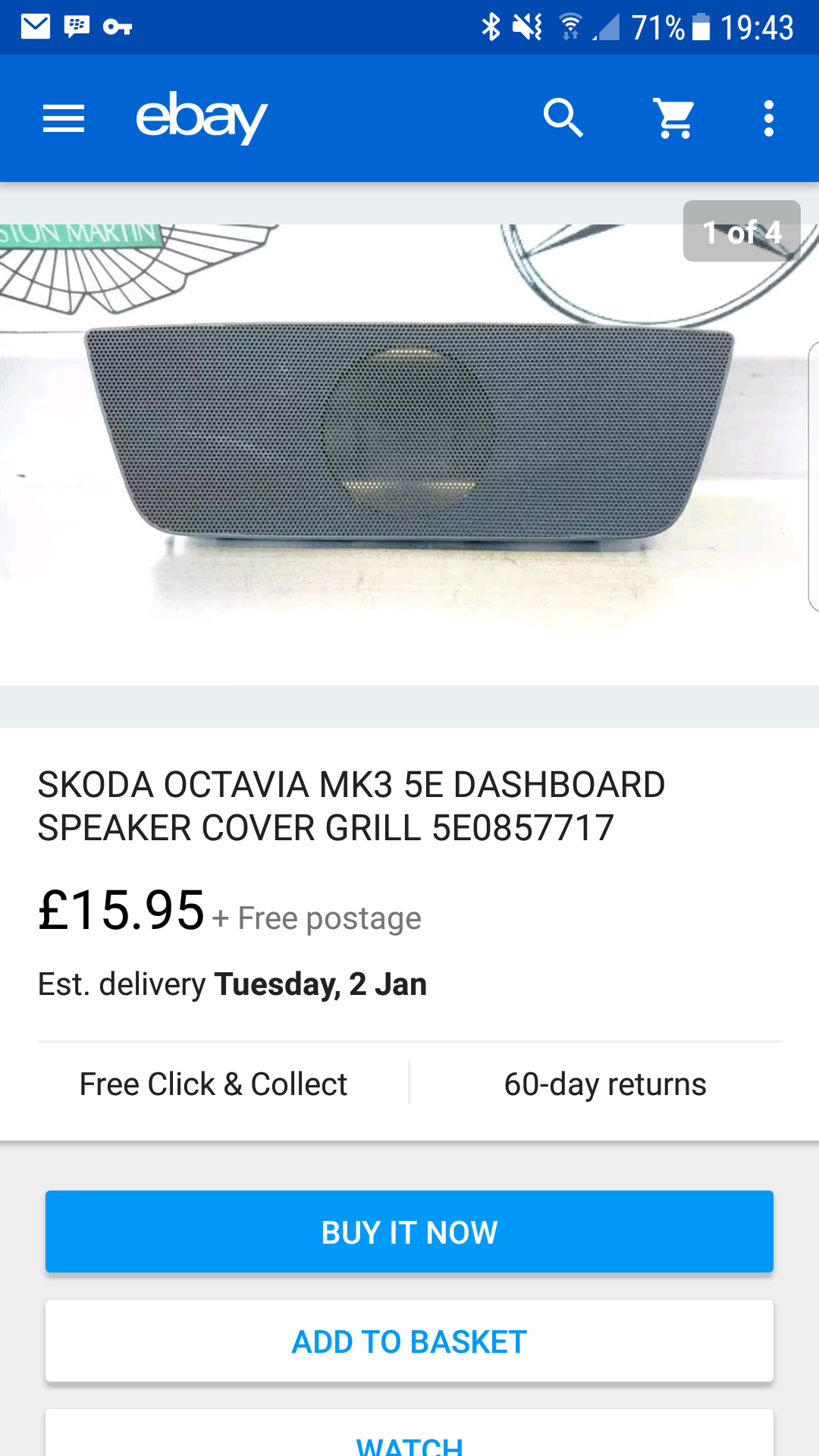

Mine has that grille, but no Canton. (Canton grille - sounds like a takeaway :biggrin:)
I do have that same bloody rattle tho :@
If it costs <£40 I'll smash the bu99er out to fix the rattle beneath and replace it with a new one...
For £15.95 I think I will take the risk and try and get the thing out :D
Please let us know how it goes :)
