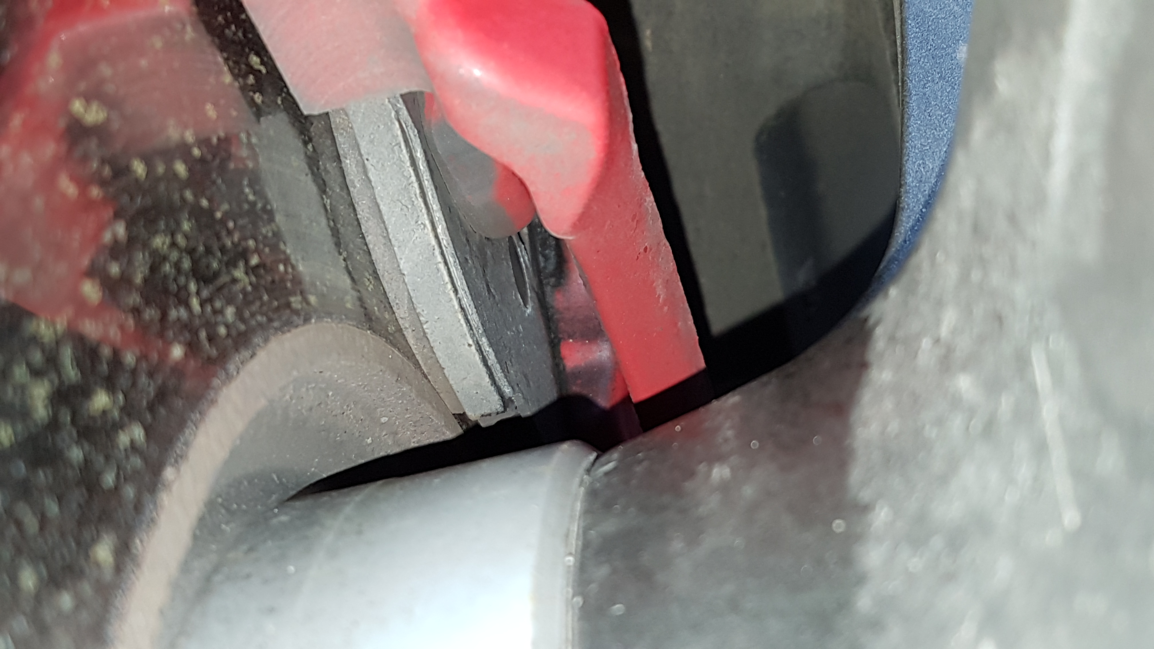

Looks like I need front pads alright :nod:
