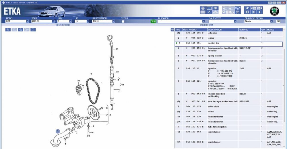

My money's on the oil pick up pipe being blocked up being the cause of the light coming on. Had you stopped and got the car recovered when the light came on, it would have been a much easier and cheaper fix, from memory a new pick up and o ring is about £20.

Items 2 and 3
