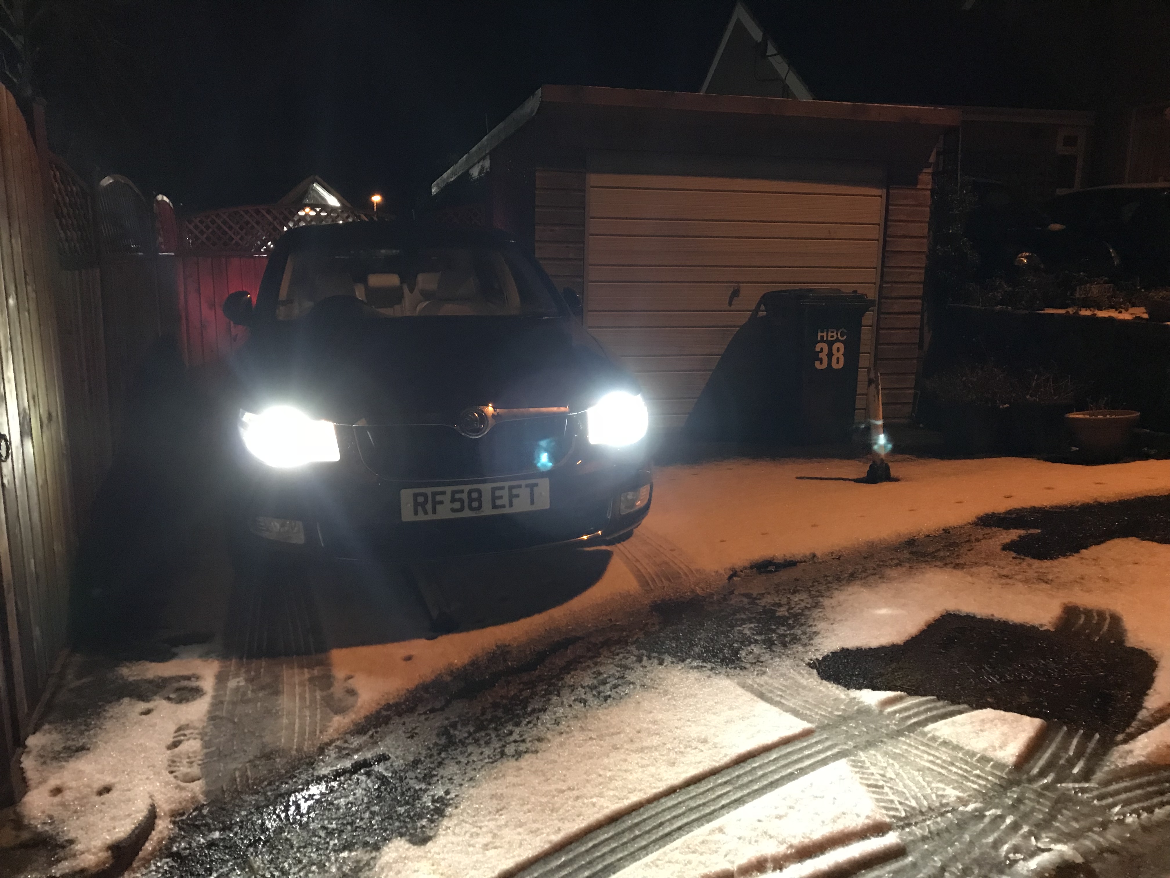

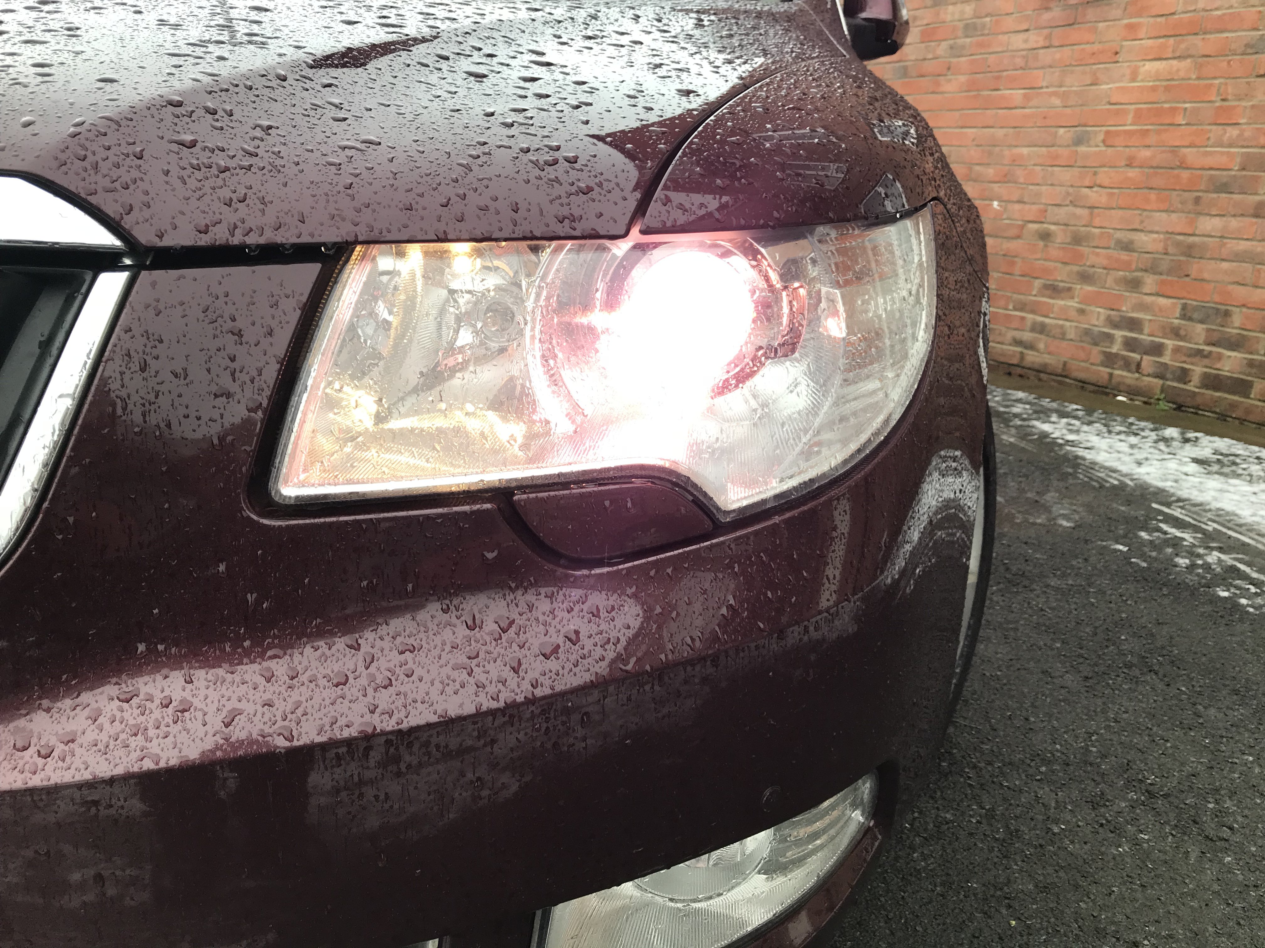

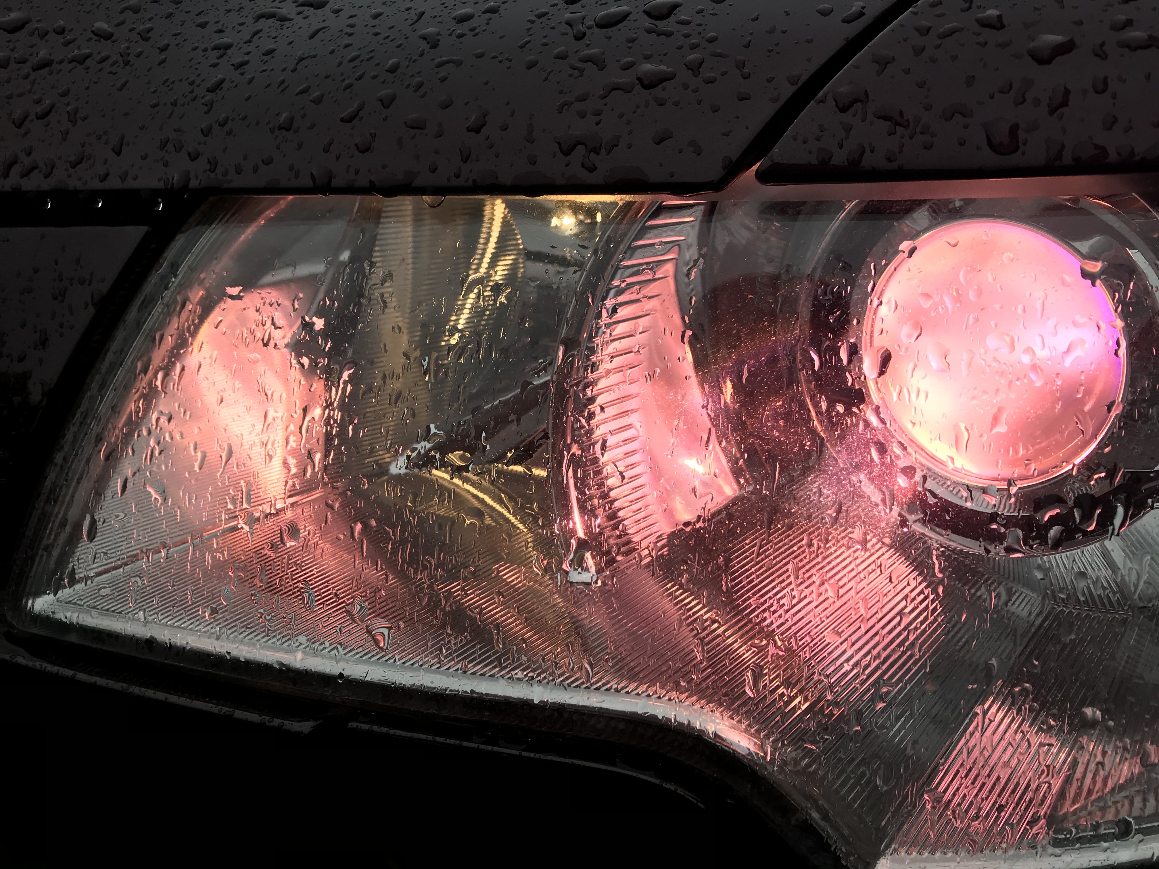

I woke up today and noticed that my passenger side bulb was tinted pink and the drivers side bulb was perfect, as usual.

The pink tinge or hue is a clear sign of a failing xenon bulb.

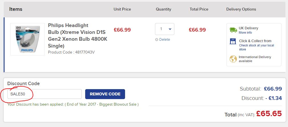

Ive found two DS1’s on euro car parts that I have taken a liking to. Which would you personally choose? The discounts are phenomenal!
https://www.eurocarparts.com/ecp/c/Skoda_Superb_2.0_2009/p/car-parts/car-electrics-and-car-lighting/lighting1/car-bulb/?48177043C&1&6ea2ec4a3986676ccb5c84acaf851ce5857be459&000384
https://www.eurocarparts.com/ecp/c/Skoda_Superb_2.0_2009/p/car-parts/car-electrics-and-car-lighting/lighting1/car-bulb/?48177043V&1&23f1edea2733d9e7439e6749e1825c29b117bb5c&000384
Cheers for your help
You can't really go wrong with either, both brands have a good reputation.
If you want to stay as close to what you have today I'd go for the Philips.
Your current OEM bulbs are around 4,300K.
The Philips are closest at 4,800K, the Osram's maybe a little 'too blue' for my liking at 5,500K.
If using eurocarparts be sure to use the 'SALE50' discount code at checkout for another £1.34 off...
