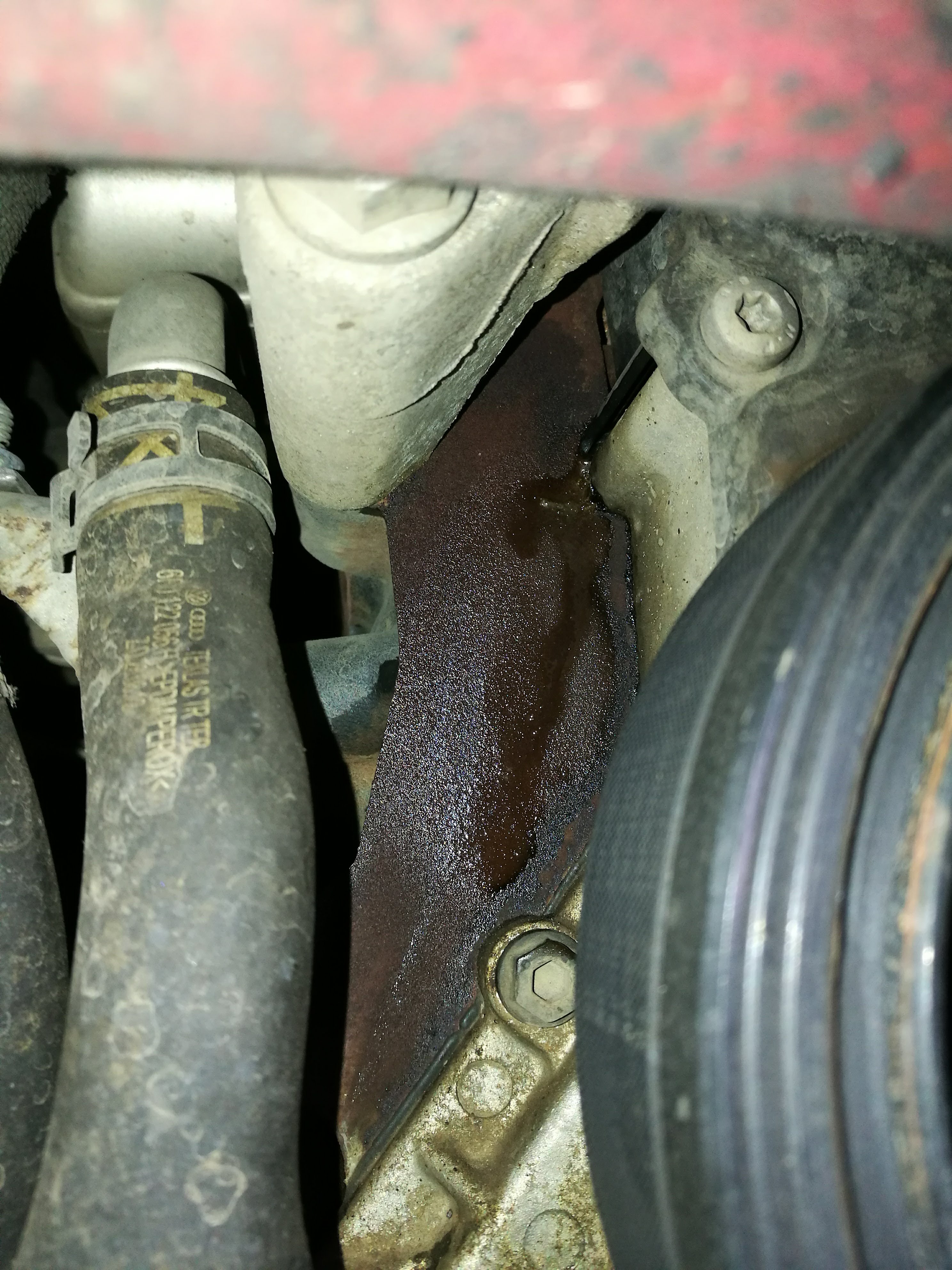

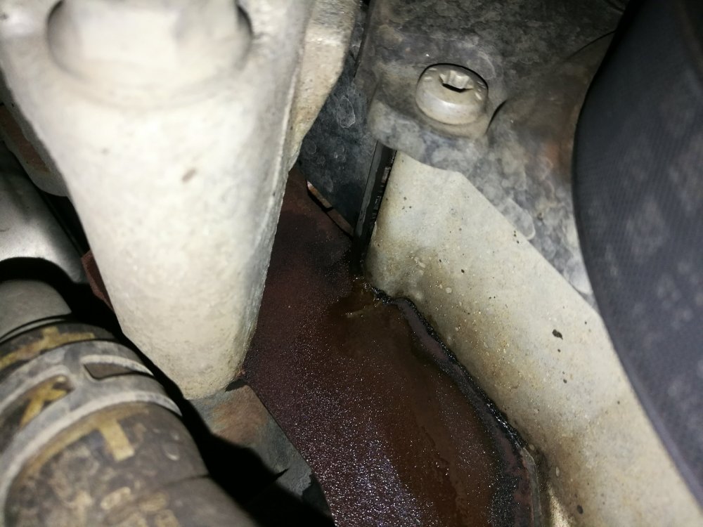

i found out where the coolant leak is from. Somewhere behind the pulleys. I took the picture from under the car. The pulley in the picture is the crankshaft one . When the engine is off it drips very very slowly. When it's on the drips are a lot more frequent. Does anyone know how to fix this? Water pump gasket?it looks expensive :(

If its the water pump gasket, its most likely needing the belt and water pump replaced as it CAN be the same job, labour-wise. (I refer to water pump etc on 1.4 diesel so may be different). It would be stupid to change the gasket and retain the old parts.
New water pump.

that's right. Diagnosed as leaking water pump. replacing the whole kit + ancillary belt for £440. It failed at 65k miles. I thought it would last a bit longer than that.
Failing at that is a bit early but its about the recommended area to change anyway. Most will not fail but the manufacturer will err to the side of caution so as to avoid costly warranty claims, sell more parts and labour etc and keep the wheels turning. You were the unlucky one, sorry to say but others will have swapped a perfectly good pump and belt, along with a chunk of dough, for peace of mind. Others will have got lucky and waited a fair bit longer and a few will have had a major disaster!
