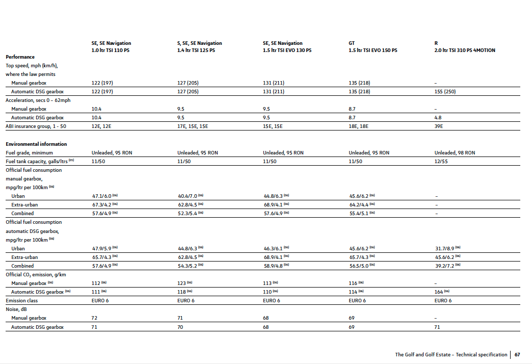

7 hours ago, Exeterj said:
Says minimum as 98 RON for the R on page 67

22 hours ago, AwaoffSki said:
Not seeing where it says that on page 67.
Its a bit crap pdf (page 34 of the pdf but you have to scroll fully to the right) - attached screenshot.
Thinking more on it, we'll run with 99 tesco or shell v power (having run diesels for last 10yrs i'm not sure if we get nitro in Devon) most of the time anyway, as has been said i'm not expecting to run a golf R or anything similar for cost/fuel efficiency benefits. i think its more about knowing its not going to be a major issue to run it on 95 unleaded if we can't get 98+ (well 99) if we're out somewhere unfamiliar.
Edited by Exeterj

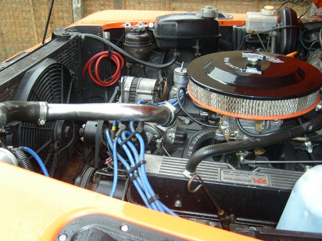

I have ran LPG as well, on my Tow Barges towing my vehicles running Super Unleaded & 102 ron some on Alcohol / Ethanol/ Nitros.
LPG on this RPI Stage 2 engine gave 3 miles to the litre towing & it was 50 pence a litre which was half the price of Petrol.
(All make a poor built engine go pop!)
10 Litre LPG gave 30 miles & cost £5,  a Petrol V8 110 might have got 12-15 miles for £5.  Much Cheapness.
220 litre tank giving 660 mile range towing. £110.
(Diesel now & 63 litres might get 630 miles and only £76 and nothing like the same fun.)
As to the lower price and efficiency it is equal to 108 Octane.
My 4.6 V8 ran only on LPG and had no petrol for starting and no petrol carried as then no Tachograph was required. for towing commercially.
Same engines as built by RPI for Mogans racing & others and Scandinavian countries where owners need to keep the Classic 3.5 V8 capacity but want more power.
http://v8engines.com
Edited by AwaoffSki

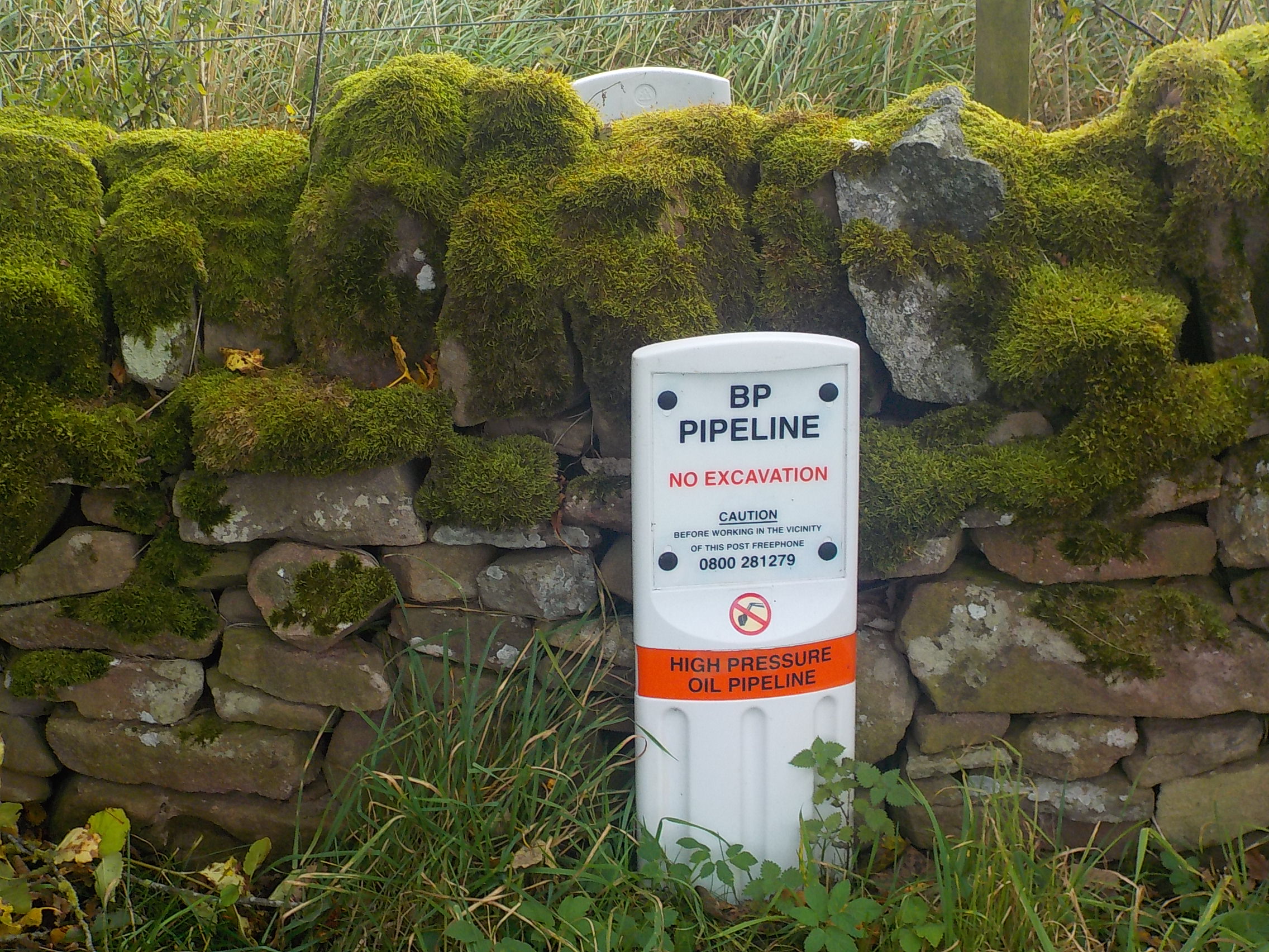

LPG was just really considered a by product takes off the Oil as it travelled up the Forties Pipeline from the North Sea to Grangemouth and the Petrochemical plant. Years ago not considered much value, things have changed though.
Edited by AwaoffSki
