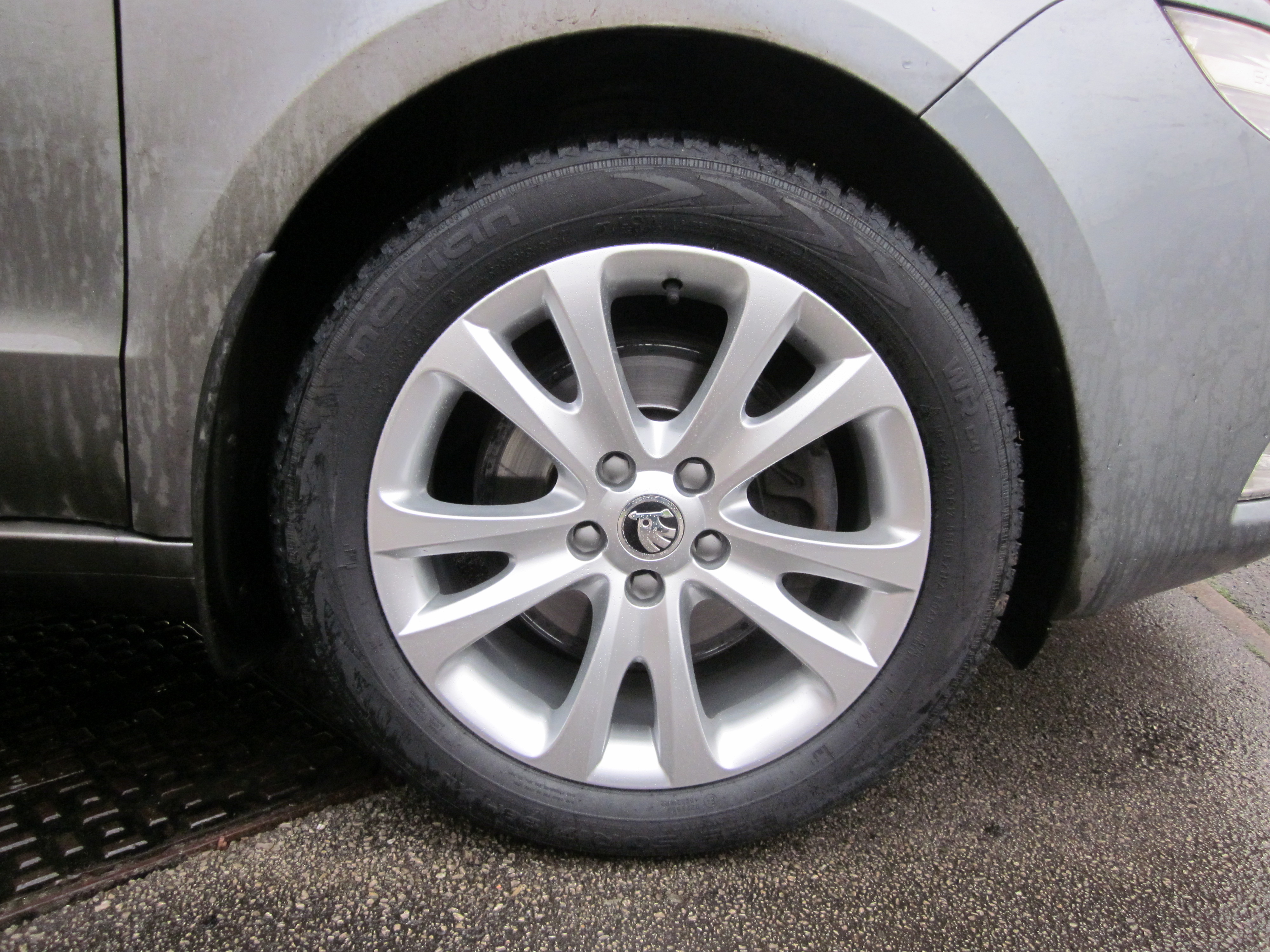

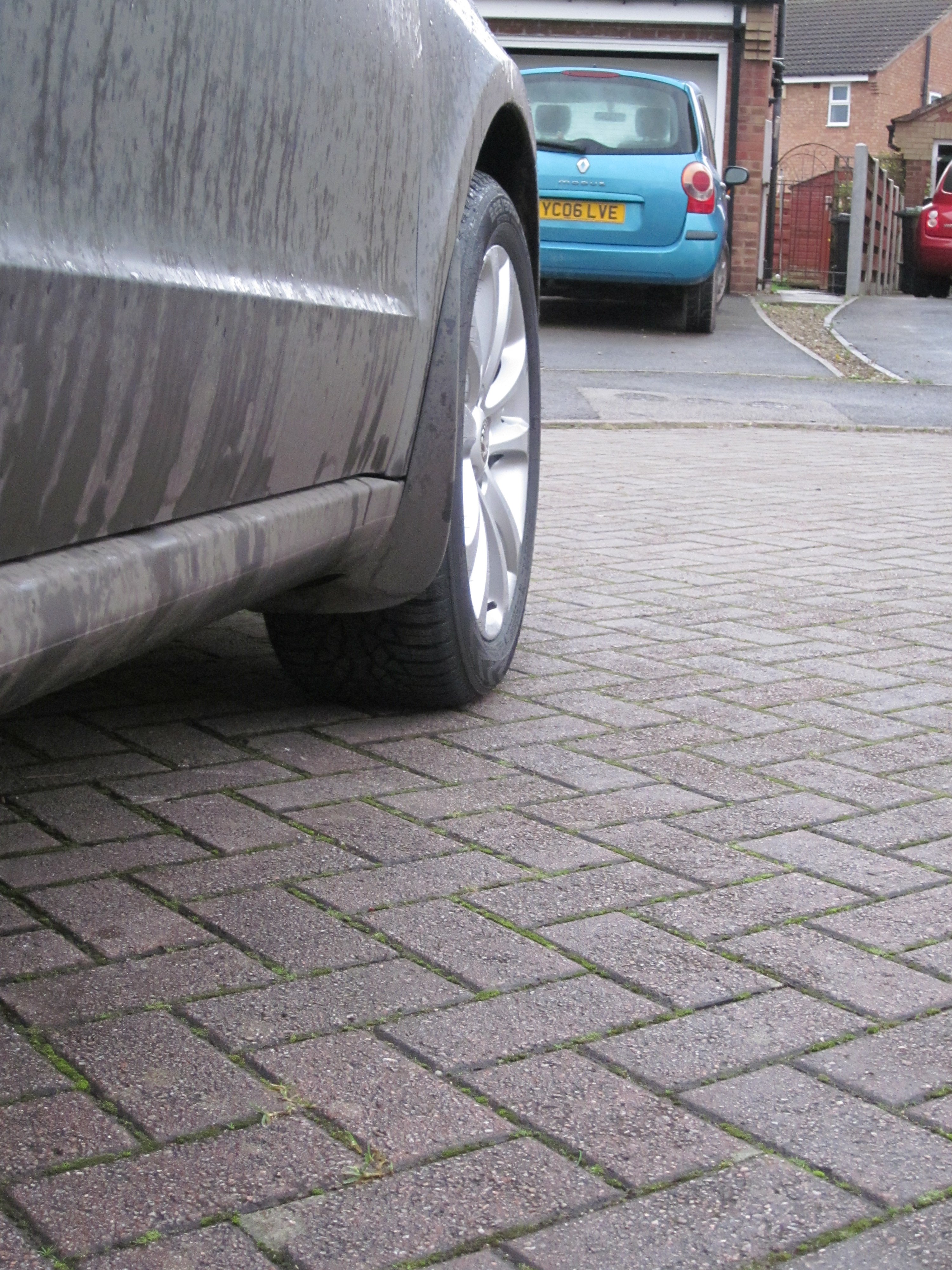

I have fitted VW Road America 16" as winter wheels. They have an ET of 37 which makes them sit very nicely and flush with the wheel arches. I had a skoda 16" set with an ET of 45 before and I hated the disappearing-in-the-wheel-arches look.
