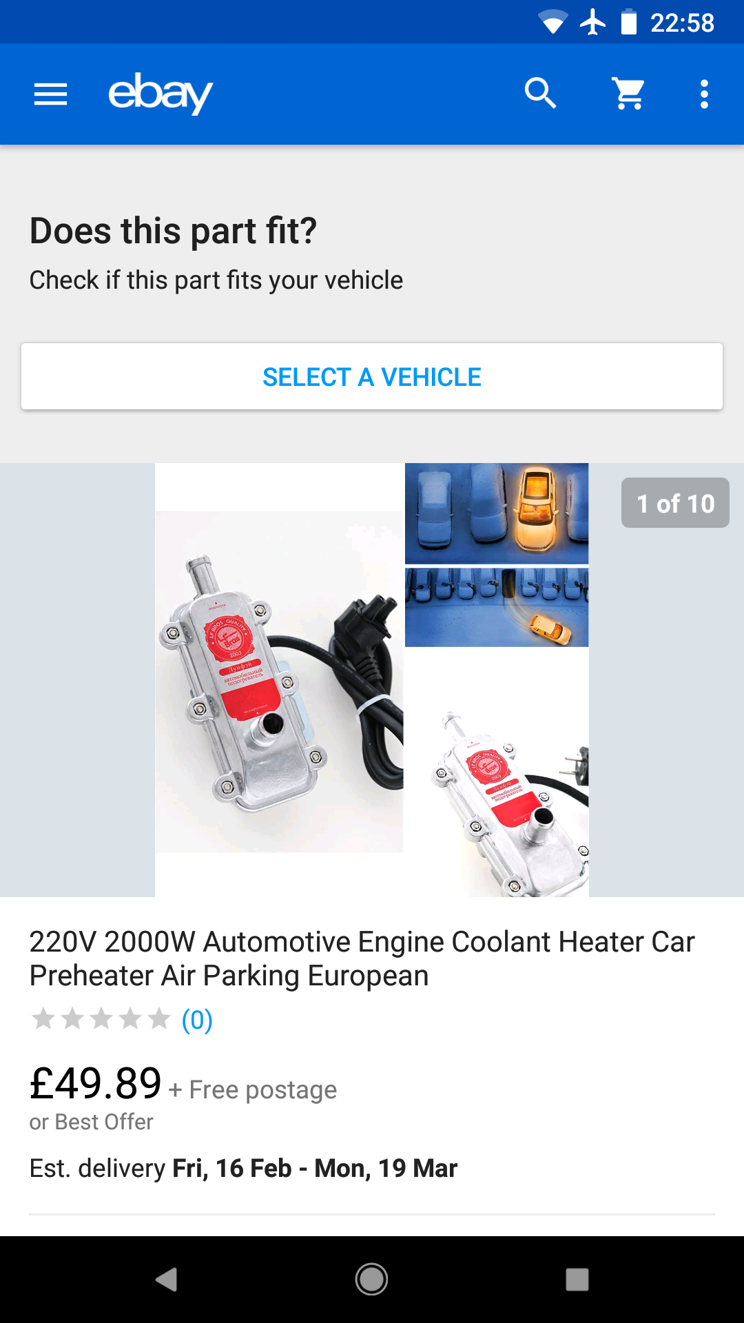

Has anyone tried the cheap electric parking heaters you can get off eBay and the likes? Like the one in the photo
Interesting, Russian text & shipped from China. A lot of heat to get rid of in a small space. I hope the pump is good and reliable? I liked the look of this one too, Being round it seems more the business and the body assembly sealing is circular. Cheaper too and open to offers:

This is the sort of thing I'd be looking to fit, though I may pay a little more for one that comes with a ready cable/connector etc. Would love to hear if anyone has already fitted one of these mains powered coolant heaters and if they had any problems.
