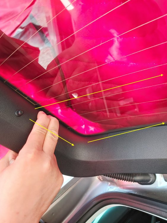

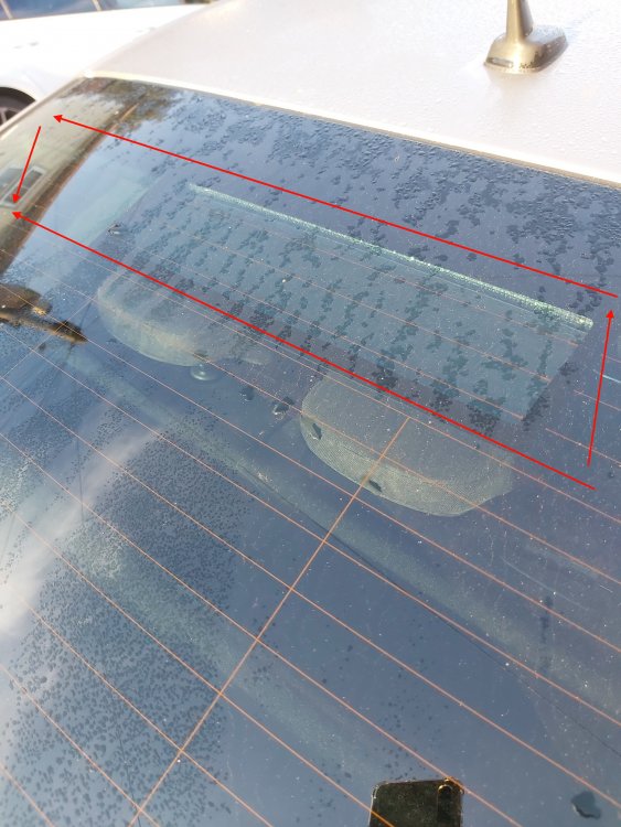

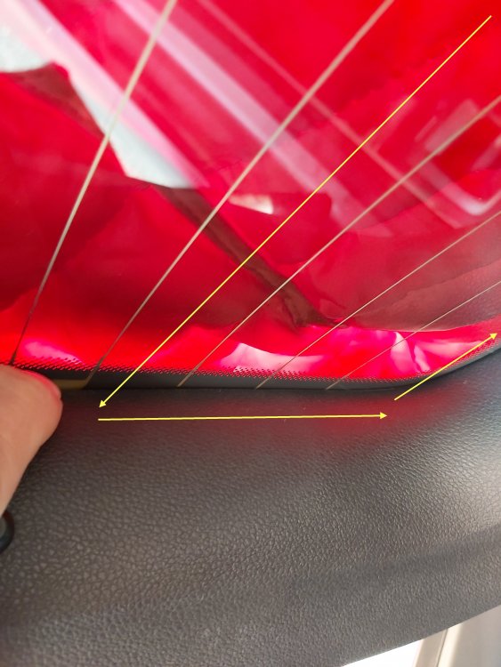

Hello
I have a Skoda Octavia year 2017 facelift.
I hope I am not off topic. Was just trying to figure it out why my demister was not working on the top 3 elements. By reading the comments in here, they are actually radio antenna.
I have put some pictures, can someone who really know confirm that they are part of radio/antenna and not the demister system. Just looking for an answer, because I have a warranty visit booked for this. LOL.
Thank you.
They definitely ARE radio antenna elements.
Look at the lower heater elements - they are joined in the middle by a vertical strip, but the upper ones are not because they are not heater elements.
