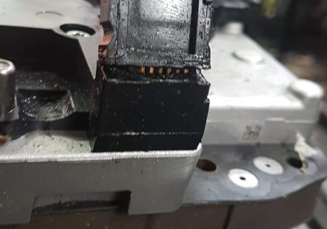

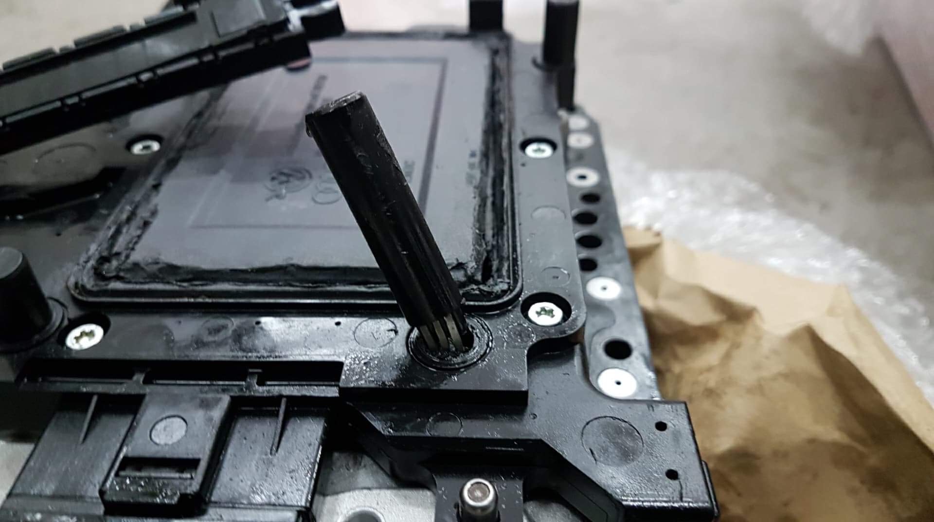

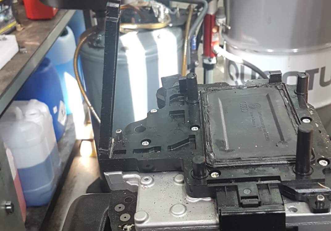

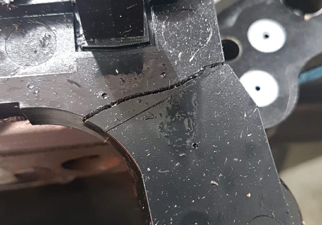

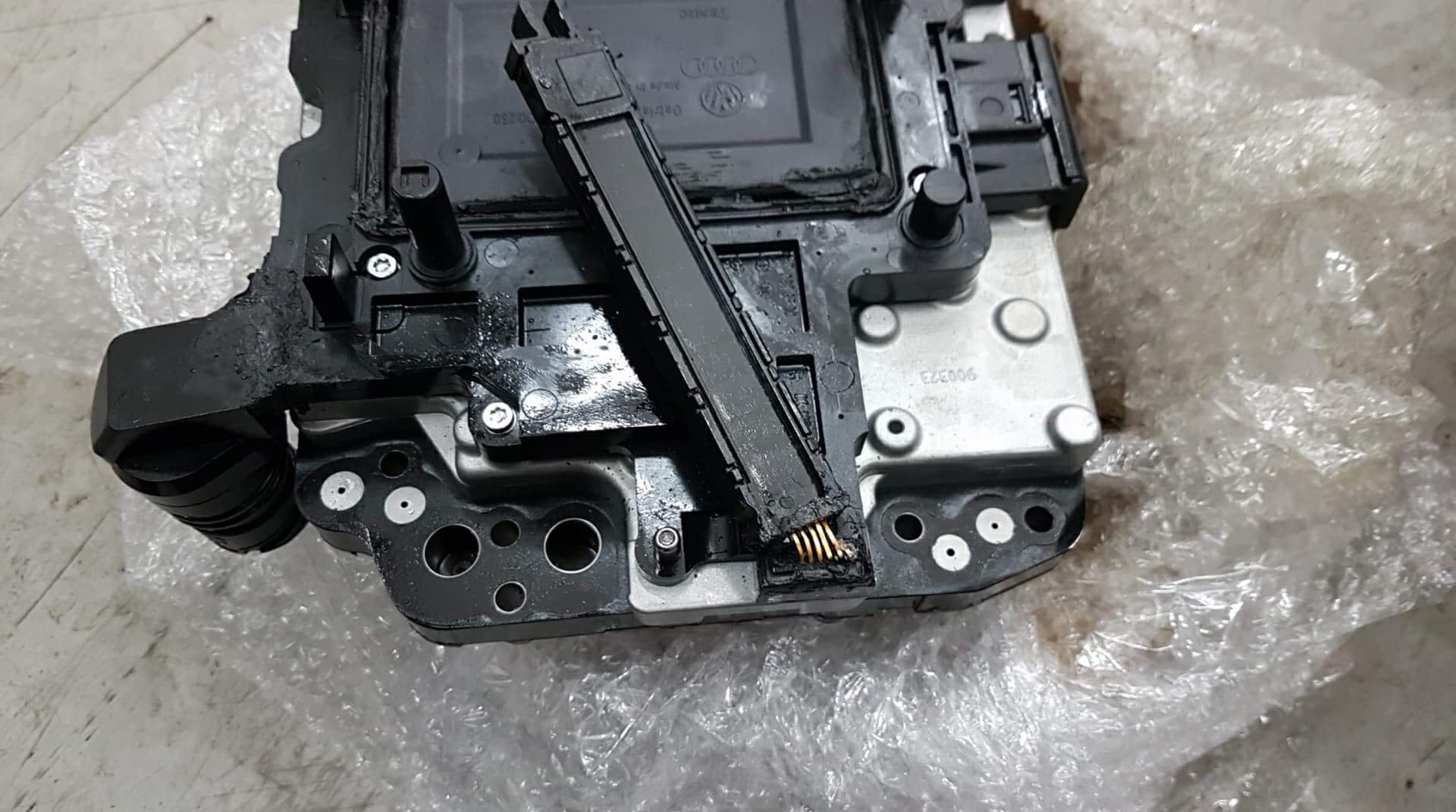

The problem is the Mechatronic has been already sent for recon and has been damaged in postage, the guy who worked on it agreed to pay the costs, not sure if the old mechanik would be suitable for recon, photos attached.
I see what you mean. Certainly worth contacting the guy in the link I posted, as it does say he can supply some full units, or he may even be able to advise on if that is repairable. It looks  like it's jus the plastics that are broken, although would require a complete test sequence to see if there is any wiring faults
