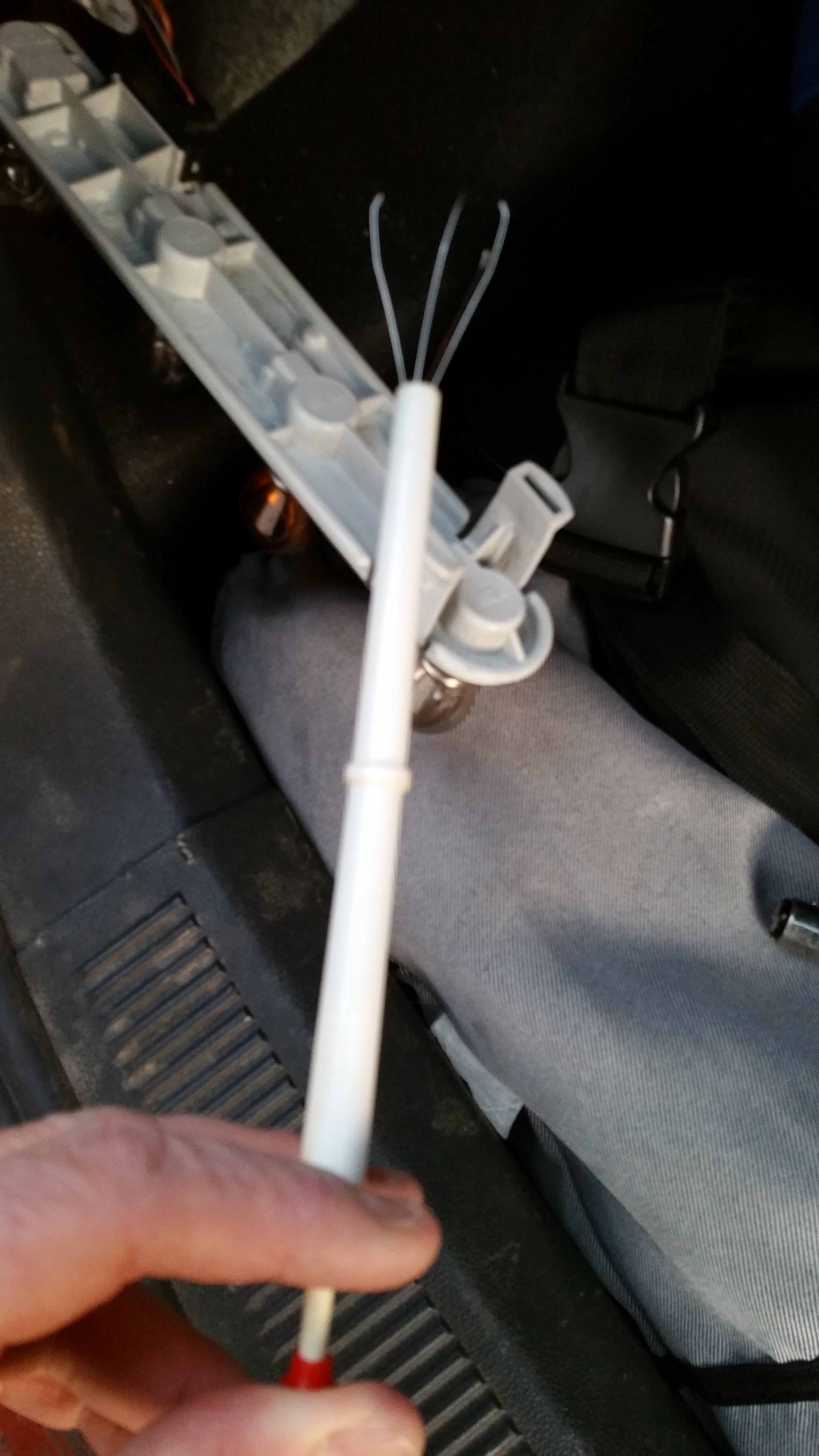

Try a bent coat hanger with blue tack jammed on it.
After that, remove the taillamp, bulb and bits of blu tack from inside :) Sound good in theory but easiest way is just remove lamp. You will need 10mm T socket with extension I think
Lol. I knew the wifes baking utensils would come in handy some day!! This fished it out. The bulb must have been in there a while as all bulbs were present.
