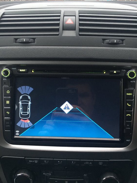

  • Hi Stuart   It does but on a smaller scale to the left of the screen leaving the rest of the screen free for reversing camera display. I do not yet have reversing camera so that part of the
  • Good morning Stuart   yes beeps through speakers are exactly the same as having the factory unit. With the muting of the stereo when you put it in reverse, there are also several options as
