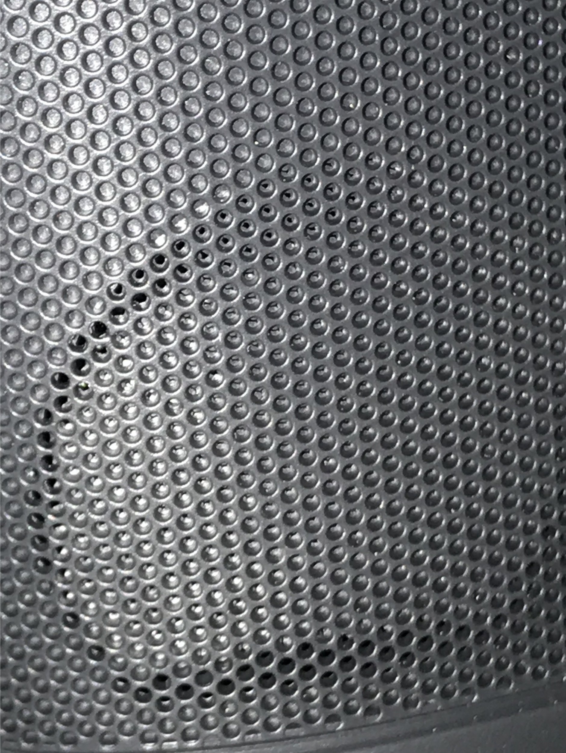

However, I'm still not satisfied with the sound. The tweeter sounds like some frequencies are coming from a vague direction causing some kind of small but annoying distortion. I can't think of any other reason but the speaker grill to cause this issue. Since replacing the grill with custom mounting cups is quite tedious, I'd love to hear if someone has similar experience.

The original tweeter covers:
That's the worst angle against the light. It certainly affects the sound.

Time to get the Dremel out with a small drill bit?
It depends if you want to keep the stealth look or not - custom tweeter mounts would be possible, find a decent ICE installer locally and they should be able to knock you up some.

My Rainbows just improved over time, though I am considering cutting the plastic out from my speaker covers and finding a way to replace with acoustic cloth
If you could extract the grill from the tweeter mount, you could then cut out the section infront of the tweeter, wrap the entire piece in speaker cloth and remount (maybe).
Did something similar on my focus.

I got a new Octavia in March 2019 and this tweeter grille problem is still not fixed.
The sound from the tweeter is horrible even with Match DSP.

If your grille is as bad as mine then drill it’s holes open.
If you are not satisfied yet install Match UP 7DSP which makes some miracles to the sound.
And then if you are still not satisfied upgrade the speakers. There are car model specific speaker sets available which are almost plug’n’play. They fits in original places and connectors.
Forgot to say that just replacing the speakers without adding an amplifier/DSP could cause the sound become even worse. This was the case when I upgraded VW Golf VI’s speakers.
