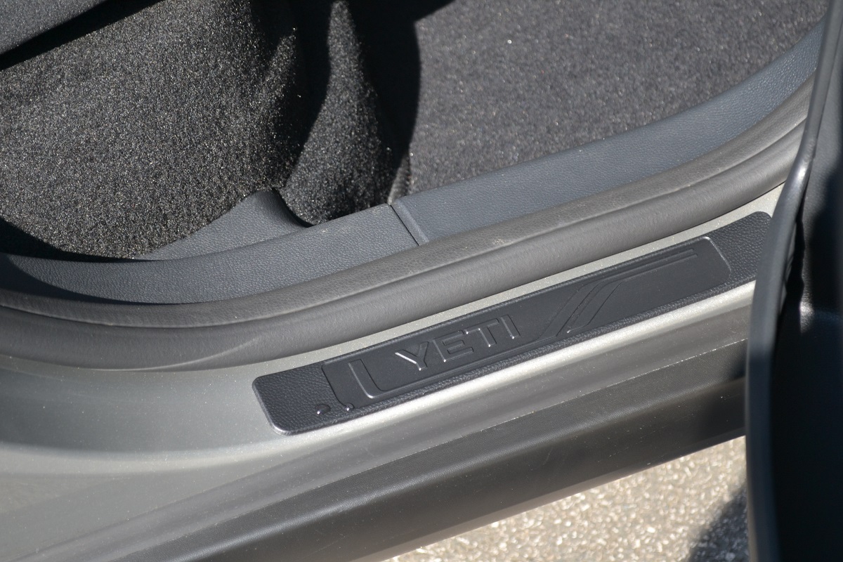

I fitted scuff/ sill plates to my first Yeti. They came with double sided tape fitted so it’s just a mater of pulling the plastic off and sticking in position. You are supposed to use templates to make sure they are in the correct position, but it’s not too hard to work out where they fit and mark with masking tape or similar. Just make sure the area is spotless and go for it, but remember once they stick there is not any chance of relocating, so make sure they are lined up and positioned before placing in position.

+1 Have fitted them to my 3 Yetis.
