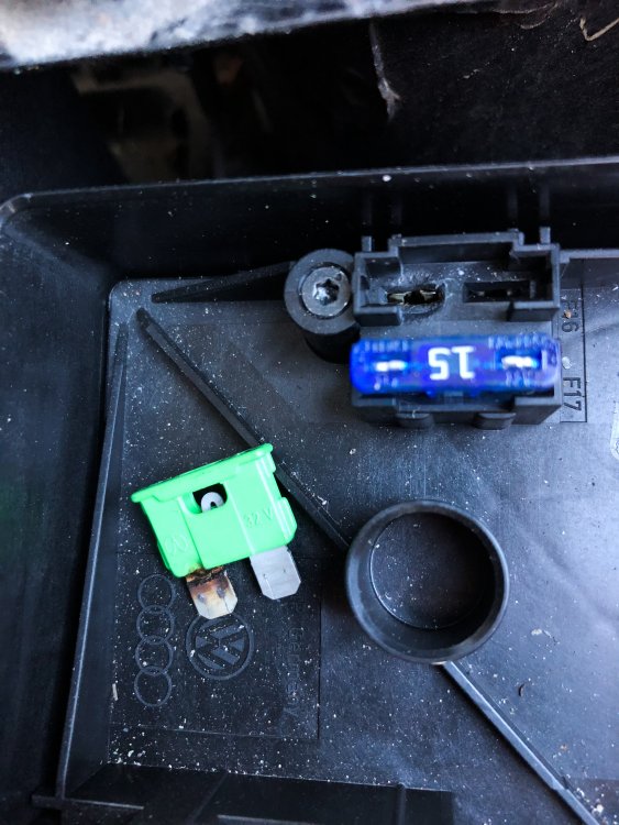

Thank you all for your help. Attached is a photo of a green fuse closest to the windscreen. It looks burnt! Will simply replacing it sort and fix the issue?
It's overheated for a reason, just replacing is likely to result in the same issue and potentially a fire...
Given the plastic fuse box has also melted, I'd be looking to replace it. While it's apart you can get for signs of water ingress or any other faults that may have caused it.
All lights seem to work fine now... I did have LED side lights that didn’t have canbus so the “change lightbulb” dash light was on constantly, I have since changed back to halogens side lights since the problems started. They possibly could have been the problem? I will keep a close eye on the new fuse.
This issue is caused by faulty parts at manufacture and was common on MK2 models. Providing you have cleaned up the socket in the fuse box you should be OK the overheating was caused by the original corosion creating a restive connection and therefore heat. After I fixed mine I had no more issues. Glad it was the same problem and we found it, though I would have thought your first two automotive electritions should have found it :o
Give it a couple of weeks and check the blades on the fuse, if they look OK then you should be OK :biggrin:
John
I’m glad you’ve all helped me diagnose the problem! How would you suggest cleaning the socket? I guess it’s just a waiting game :)
a small dab of vasalene is good to stop any more corosion, a very small rat tail file can clean up the contact and then insure that the "socket" bit grips the fuse tight by bending it in a bit if needed.
