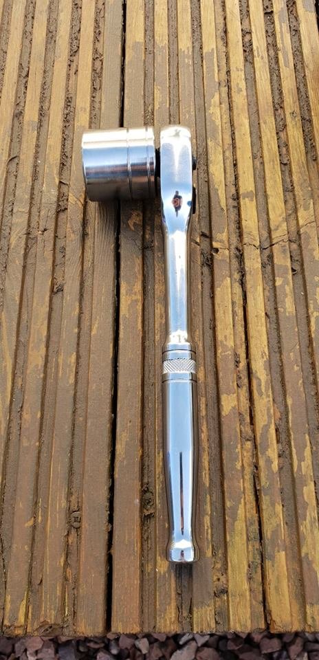

Tools needed;
Ramps or jack with axle stands
32mm socket
Sump removal piece (eBay link) - Flathead screwdriver may also do the trick

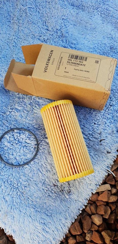

New oil filter and O ring (Part number: 06L 115 562)

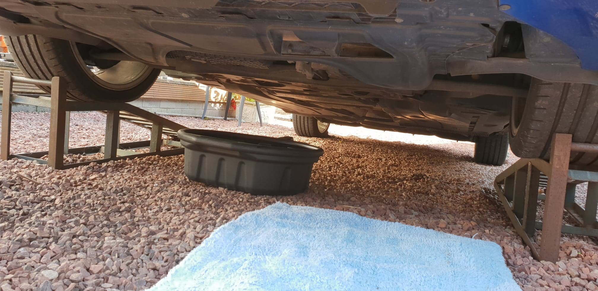

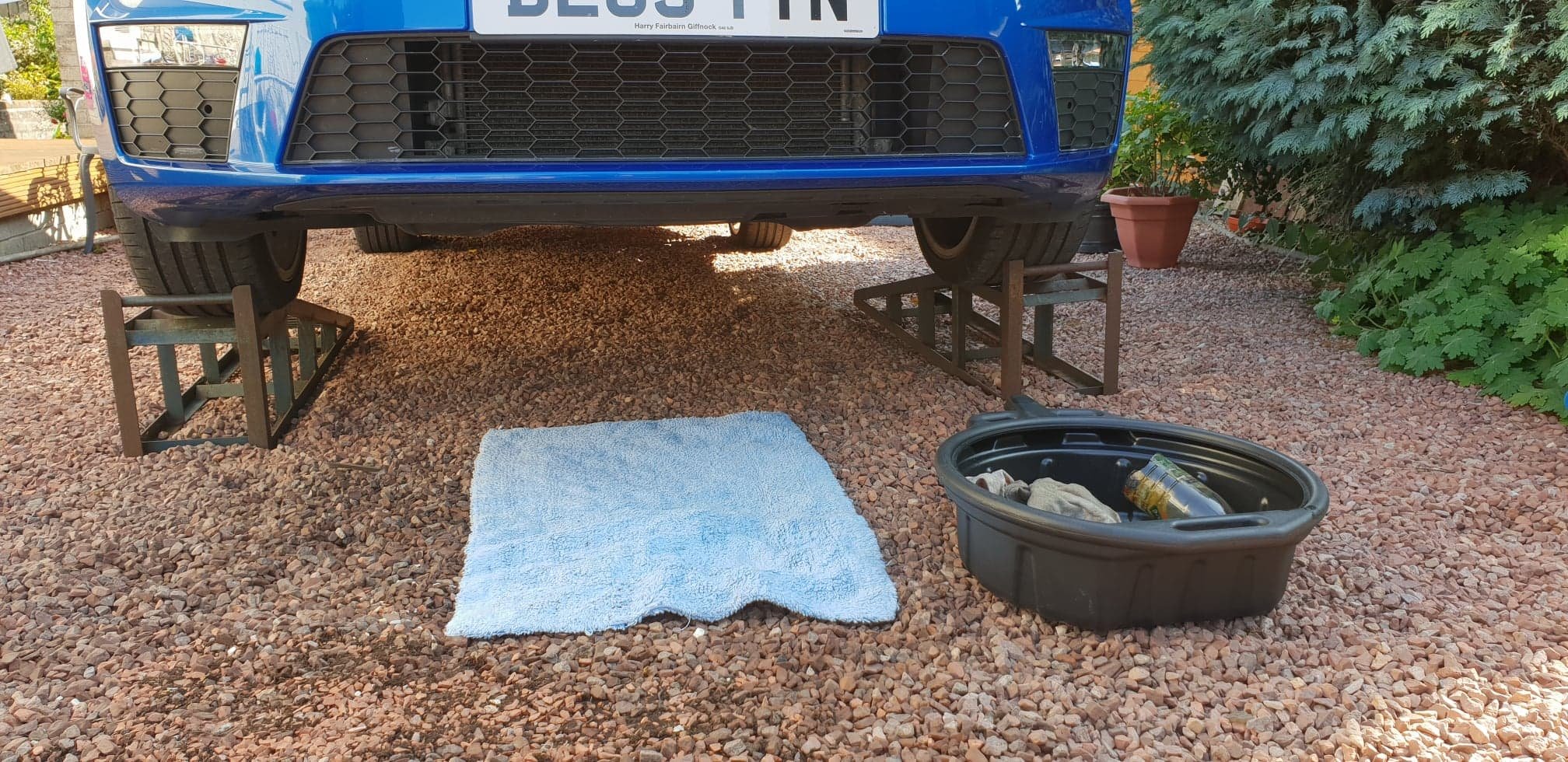

First off, jack the car up or get it onto ramps and secure with bricks or stoppers at the back wheels.  I let my car cool down for a short while so I don't end up burning myself..

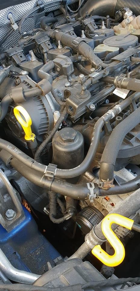

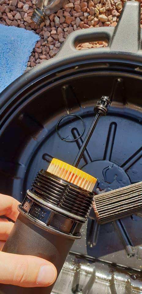

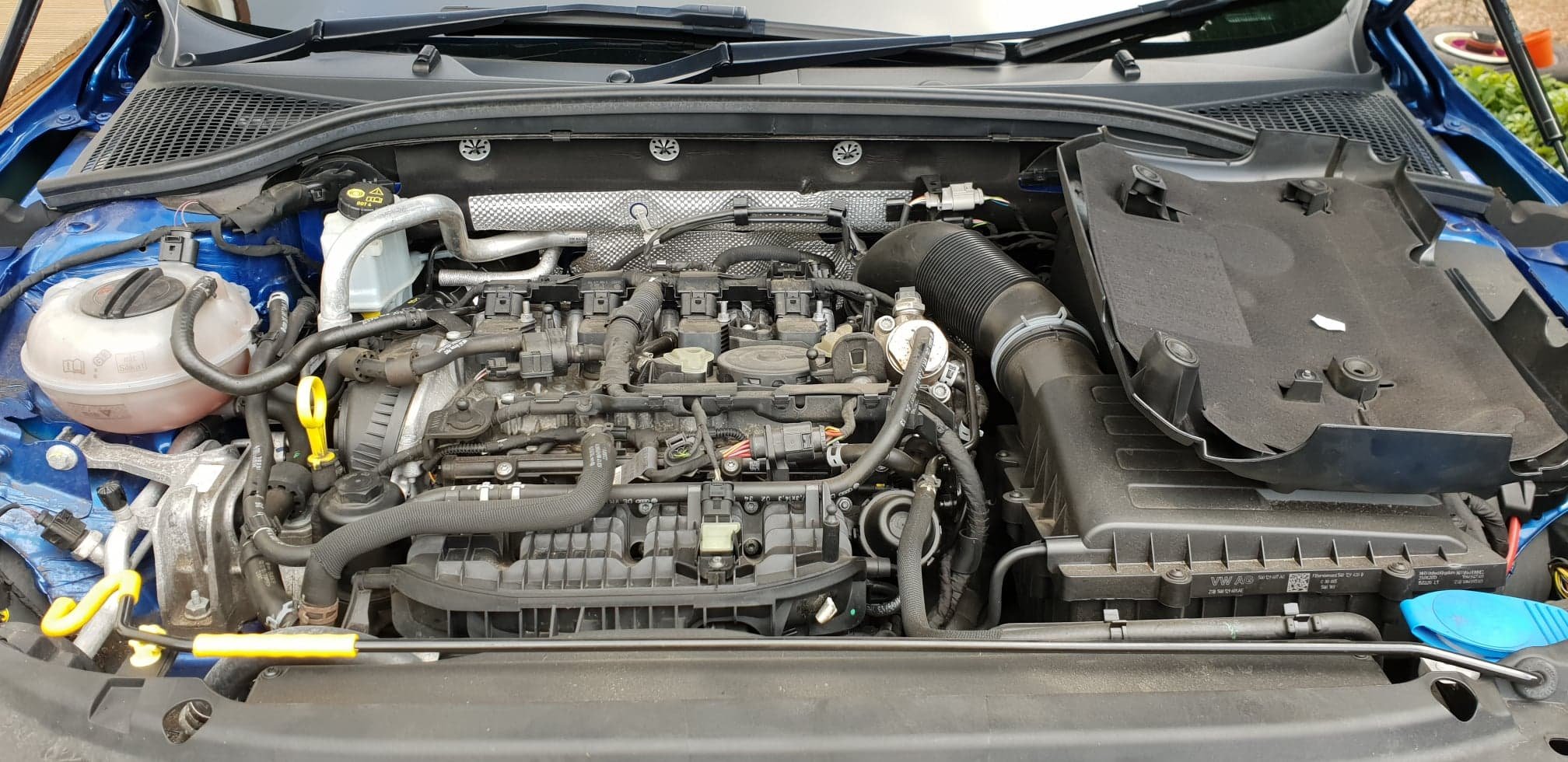

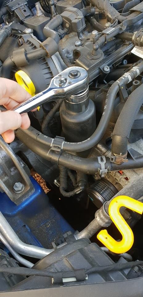

Open the bonnet, remove the engine cover and use the 32mm socket to remove the oil filter housing. Be careful and have a rag ready to catch any oil dropping from the filter.
40448941_1068662636636263_2471134559312281600_n.thumb.jpg.620614288babeed8efe728b9b0dc6dc0.jpg
40363722_534302043650609_961871145848537088_n.thumb.jpg.4f4aaede325f399291da9397014376bb.jpg
40411118_280406465897624_5043570410541547520_n.thumb.jpg.e7af7800da3b9a8d840037ec048ed949.jpg
40311494_295788804539946_1164605048307580928_n.thumb.jpg.d7e020e0e7a65761b576e534174ea077.jpg

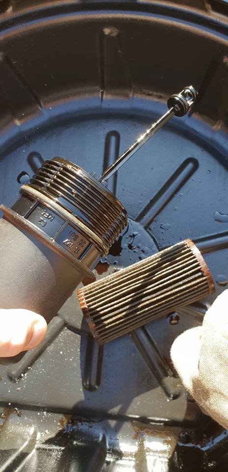

Move over to your catch can and remove the filter simply by pulling. Remove the old O ring from around the housing (I used a flathead to prize it off)
40374074_982064545298344_2138110281308438528_n.thumb.jpg.80b64c92d7bb25411ed2460dab87b9b2.jpg
Put your new O ring on and slide the new filter inside. Place back inside and tighten with the 32mm socket.

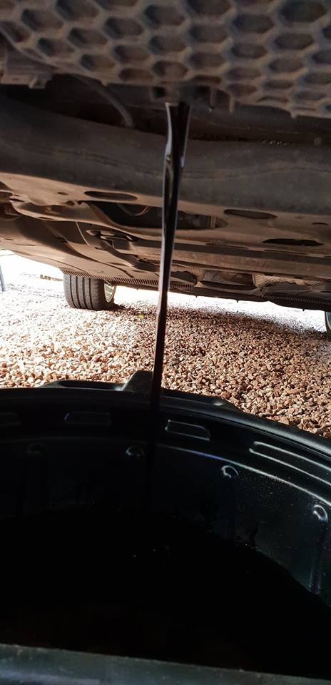

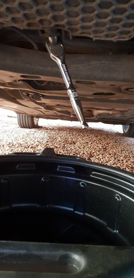

Undo the oil filler cap on the engine and place your catch can below the car where the oil will come out from. Undo the sump plug, let it fall into your pan and wait for it to drain (I allowed 1 hour).
40410426_981640248690099_7854795010225471488_n.thumb.jpg.3f349ca601d31b5f8c6bfe560bdb8081.jpg
Sump plug
40313564_242934929638450_6260230488246452224_n.thumb.jpg.868736cb507e749b1141d06cd36cdb7d.jpg
Removal piece
40318667_2132222313477701_224850346923524096_n.thumb.jpg.2a10d49d0c51fb545c05743deb250881.jpg
40304166_307489663359373_688515950839857152_n.thumb.jpg.c7edce79b871aa2c4ea8c274c65095bc.jpg
40361854_2042242189159782_8852801081734856704_n.thumb.jpg.f9e83a23dcc1e78ca3eb355507af1a48.jpg
One the dripping has stopped or is at a minimum, wipe clear any oil around the plug area and pop your new sump plug in. It'll lock in place once it's screwed in (it isn't designed to keep turning until tight). Again, wipe away any oil left over.

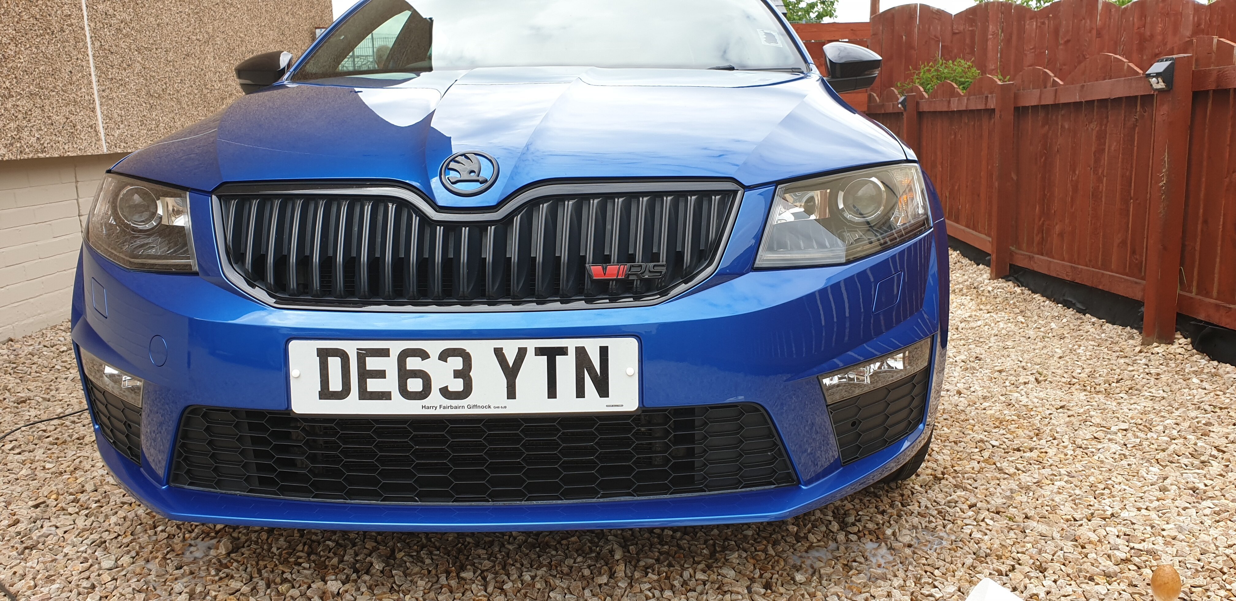

The bug has slowly returned, so done a bit of shopping on Super Skoda! Got some wind deflectors, coloured Skoda badges and the new style VRS logo with the red inlay and black RS. Will debadge the letters on the back (maybe later replace with black lettering) Looking forward to getting those on and tidying her up a bit.. Booked in to have some body repairs done and will get the exhaust tips finished in gloss black!

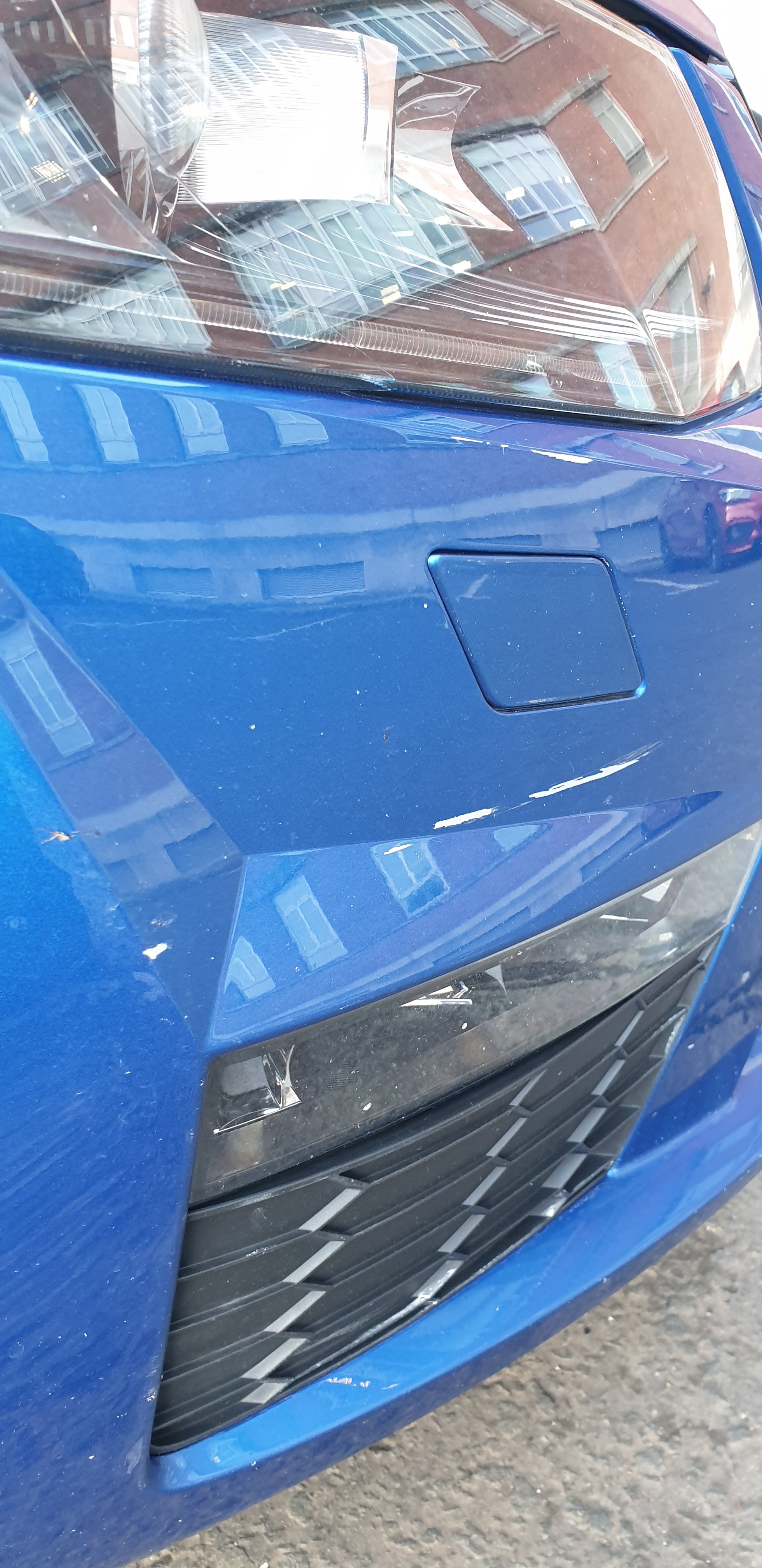

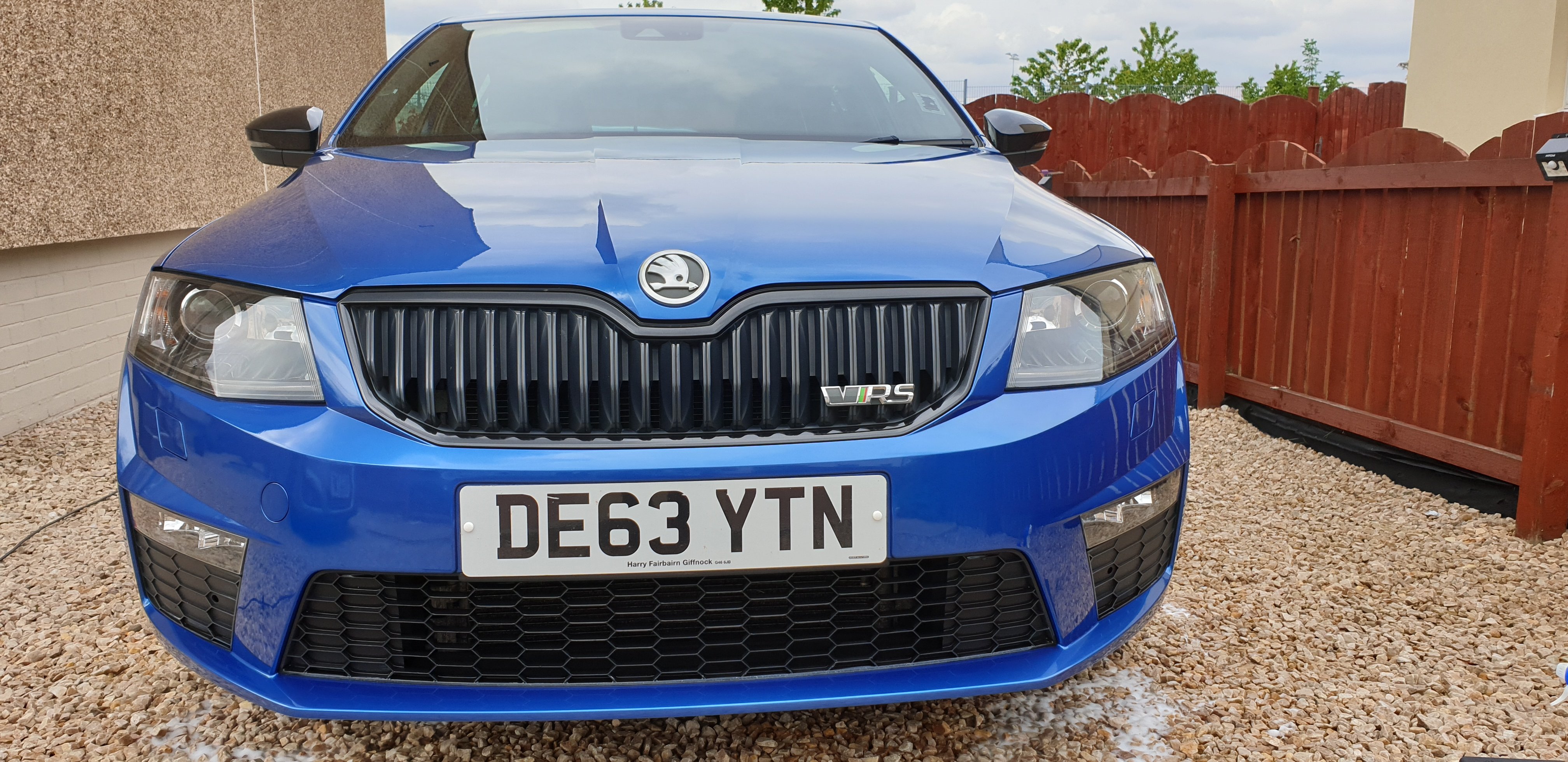

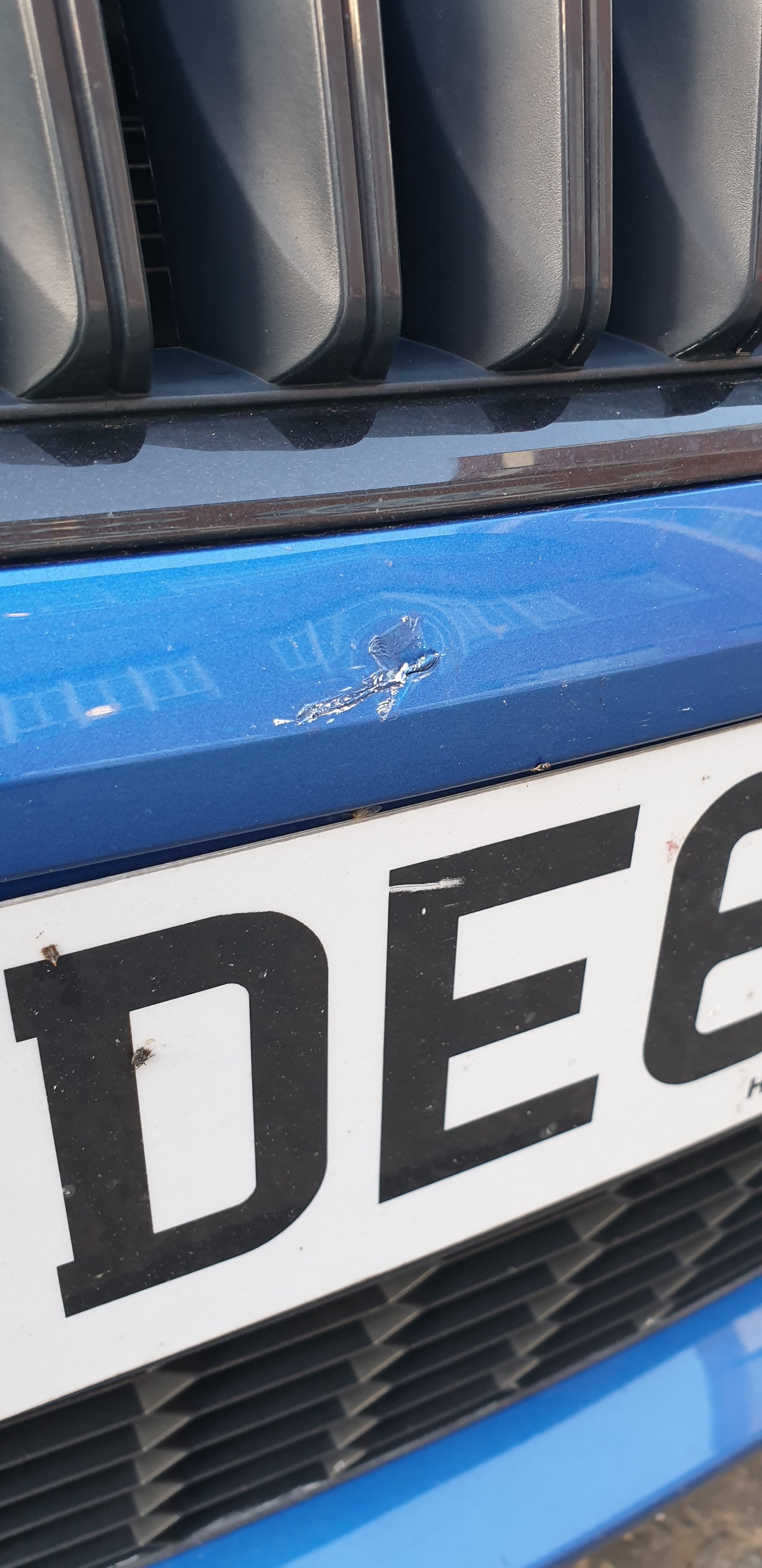

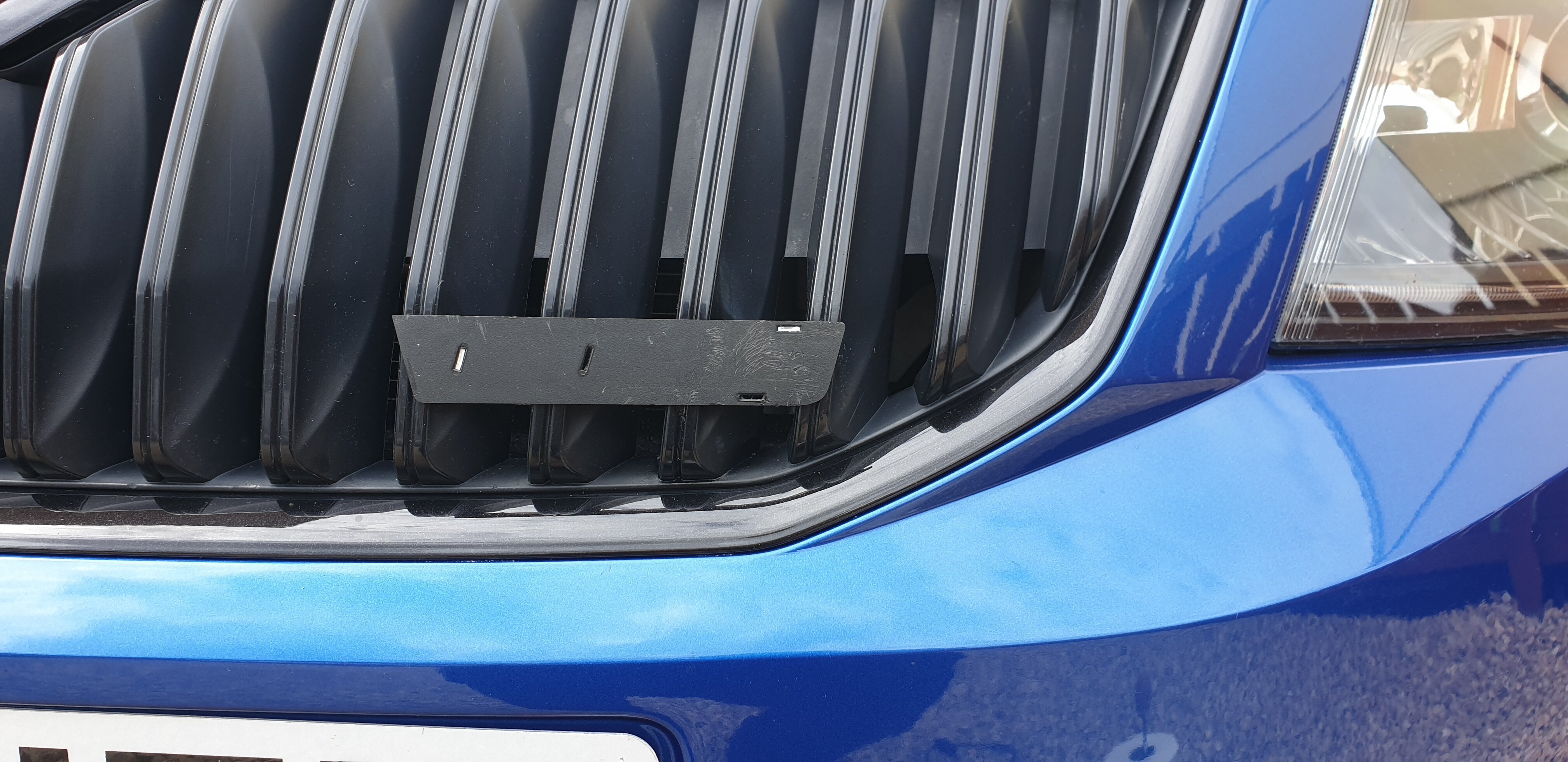

The front bumper has been in a bit of a sorry state since I'd bought it but didn't want to fix it up until I ran it for a while to make sure all was well.  Had a chunk missing above the number plate, marks from being swiped by someone reversing and multiple stone chips.. All repaired as if brand new thanks to Touch Ups in Glasgow.  Highly recommended.
One thing that's bugging me now is how the bumper is swirl-free but the rest of the car is covered in them... Think it's time to get my hands on a DA polisher :)
Some pics of before;
Pic of after repair;

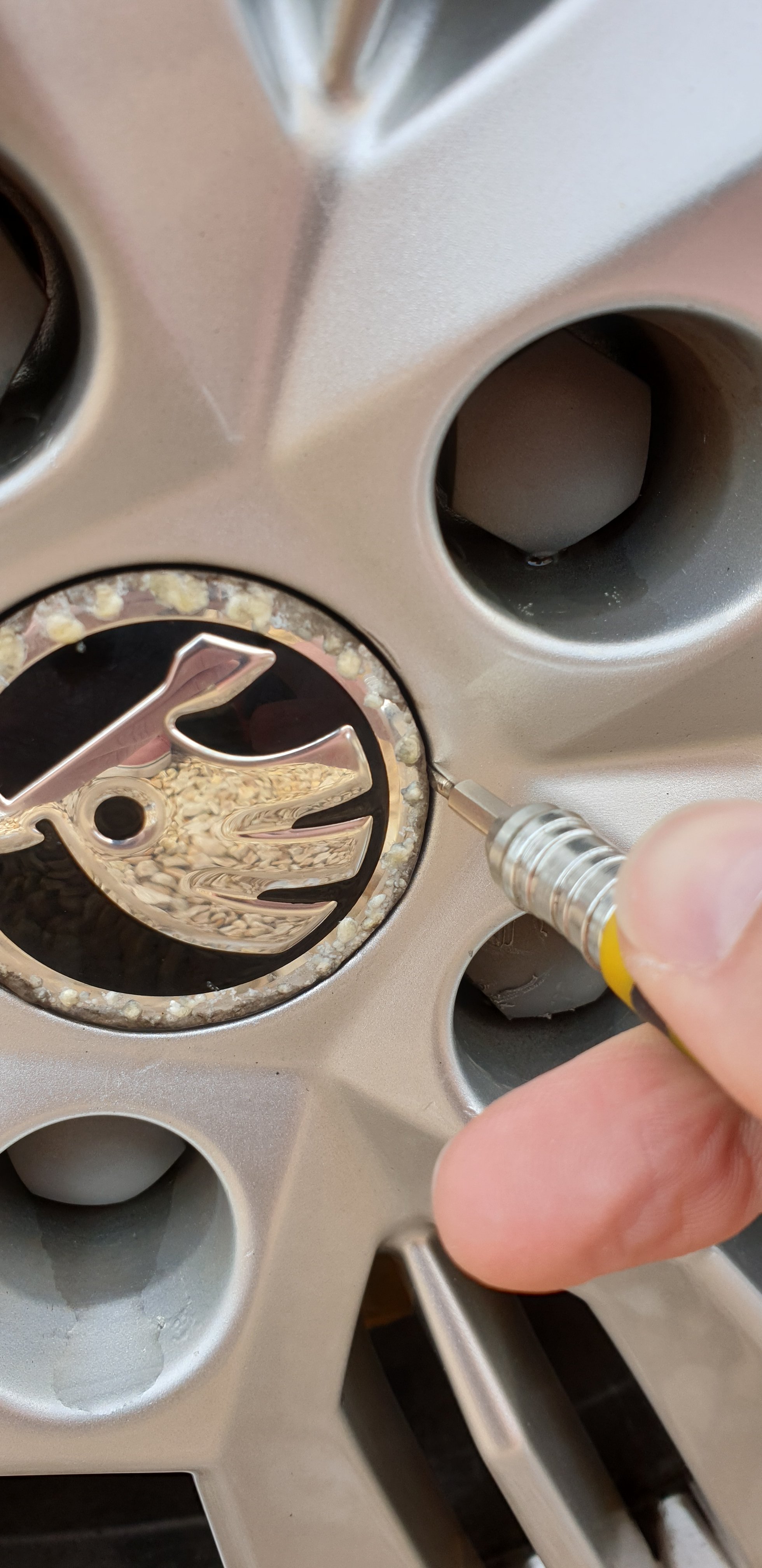

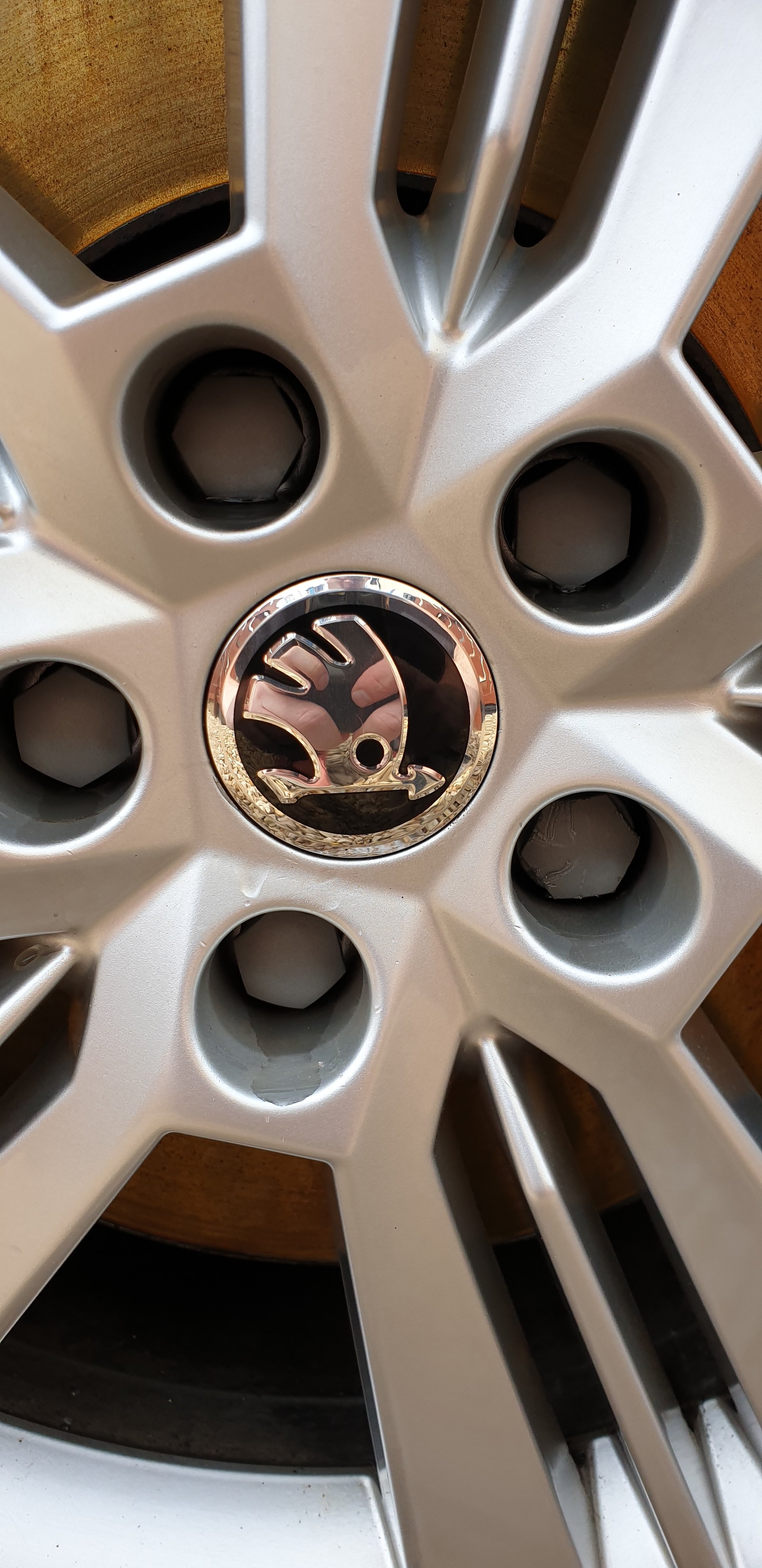

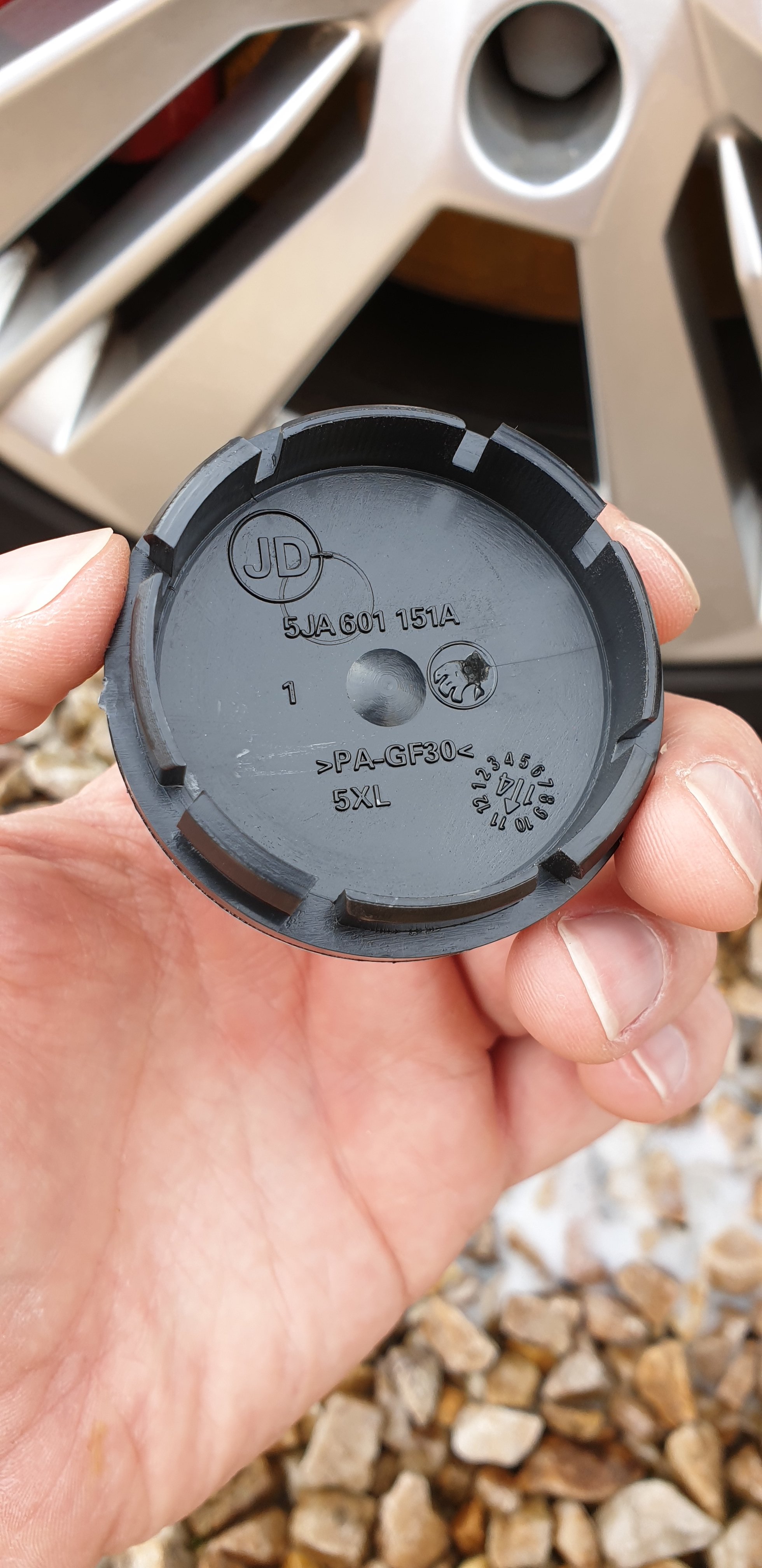

Made a start on fitting some parts (only small) that arrived on my days off.  Started with replacing the wheel center caps as they'd corroded (think this is a common VAG problem).  I'd ordered 4 assuming they were sold individually but turns out they sent 4 packs with 4 caps in each... At least I'm covered for a little while if they do start to peel away again! :laugh:
20190509_133556.thumb.jpg.20482785c864030f1d25aaf93afdca3d.jpg20190509_133703.thumb.jpg.086db4d43f6942a77760fdb8e7dc6f29.jpg20190509_133724.thumb.jpg.d31b5bca538d8d3ac5d032d51351ed1a.jpg

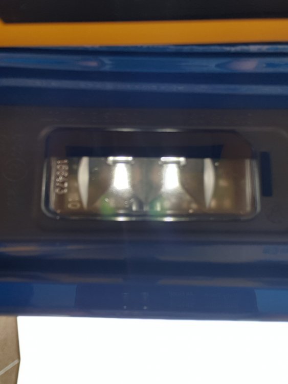

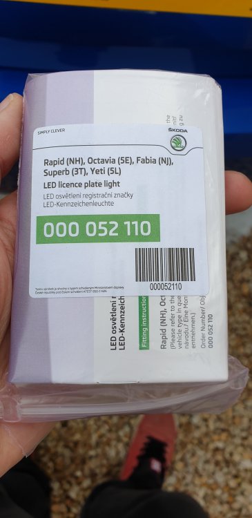

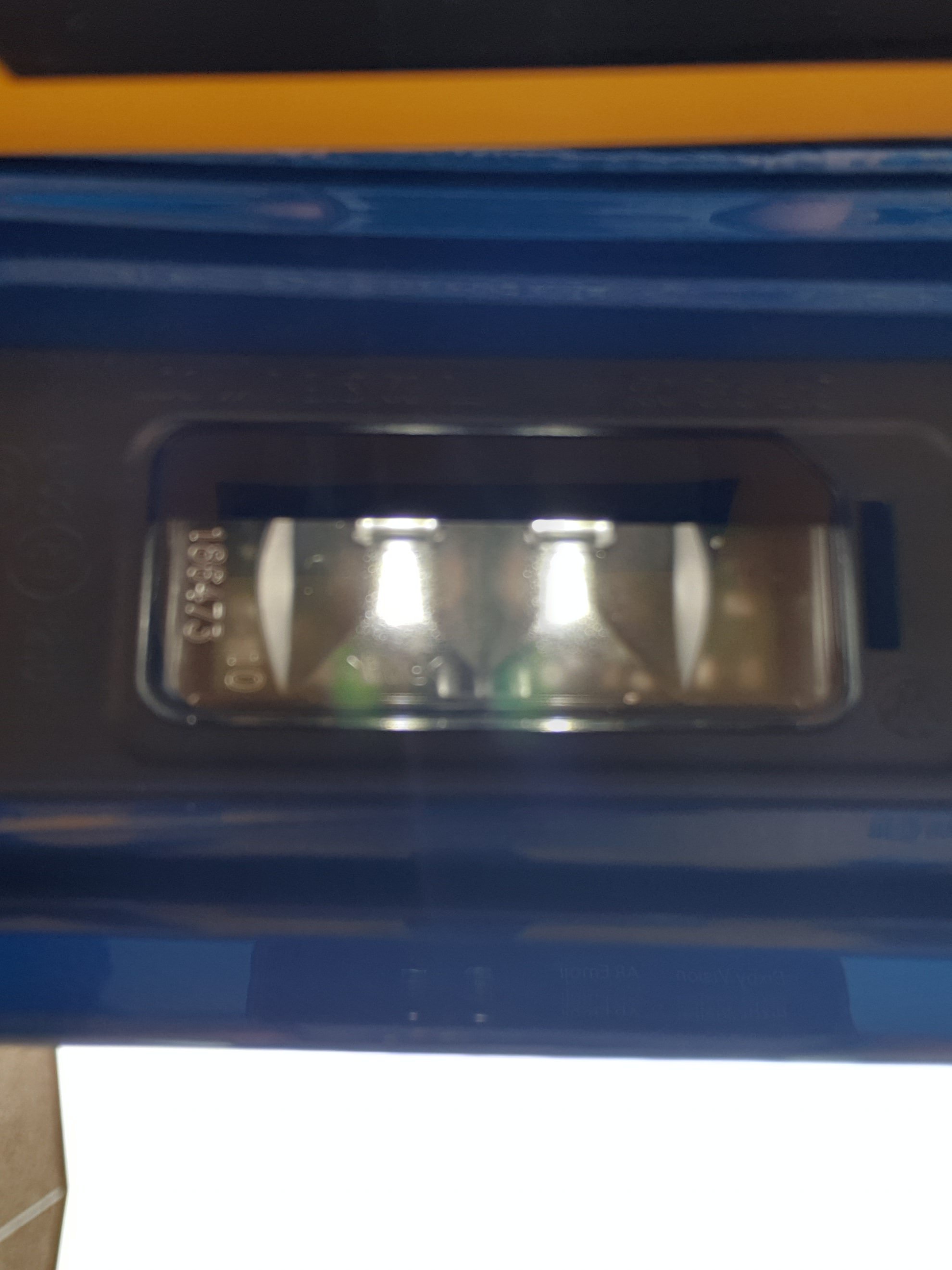

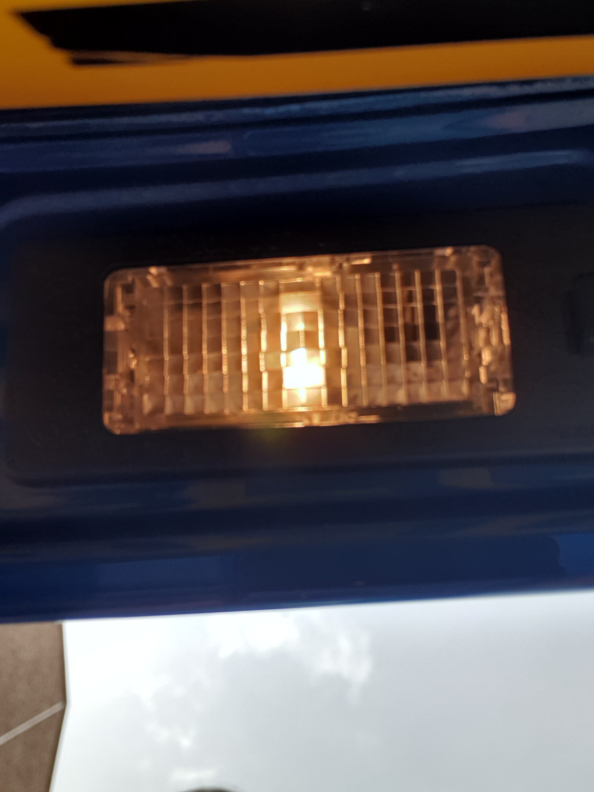

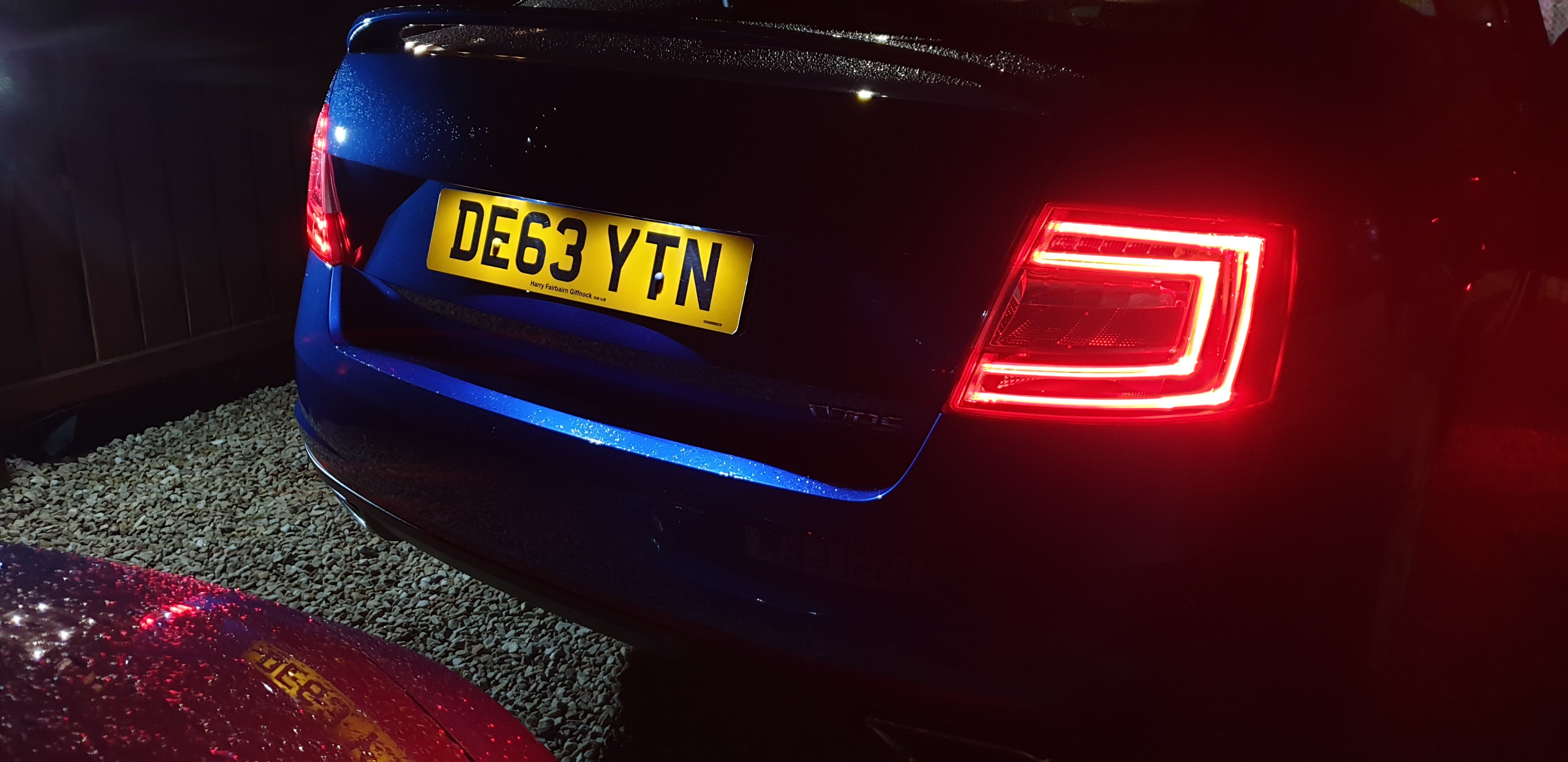

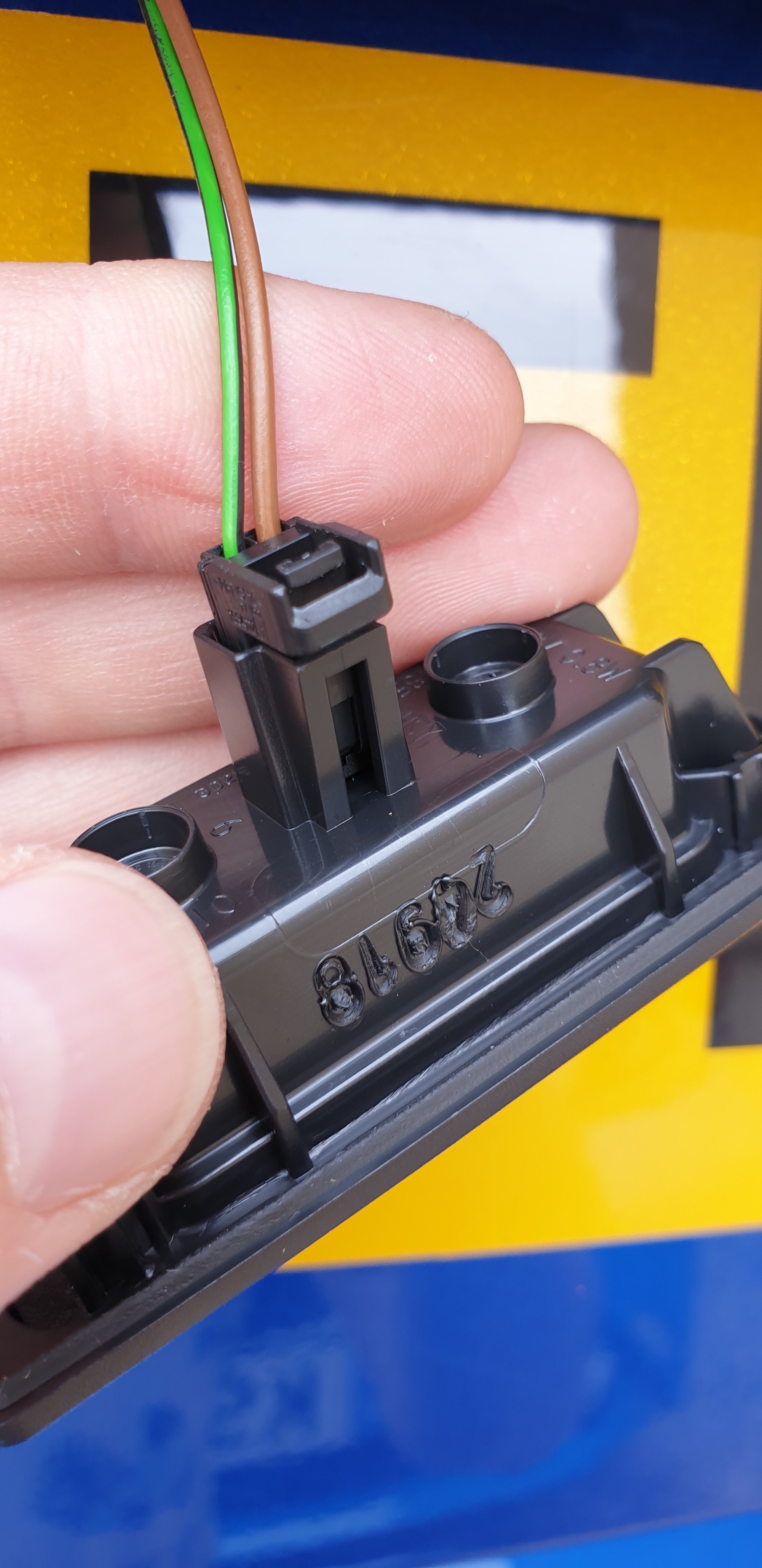

After a bit of reading up about what to replace the number plate lights with, found it was recommended somewhere on here to use the Skoda part that comes with the Rapid.  Be careful when ordering these as I'd paid around £20 from one site for them to only send one of the lights.  I later found another website that sold the exact same part for £5.  Can confirm these need coding- the error will only appear when the lights come on but they still work.
20190509_134250.thumb.jpg.d7b75e8a7e9b1c11b9868f41dc7a78cc.jpg20190509_134530.thumb.jpg.d010b9f3df98ce3810b65611df22b5f7.jpg
20190509_134619.thumb.jpg.3a962759c01620d92928878e1a76d9d3.jpg20190509_134615.thumb.jpg.2d1d04361ad3065db53eb537b73ea089.jpg

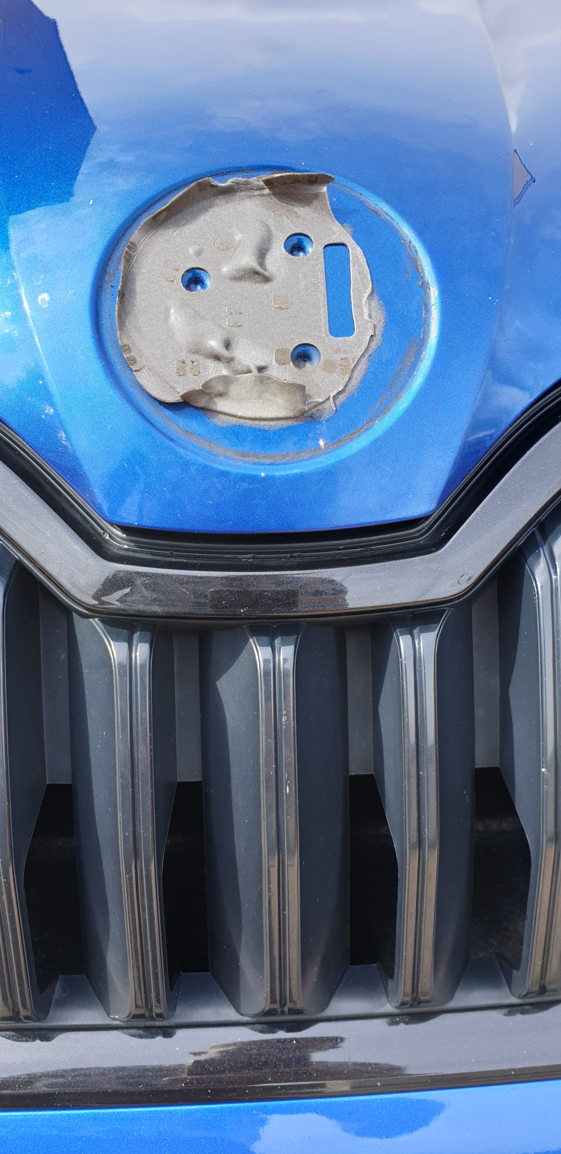

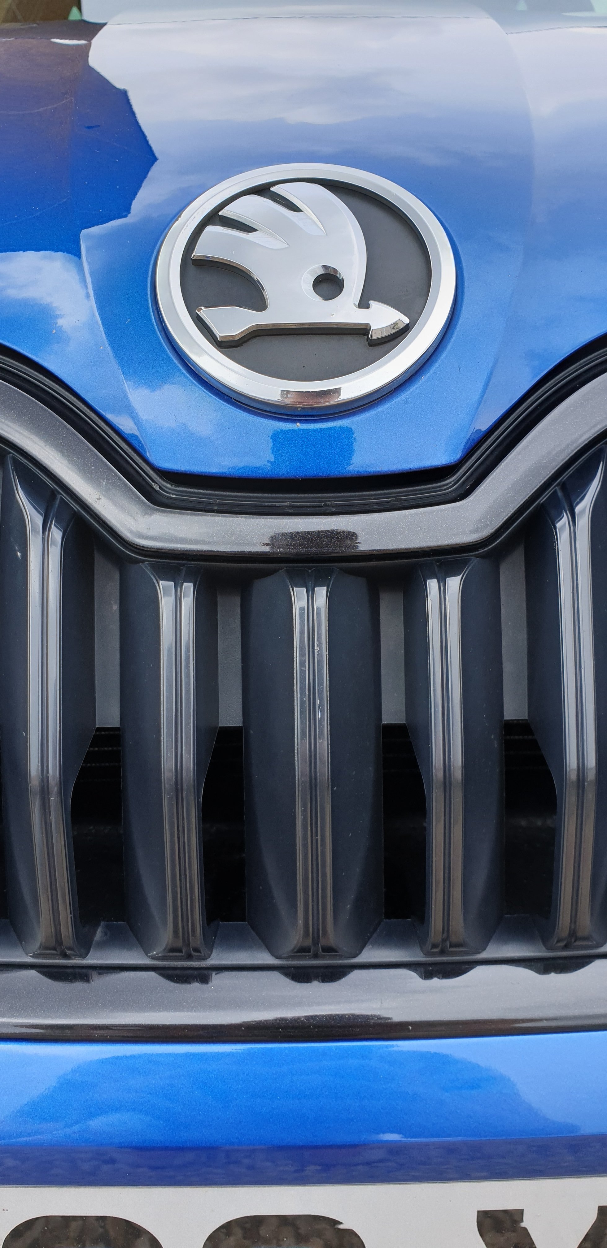

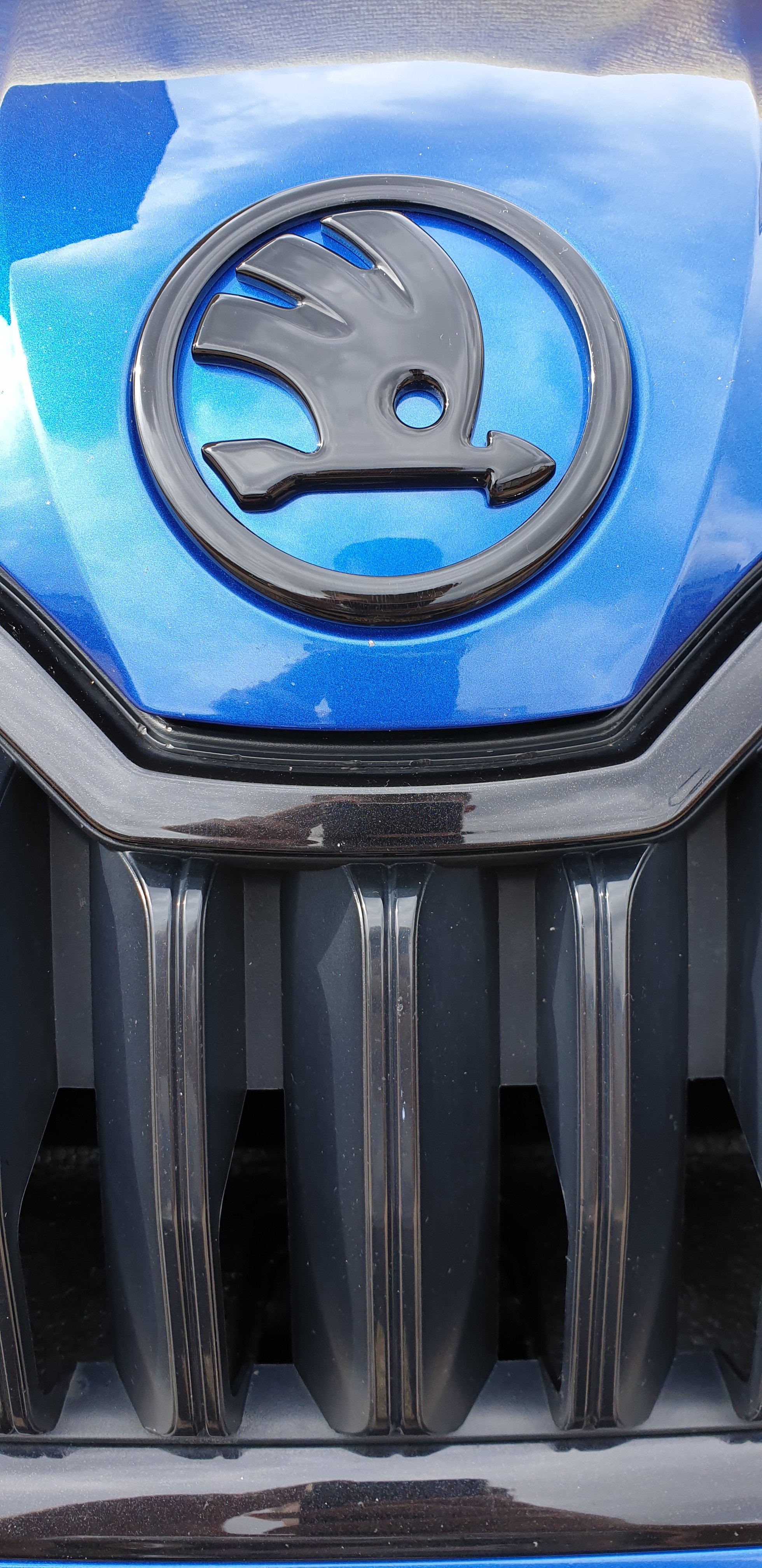

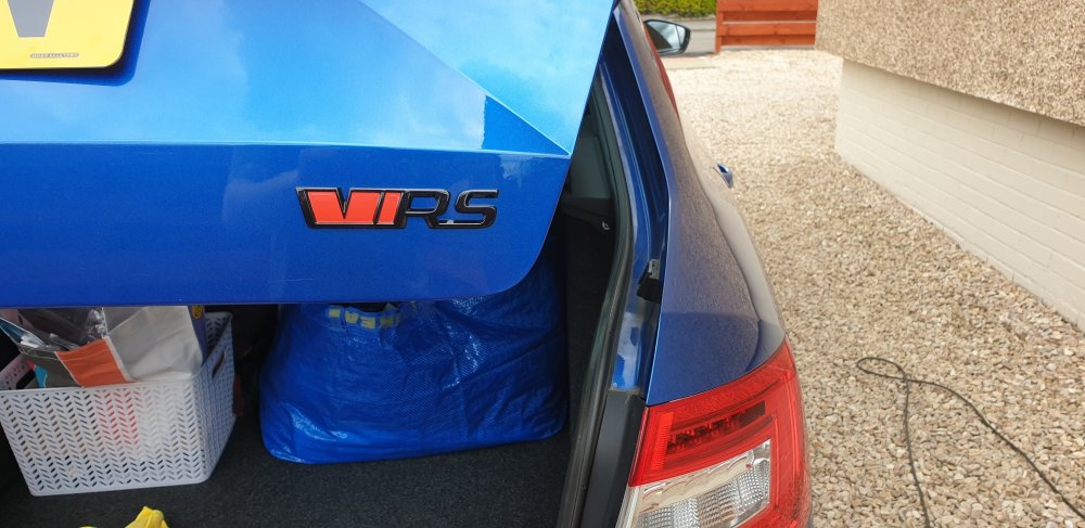

Got myself some coloured Skoda badges from SuperSkoda (Race Blue/F5W).  To save any confusion, both the front and rear badges are the exact same size.

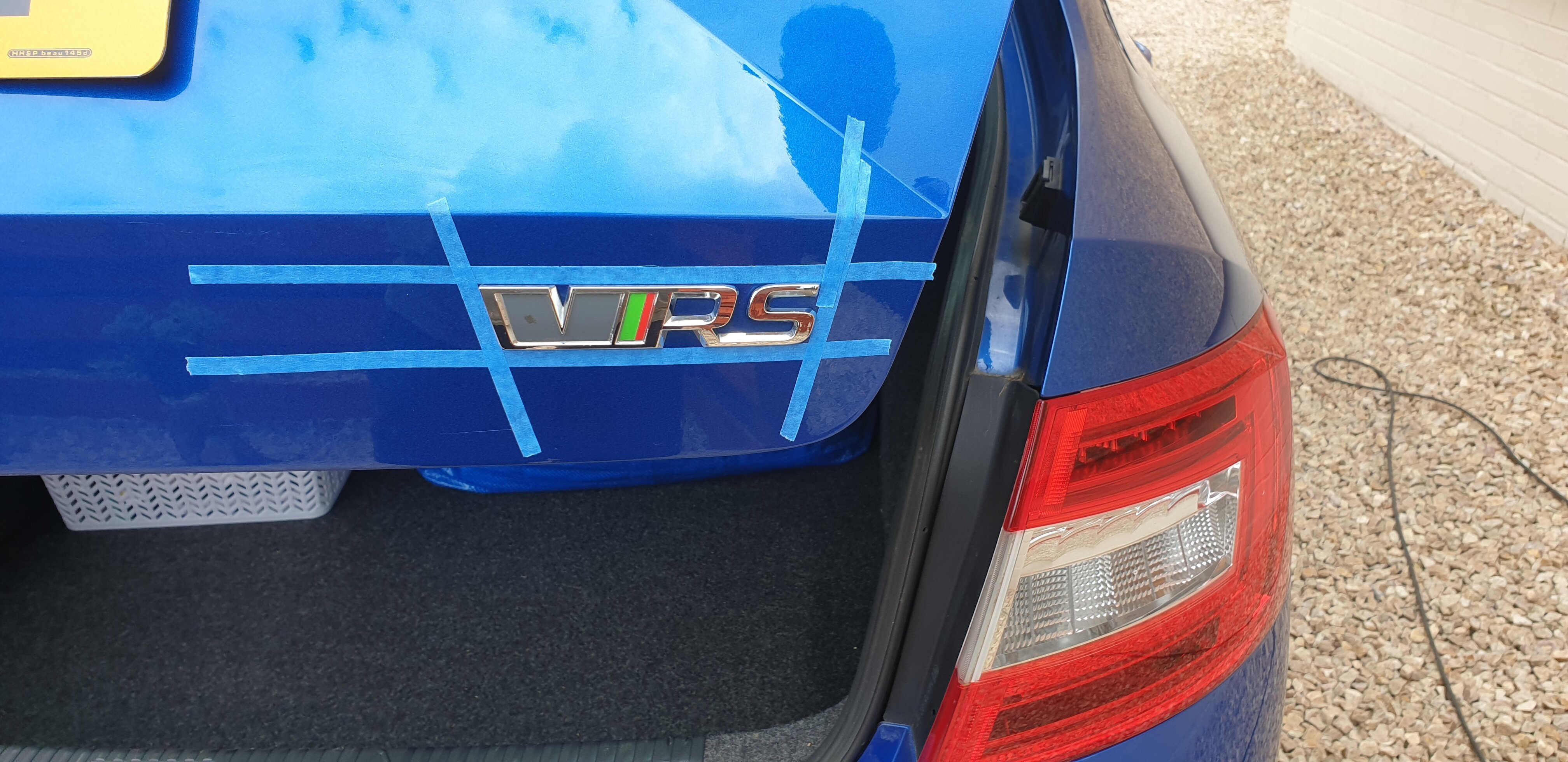

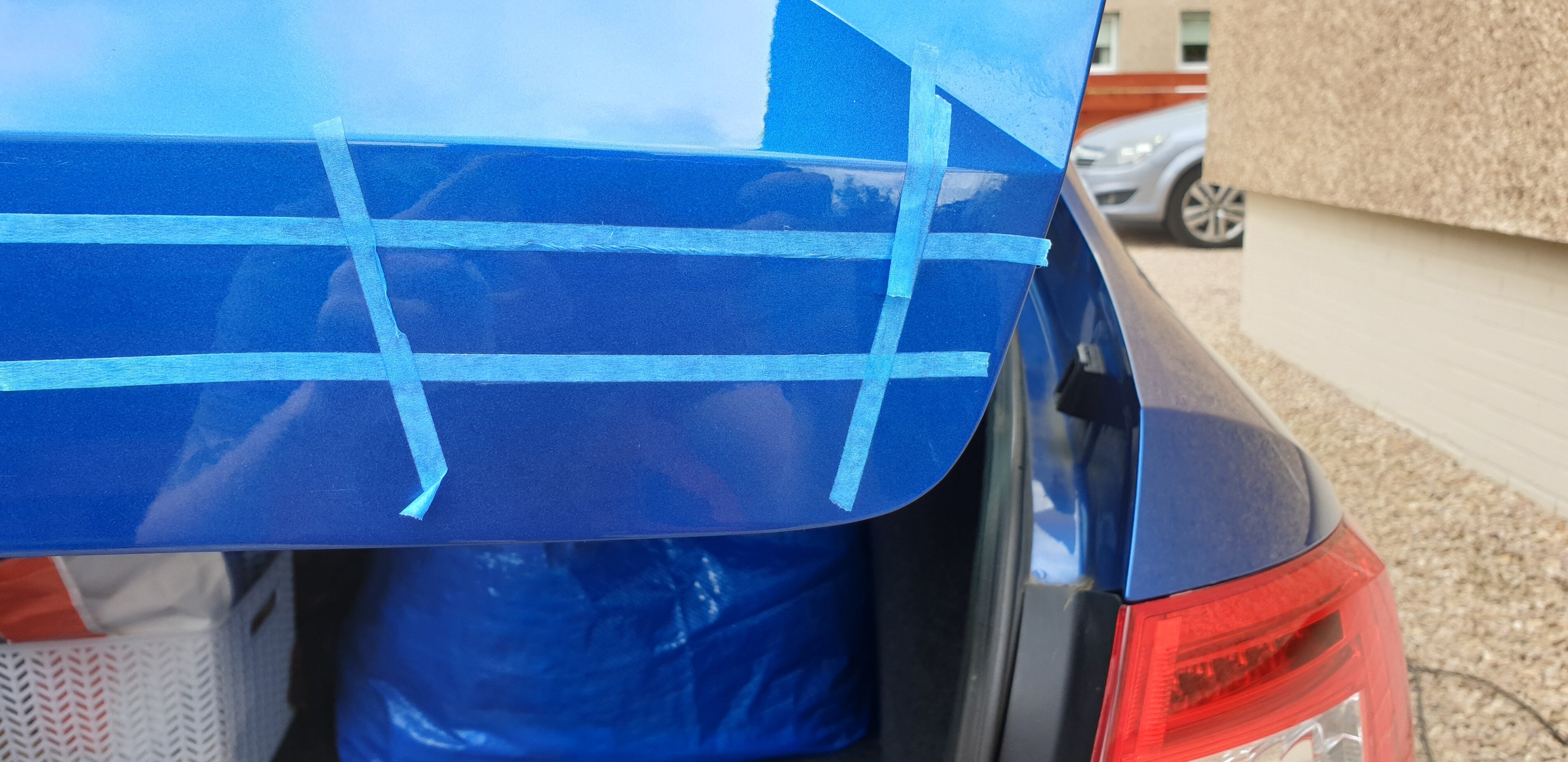

If you've never removed badges from a car before, it's pretty simple.  Heat up the badge with a hair dryer to soften the glue behind (don't hold it too close or in the same spot for too long), use tooth floss in a saw-like motion to start cutting through the glue.  Repeat the process all around the badge until you need to slowly peel the rest off where the locating dimples sit.  Clean the left over glue off (I used Sticky Stuff Remover from Halfrauds), clean it up with a surface cleaner so the new badge will stick well and pop it on.
20190509_135313.thumb.jpg.de4f6e08c121e83b2b2c5036f673717b.jpg20190509_151044.thumb.jpg.cd579da213ad963af6c544af35f552f9.jpg
20190509_143358.thumb.jpg.ce781a9a647d3542e8a844f7383956fc.jpg20190509_150426.thumb.jpg.761744f499330be8daa159da449e9899.jpg

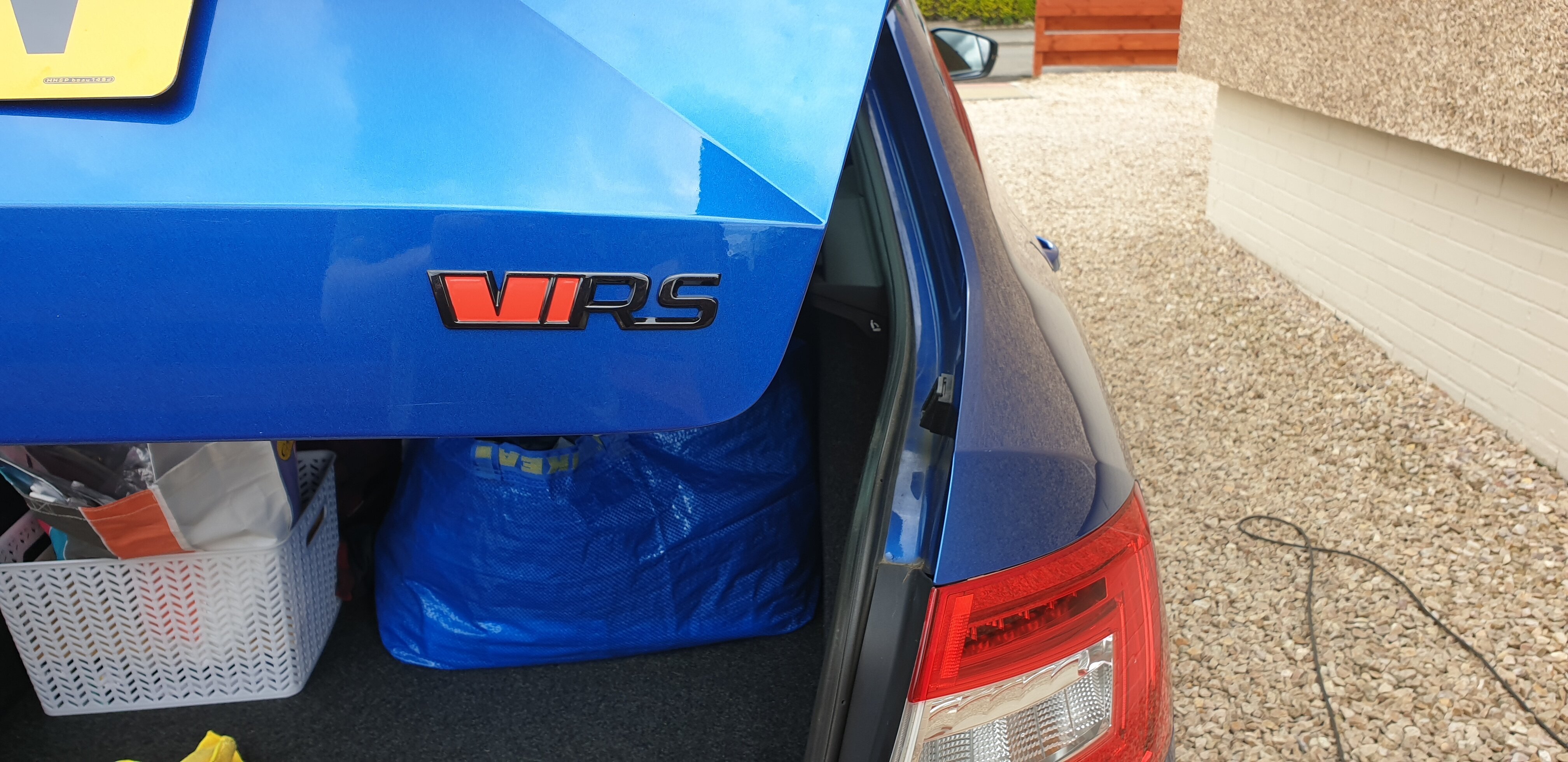

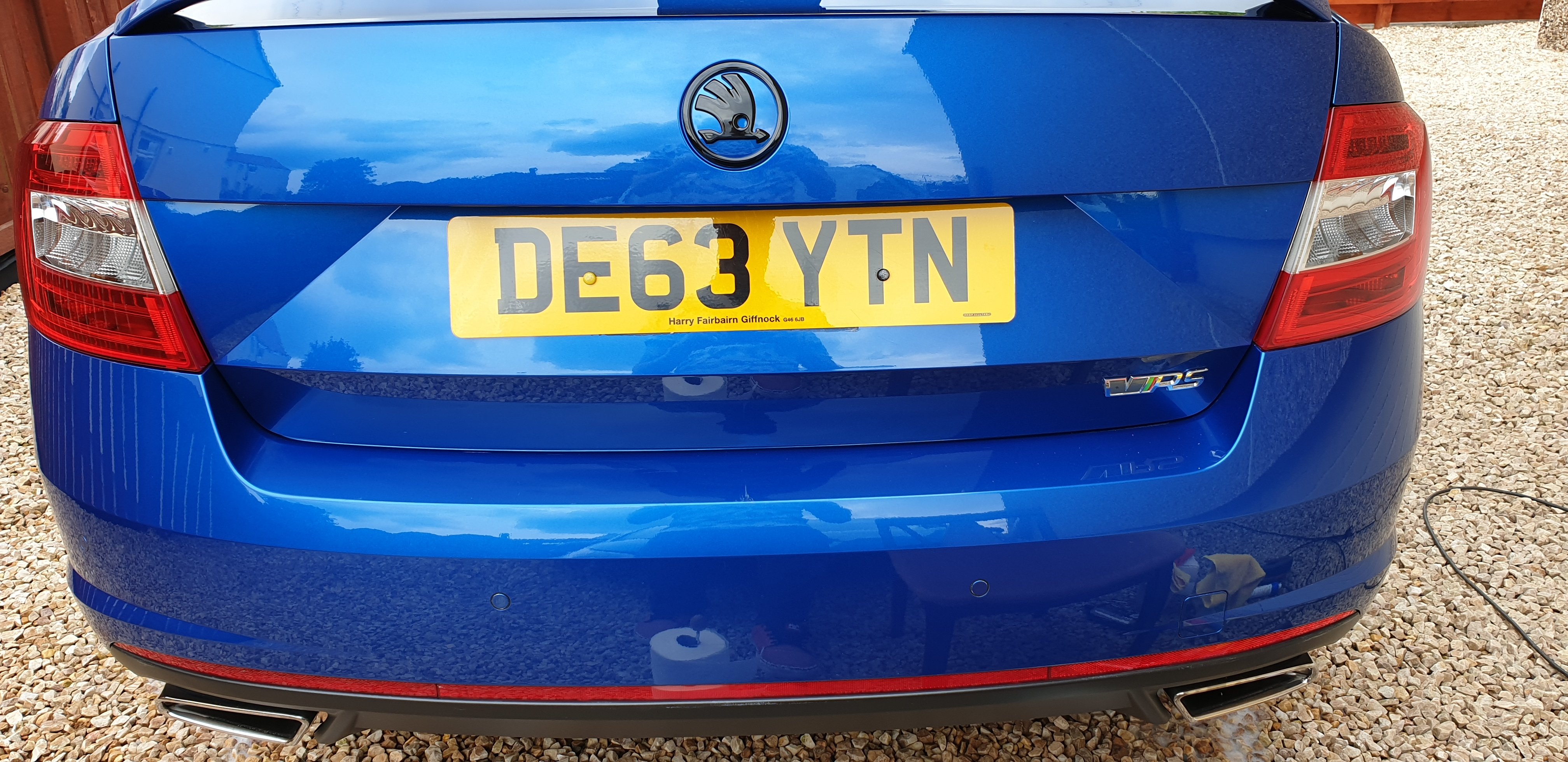

Rear badge fitted and removed the lettering for a cleaner look.  Might pop black letters on at a later date but happy with it for now!  Still need to get the exhaust tips finished black (not paying £100+ per tip from SuperSkoda).  Debadge process was the same as above, only much quicker as there isn't much contact from the letters :)
The VRS badges front and back will be replaced when I next get some time (over the next few days)
I was a little worried with the age of the car that there might be some letter shadows and there was but a lick of compound, polish and wax solved that problem.

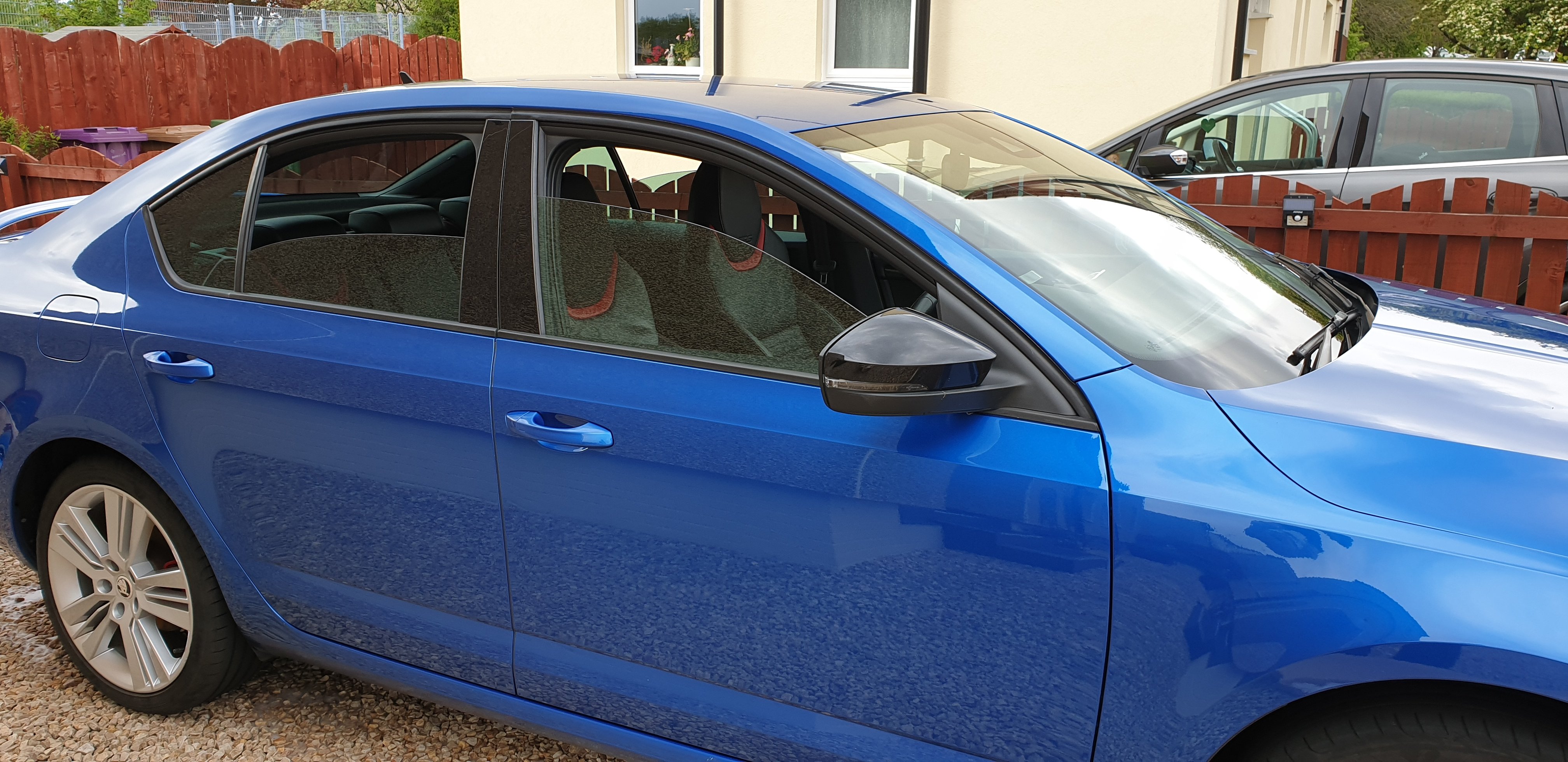

Last update for now- full set of Heko wind deflectors installed.  Had these on my Corsa and missed them- super handy for having the windows down while it's raining or even for some fresh air on the motorway.  Reduces the "buffer" noise!

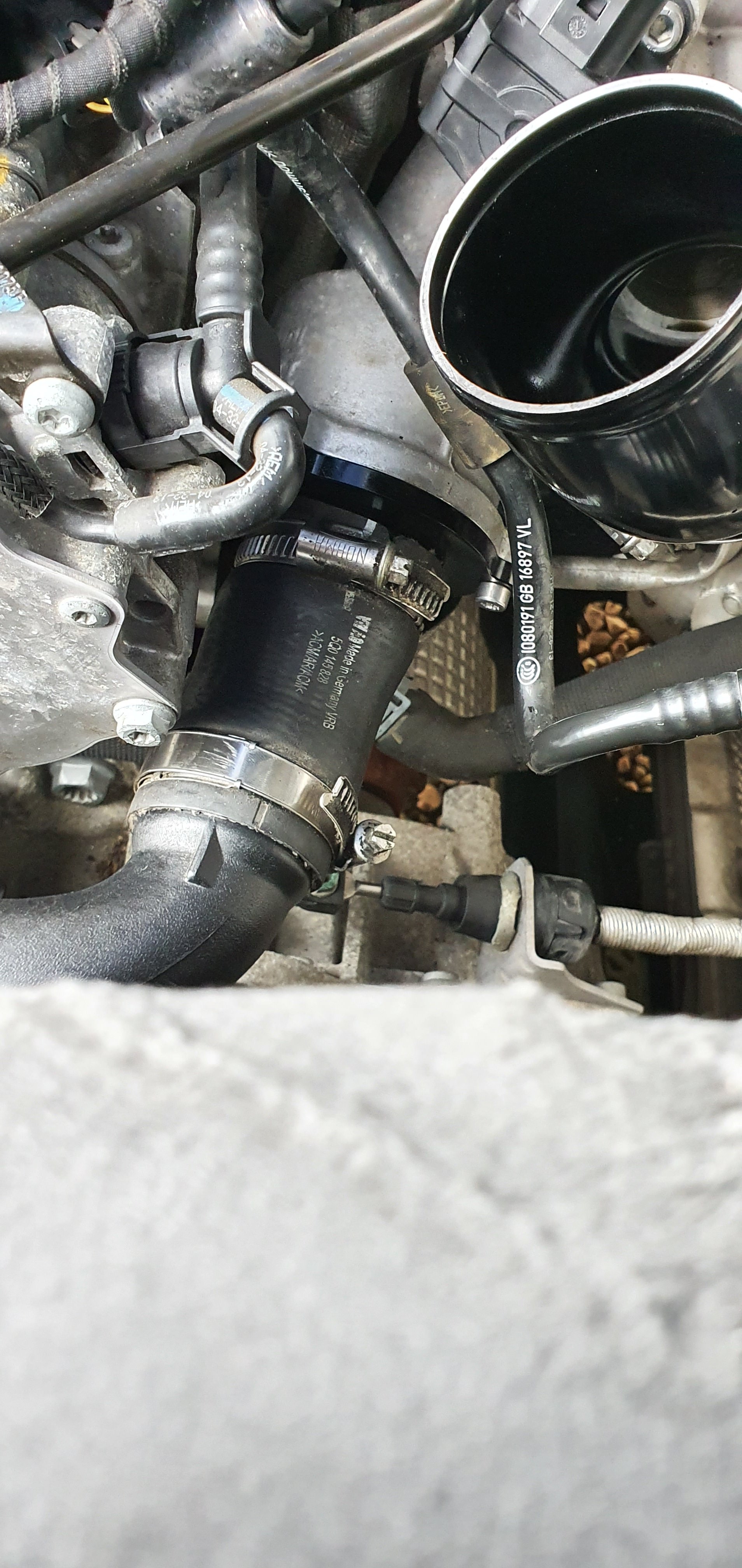

As a treat for her (and myself... :laugh:) I bought an induction system to fit!  I'd been looking around for a while and couldn't decide who to go with.. RacingLine have been around a long time but wanted something different from the crowd.. APR have fancy carbon but are extortionate.. Same applies to some other manufacturers out there.  So, recently I discovered the Ford tuners, Mountune, have dipped their feet in the VAG scene with their brand Mountune52 (AKA M52).  Their system is a little more expensive than the R600 and that's the reason I hadn't ordered it sooner.  The battle of deciding if you pay more for a less known product, or pay less for a product you know has been out for longer and has a better test of time.  M52 are in the middle of a 12 days of Christmas run of deals at the moment and the X3 was listed on day 1, making it cheaper than the R600.. So I bit the bullet and ordered the X3.
General rundown of the X3- my honest opinion

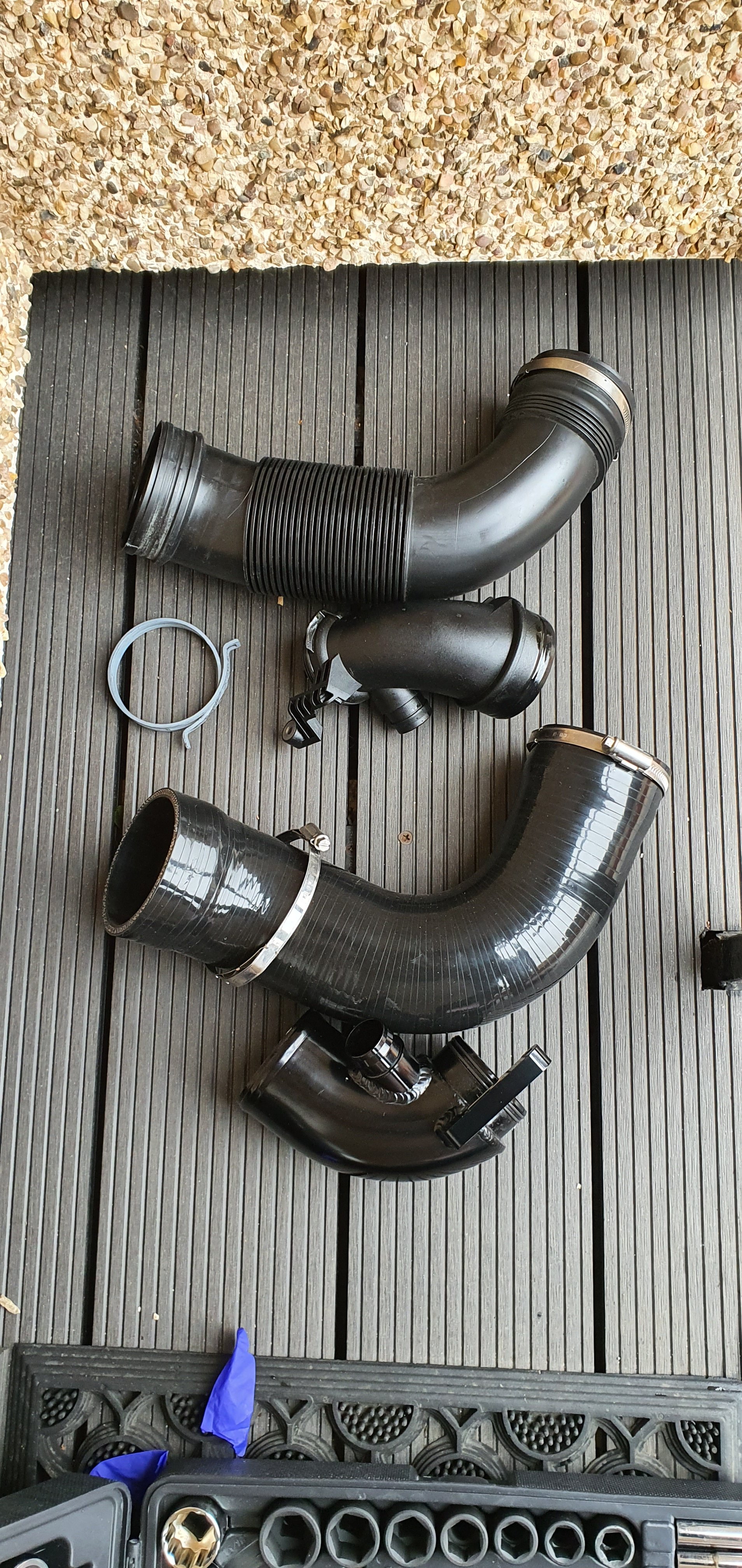

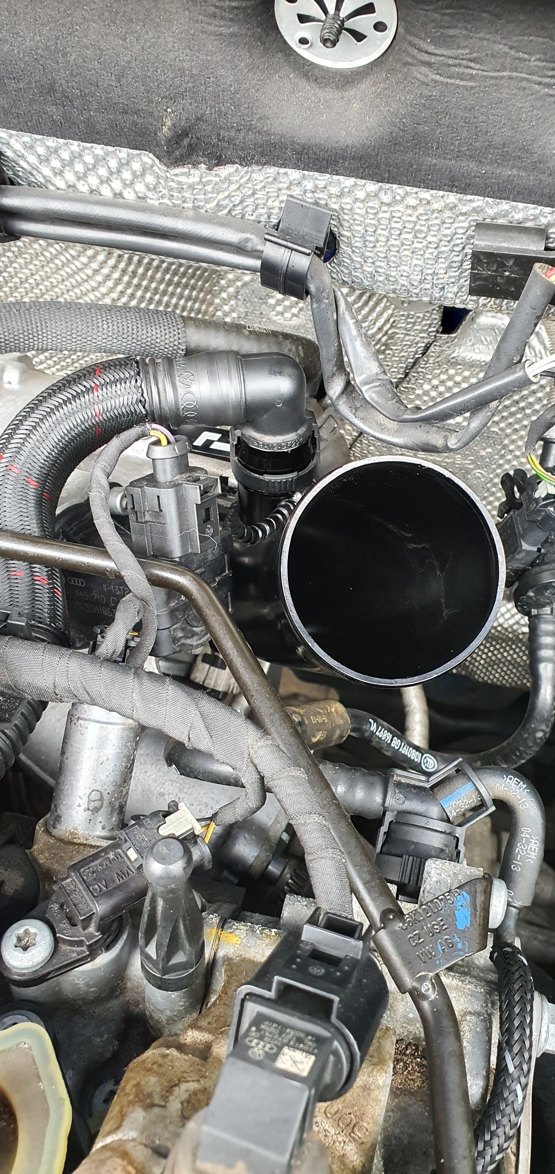

Intake was received very quickly from the guys down at Essex and was very well protected in its packaging.. Initial impressions were the finish and quality of the items are definitely on a higher end.

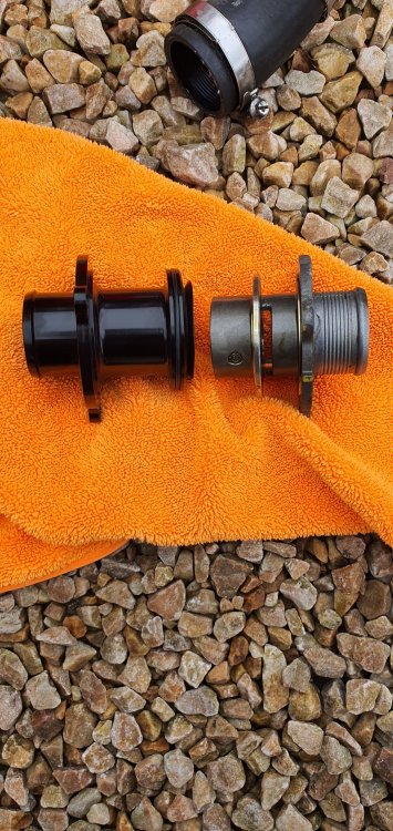

The main differences between the RL R600 and the M52 X3 as far as I can tell are;
Cotton gauze air filter (similar to what K&N use if you're familiar with them)
Triple air entry system (there's an extra two air scoops on top of the housing unit- the idea being you cut away a section of the rubber seal on your bonnet to increase direct air)
Includes an M52 branded silicone hose to re-route your coolant hose underneath the kit for a tidier finish (see pics)
I'm not sure on the RacingLine warranty details but M52 offer a 12 month / 12,000 mile warranty on their parts (doesn't keep manufacturers warranty as far as I'm aware)
M52 also provide fitting instructions or they can offer fitting for you if you live near their base in Essex.  It's worth noting that their fitting instructions are specific to the Golf Mk 7 but are generally the same with the MQB platform.. I noticed there were a couple screw holes covered by pieces from the front bumper I couldn't reach.  Not a big issue though- it's sealed and secured in place.

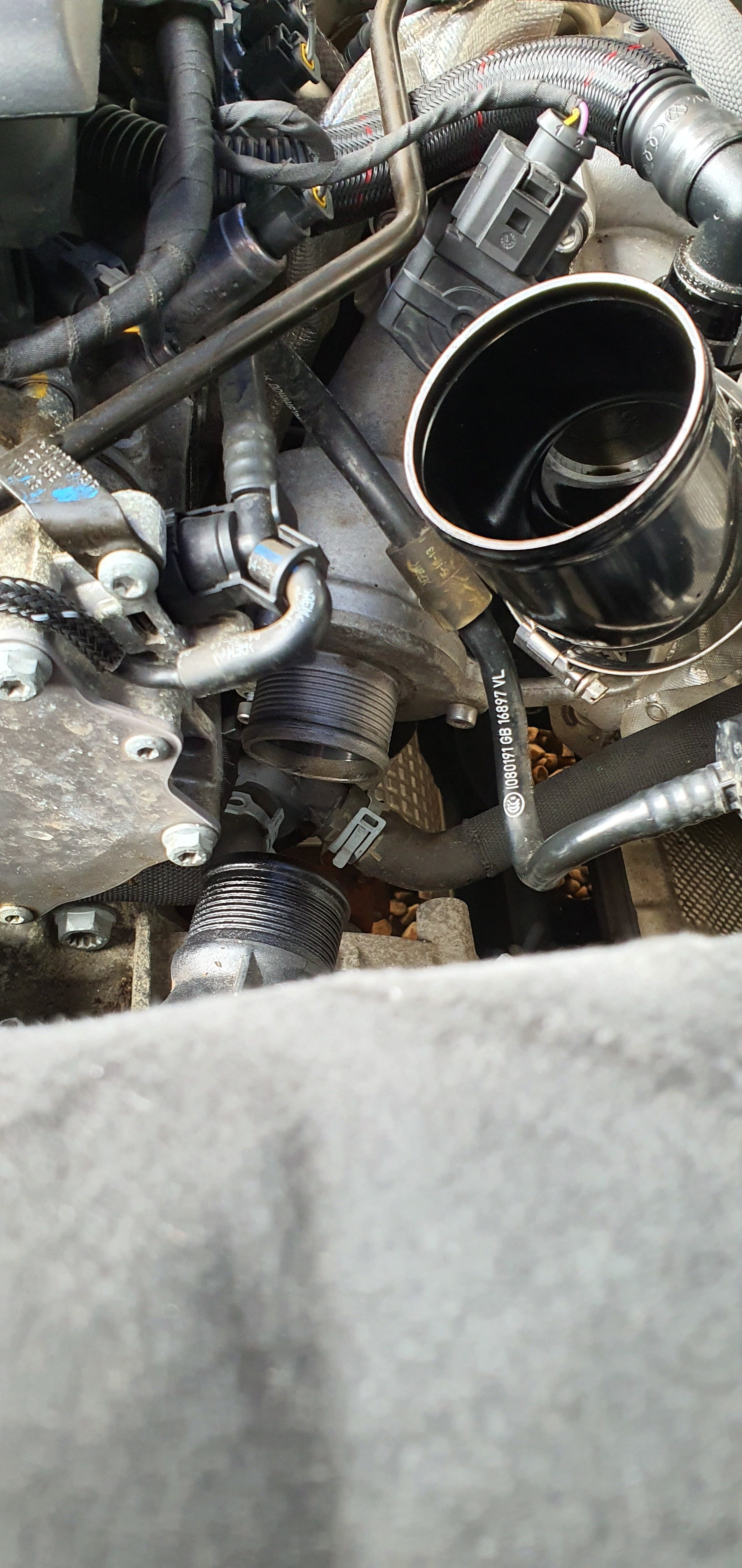

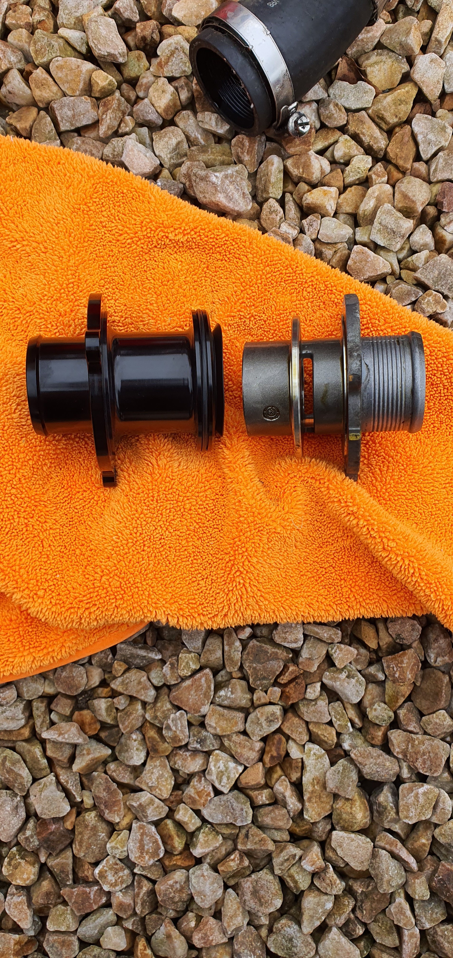

Just placed an order on Mountune52 for their turbo muffler delete.. hopefully that'll arrive this week if the post is still up to speed.. :)
FYI- M52 have a 20% off code to use this weekend if you're thinking of picking anything up from them! Code is SINCE1980
Was lucky to recieve the muffler delete on Monday! They have a fitting guide on their website, again specific to the golf but similar enough to the Skoda. Wasn't as hard as what I was expecting, just involved some awkward angles to get to some of the bolts, success all the same!
It's definitely emphasised the sounds coming from the intake and feels more responsive again.. Very happy with it! :)
