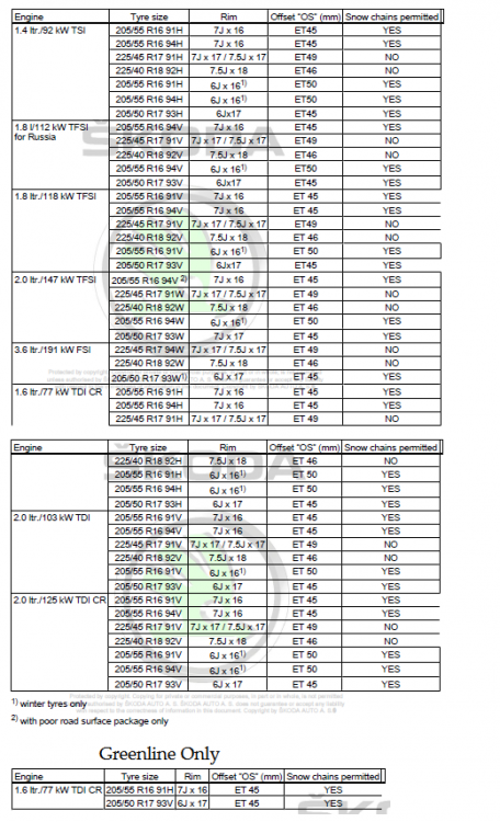

I note that the standard fitment on my car (225/40/18) does not allow the fitment of chains. Maybe I missed it but I don't recall any warnings in the handbook; I'll check next time I have a moment. Makes me wonder if there are folk who bought winter tyres for their standard alloys without realising that chains would not fit.
Here's one ... :D ... I have the chains prepared just in case in the boot, but I hope they won't be required (and if they will, that I'll somehow manage to get them on and use them without creating problems with the wheel arches).
Instead of chains - socks :)
That's unfortunate vborovic. Might be worth giving it a try to see if they fit so you know for sure.
I did have a look in the handbook and there is a very small note about certain wheel sizes not being suitable but it is easy to miss - I did previously. To my mind it should be added to the sticker about tyre pressures inside the fuel flap where everyone would see it.

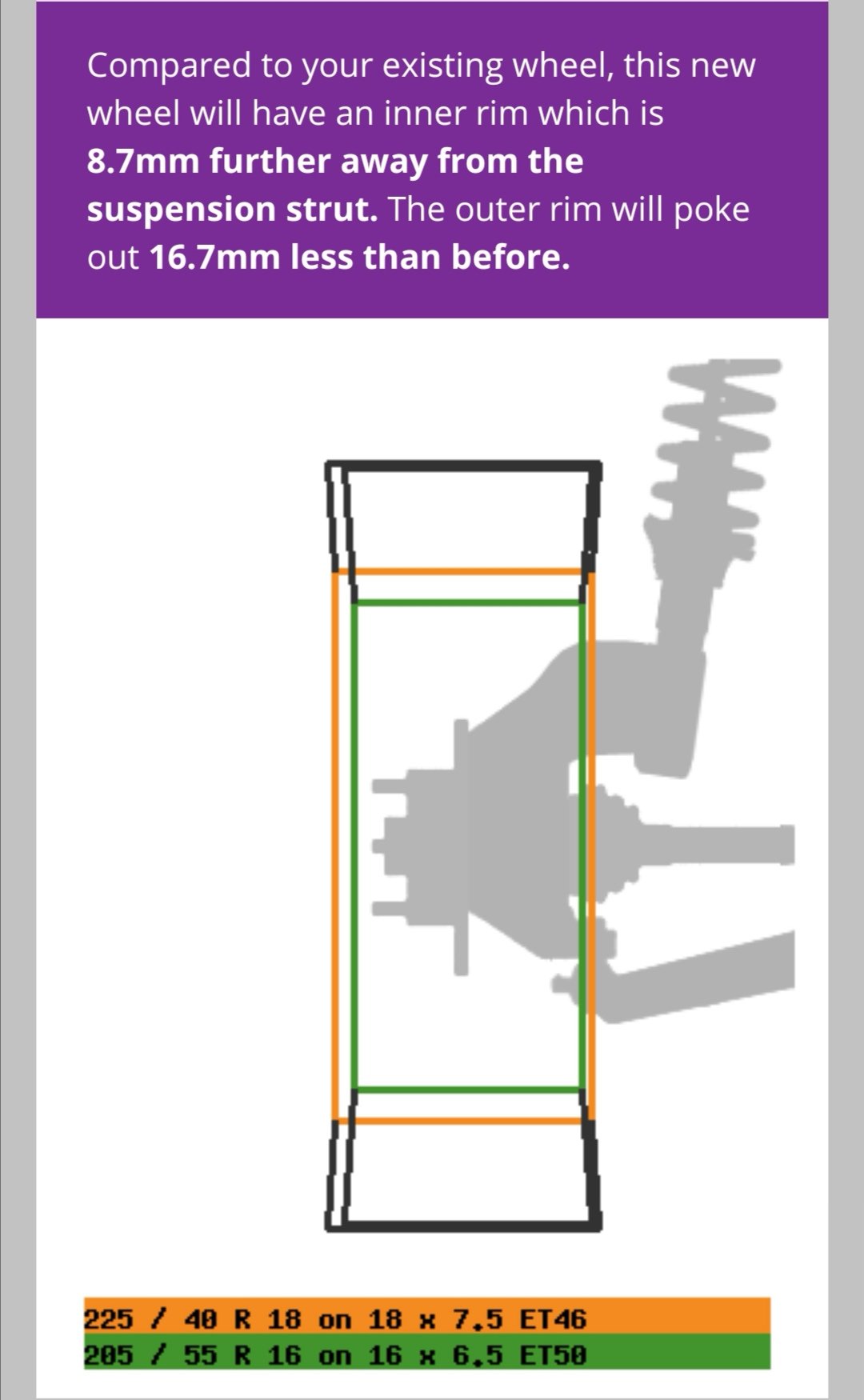

What about 16 inches 6.5j et50 to superb combi mk2(dsg). I'm quite unsure if they will fit.. Thanks

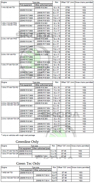

16" rims will fit if your front brake discs have a diameter of 288mm or 312mm. 16" rims won't fit if your front brake discs have a diameter of 340mm or 345mm.

Unless you have a 3.6 engine the 16s should fit around your brakes. The ET is a little on the high side but it might be ok.

I currently have 18s on, 225/40r18 these 16s are 205/50r16, if they fit around the brakes I guess it is ok considering the wheel it's not that wide.

205/55r16, sorry! One more question.. I've heard from my local garage that it might be some problems with the DSG if I put different wheels. Sounds bit weird to me, what do you guys think?

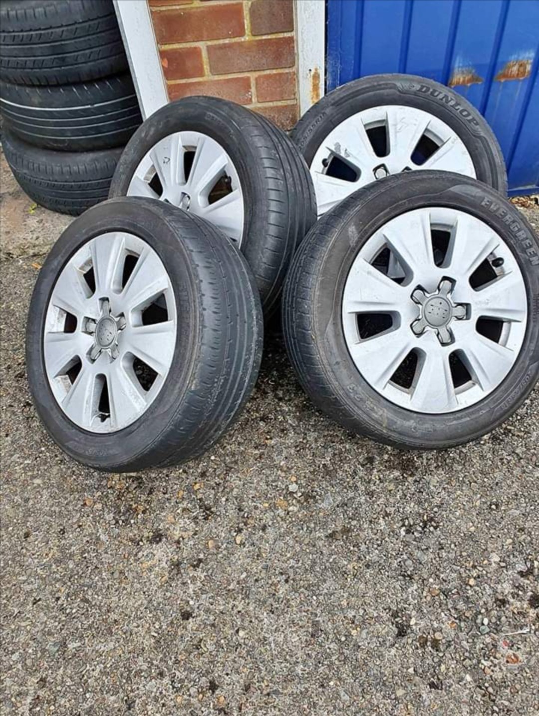

Thanks for replying, these are the alloys that I am after. Found them quite cheap, second hand obviously.
Hi guys, quick update. I got the wheels, but I reckon I will need some spacers now, I was thinking about 15mm spacers all around.
