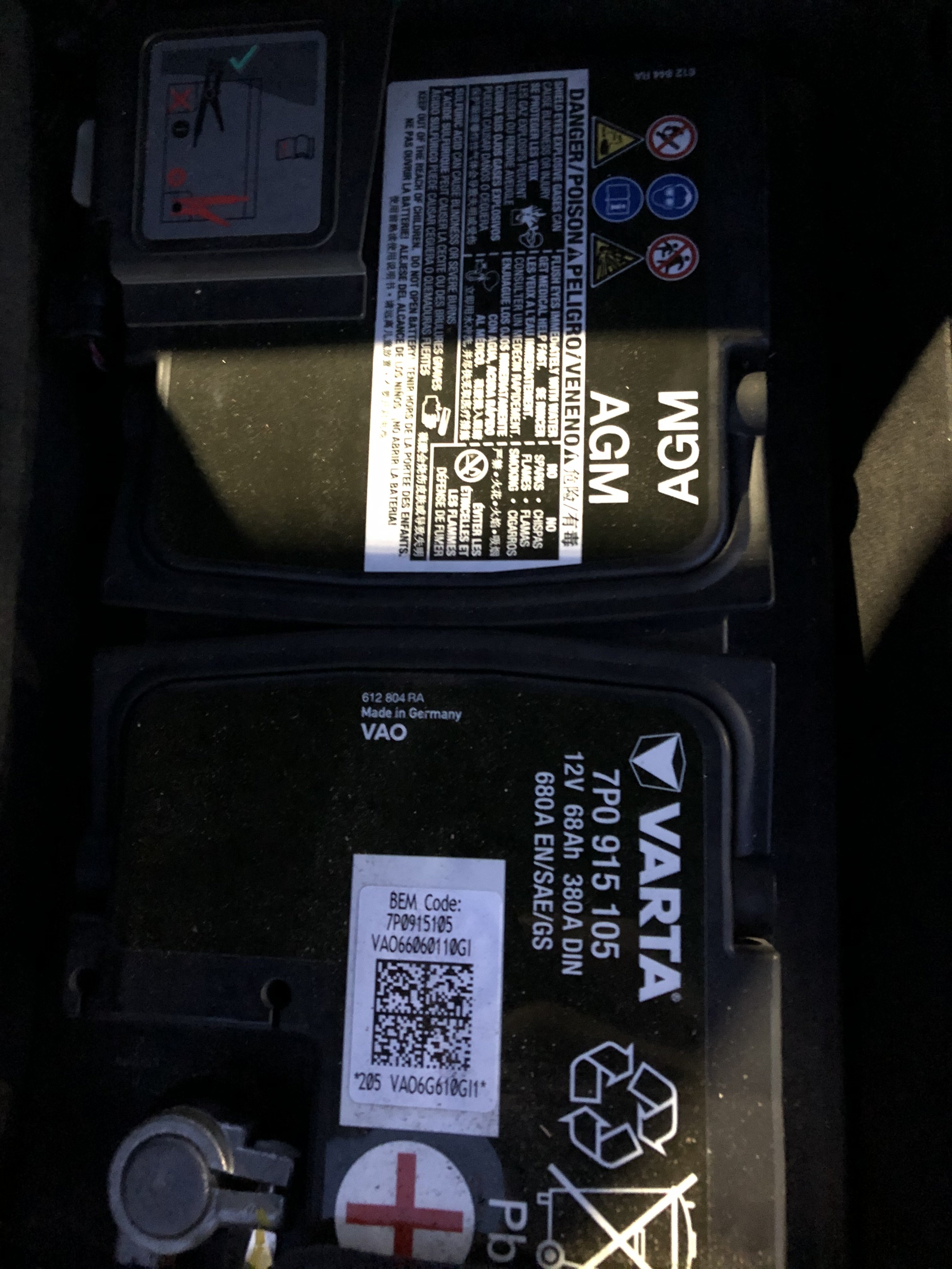

It was ex motorbility. Only done 25000 miles. It was bought privately and to be honest I didn’t notice it on test drive.
i checked the battery tho this morning and it’s and AGM battery.
So should I take to a dealer to be checked?
Do you want it fixing ?
