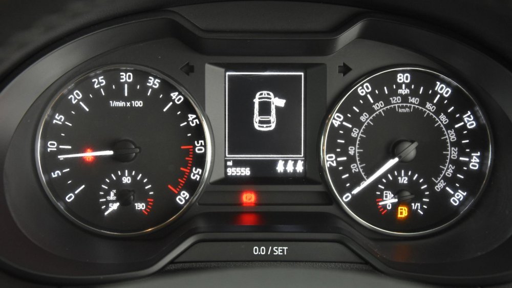

If your gauge looks this, its the water temp and you must definitely avoid temps above 100C
Do you have the owners manual?  coolant.jpg.ddfb88a32495da3db2a02c321a2bad97.jpg
Hi there,
its the bottom left of the picture attached. If it is the coolant, when checking the water, it seems tepid and not hot at all, I think maybe what has been suggested above may be correct and it may be a thermo/coolant problem ?
N.b the picture is from images as it’s howling outside !
Yes thats the coolant not the oil temp.
