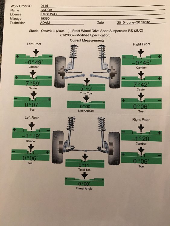

Skoda tracking.pdfSkoda tracking.pdf
Gooday all. Thanks for all the interest in my little problem. Hopefully i've attached the tracking results. If they fail to appear I will have another go. The fitter initially told me that the fronts were ok and the rear passenger side was slightly out. He adjusted the Left rear which thenput the fronts out, which he adjusted back. Interestingly, when I inspected the old rear tyres, although they looked evenly worn, on closer inspection the driver side one had a "wear scuff" mark around 30mm from inside edge. Perhaps the Goodyear F1 tread showed this more as I never noticed this on the Bridgestone's. The tread depth on the inner side was slightly less than the outside. This wheel was in tolerence. The passenger side measured roughly the same across the tread, no scuff mark but was "out" of tolerence, and when adjusted put the fronts out. Well...the tracking was out so hopefully in k9 miles time they will be half worn...I hope! Mind...I like Sneaky Pete's results as they are so Green and even. Mine's Red and large differences in the numbers. There again...just had a week of driving the North Wales scenic railway type roads and handling was faultless. Thanks for the interest.
