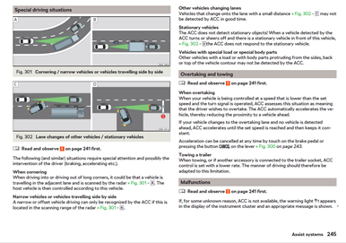

Not had this one, but I did get one the manual warns you about last night. Right filter lane at a left hand bend. Looked almost exactly the same as fig A. I've driven the road loads of times but I don't think there was ever a car turning right in the filter before. Dash lit up red, but it didn't get a chance to brake as I recognised what was going on and blipped the throttle. As soon as I was past the filter it was normal operation.
@Speedman is it possible you were on a bend so the radar was pointing off-centre toward one of the vehicles in the next lane, rather than at the car in front?
