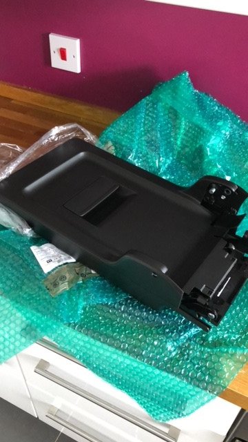

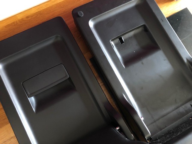

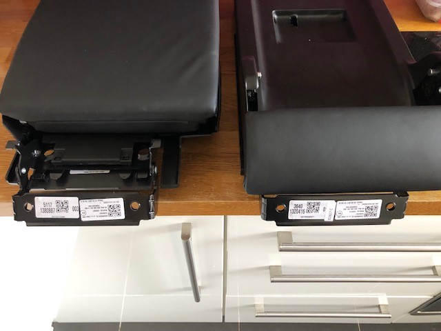

Bit of an update on this,
The company I purchased the vehicle from agreed to source the replacement part above at their cost, and arranged to ship it to me. The part in question arrived today. It is exactly the same as the one I'm replacing, except the new one doesn't have the felt pads on, I'll look to grab the Mrs hair dryer and attempt to transfer to the new part.
The old one & the new one, the new one with the handle still attached (hopefully they're addressed the assembly issue)

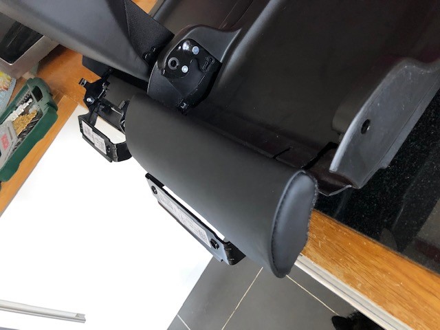

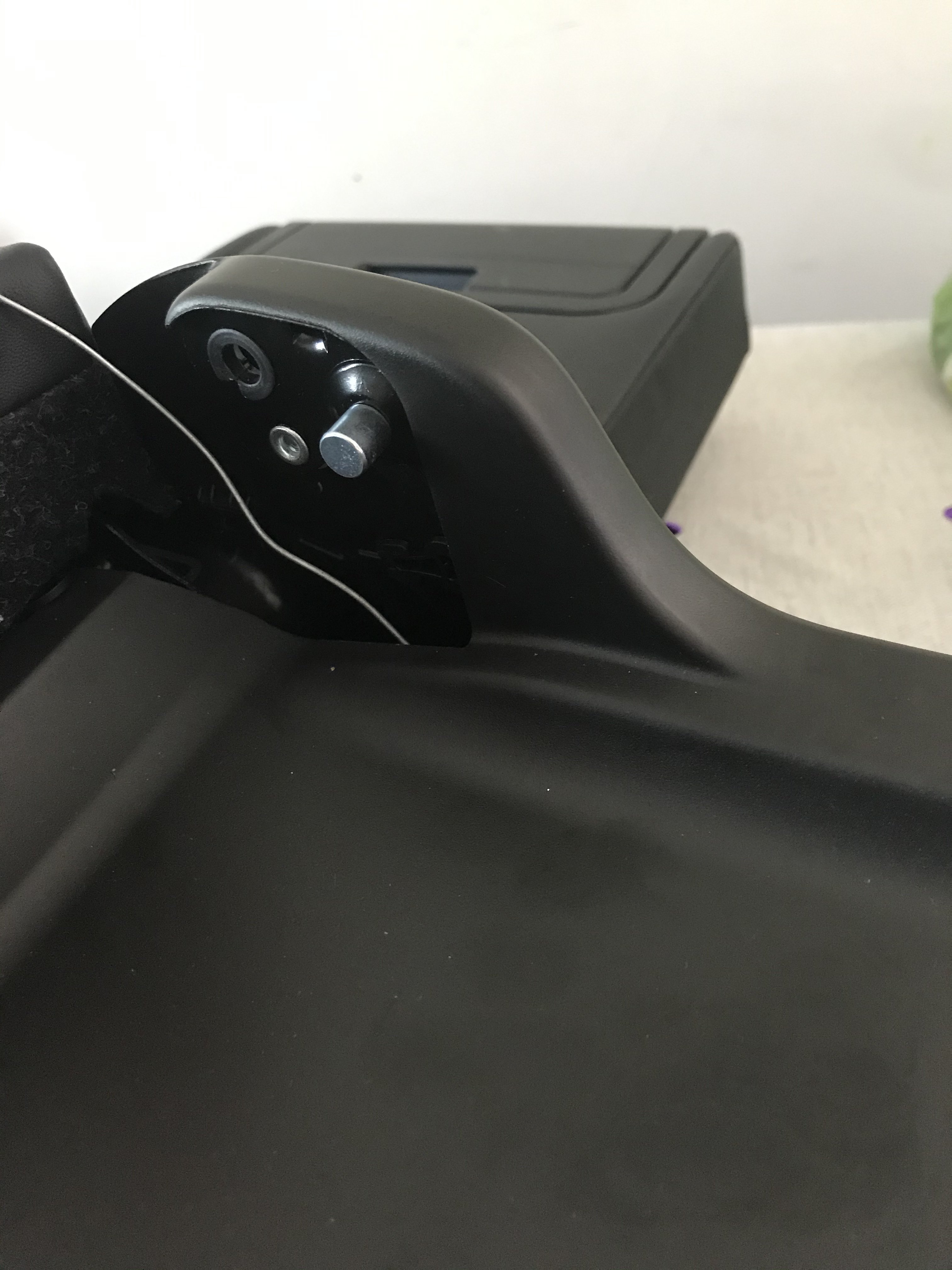

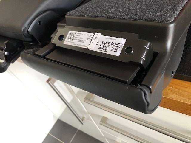

I've been able to transfer the upholstered armrest from the old hatch to the new, it was being held in place by two retaining screws. However I'm struggling to remove the other upholstered part of the armrest. I've attempted pressing two retaining clips, but it still wont budge!
 4.jpg.c875c3da96e6ecb8e74c045b0a26a26f.jpg  2.jpg.1fc7280e2dac736fa71c6786a9c28c1e.jpg

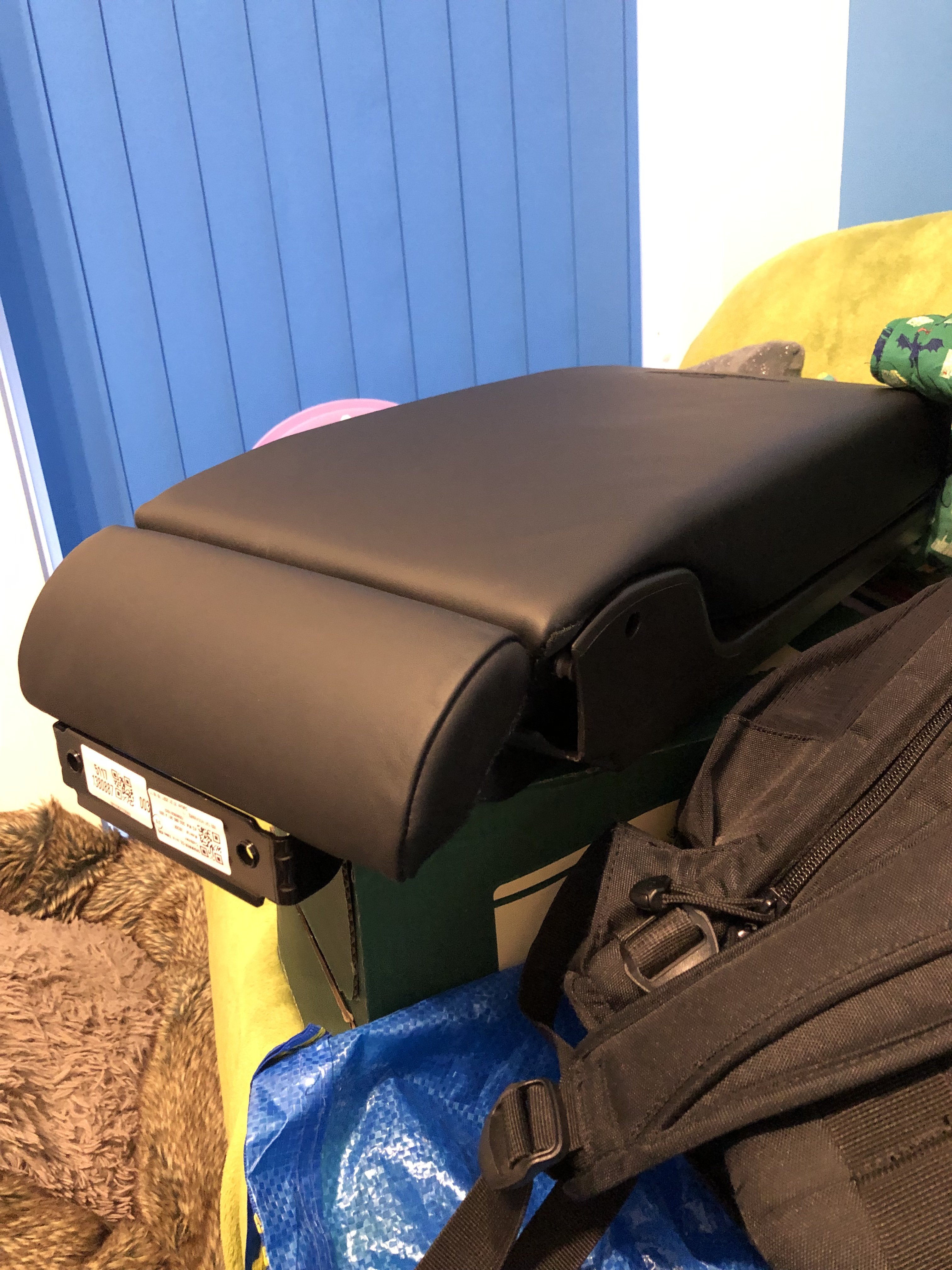

I’ve been able to successfully remove the bottom upholstered section of the armrest, it’s not bonded on as suggests by the part department, but is held on by several retaining clips. I did actually break one whilst trying to remove, but it doesn’t eeem to have any impact on it staying attached to the new part.
My fingers and thumbs are sore as hell from trying to prise the plastic apart. But at least I’ve been able to transfer everything over. Just need to bolt it back in place.

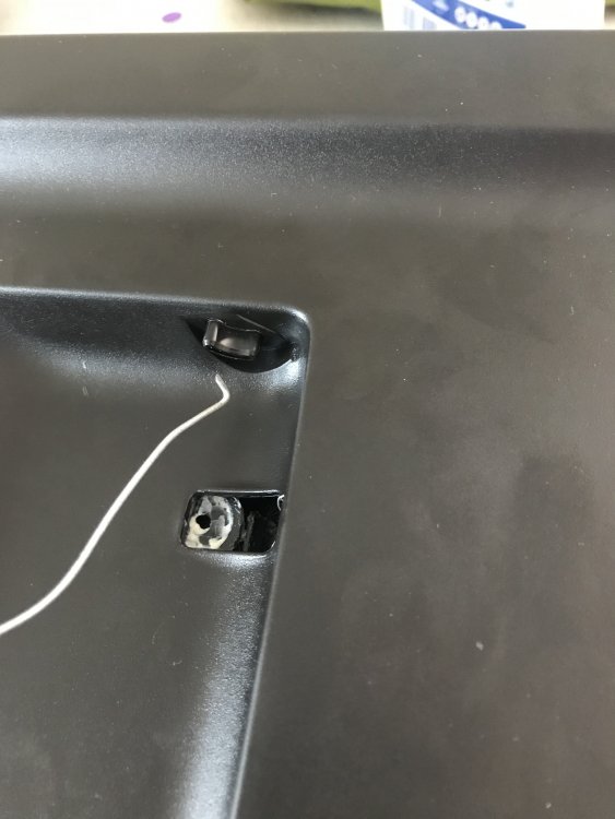

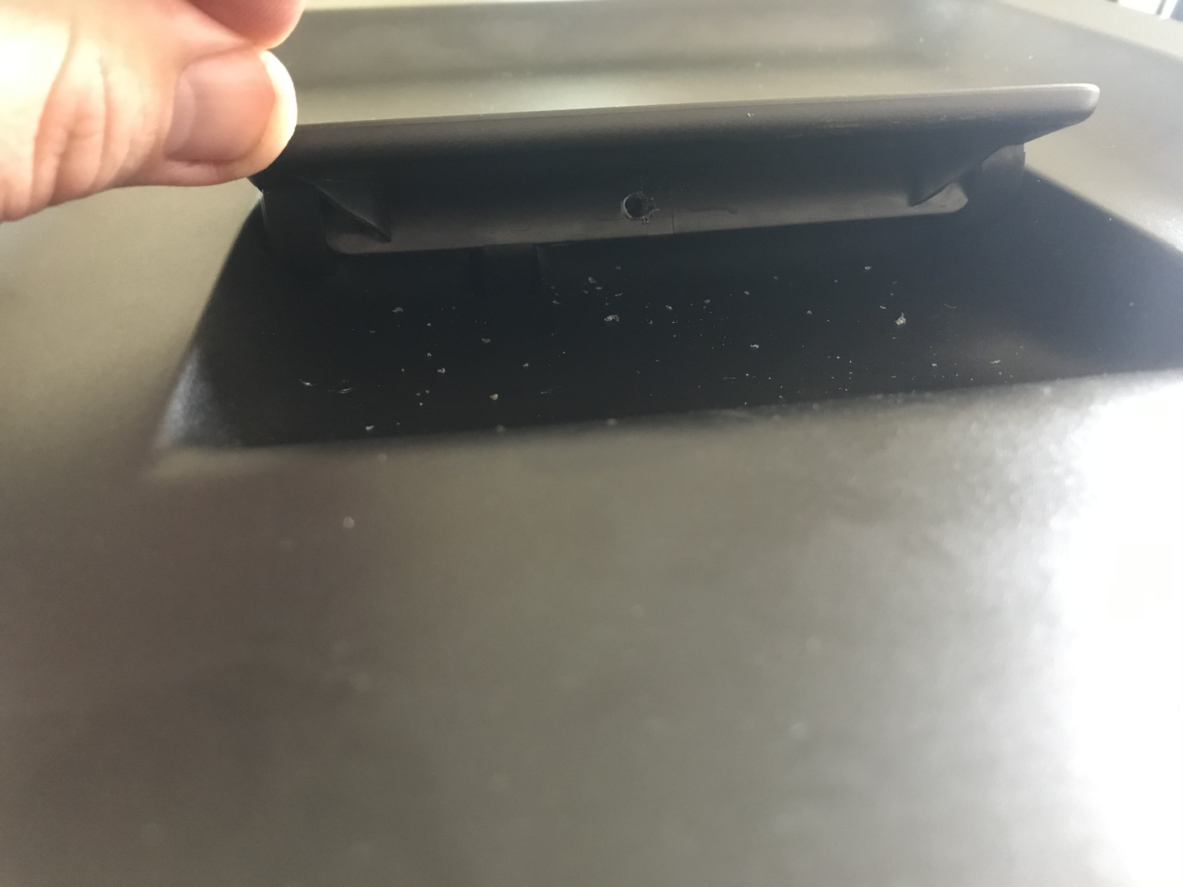

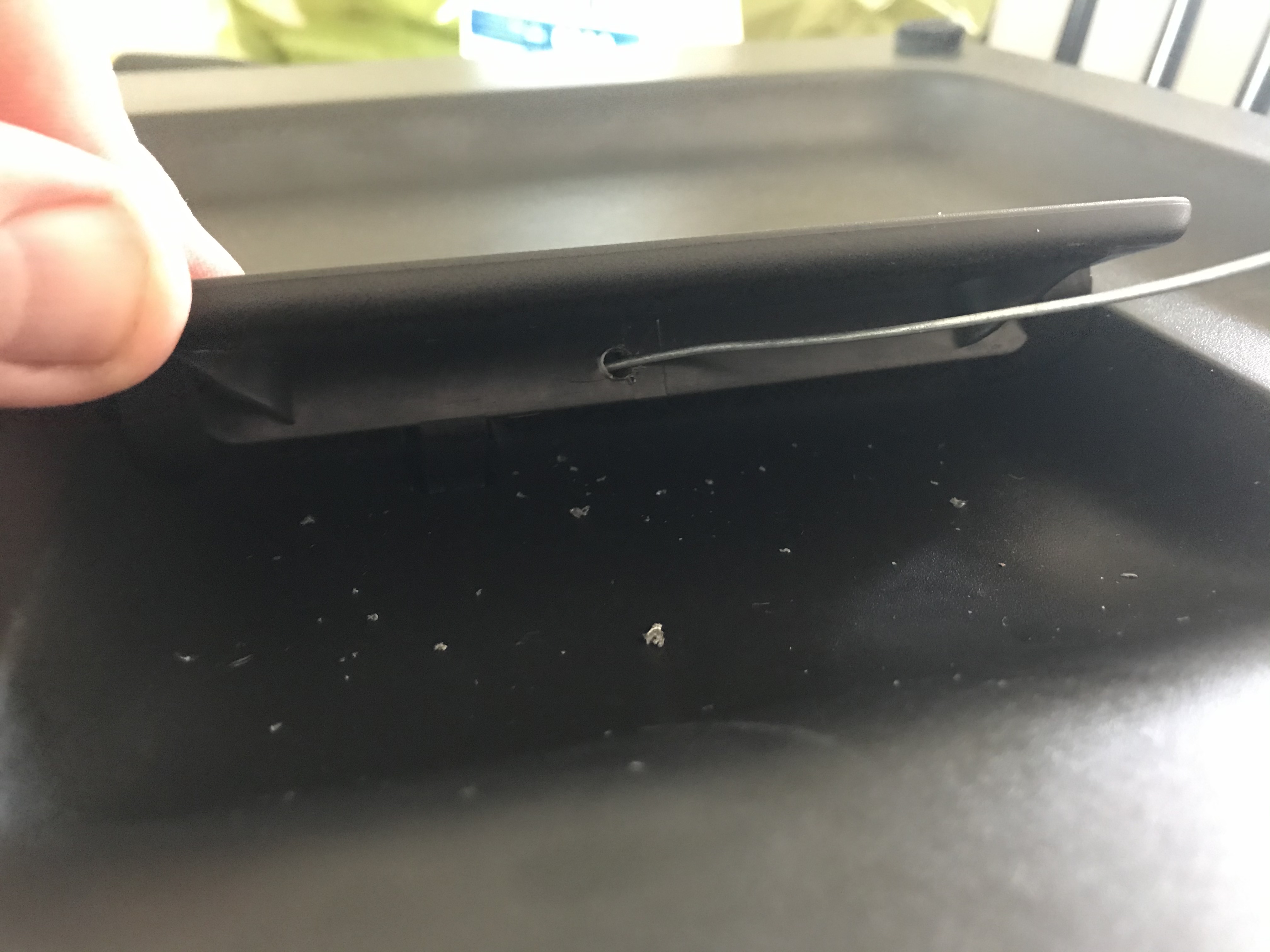

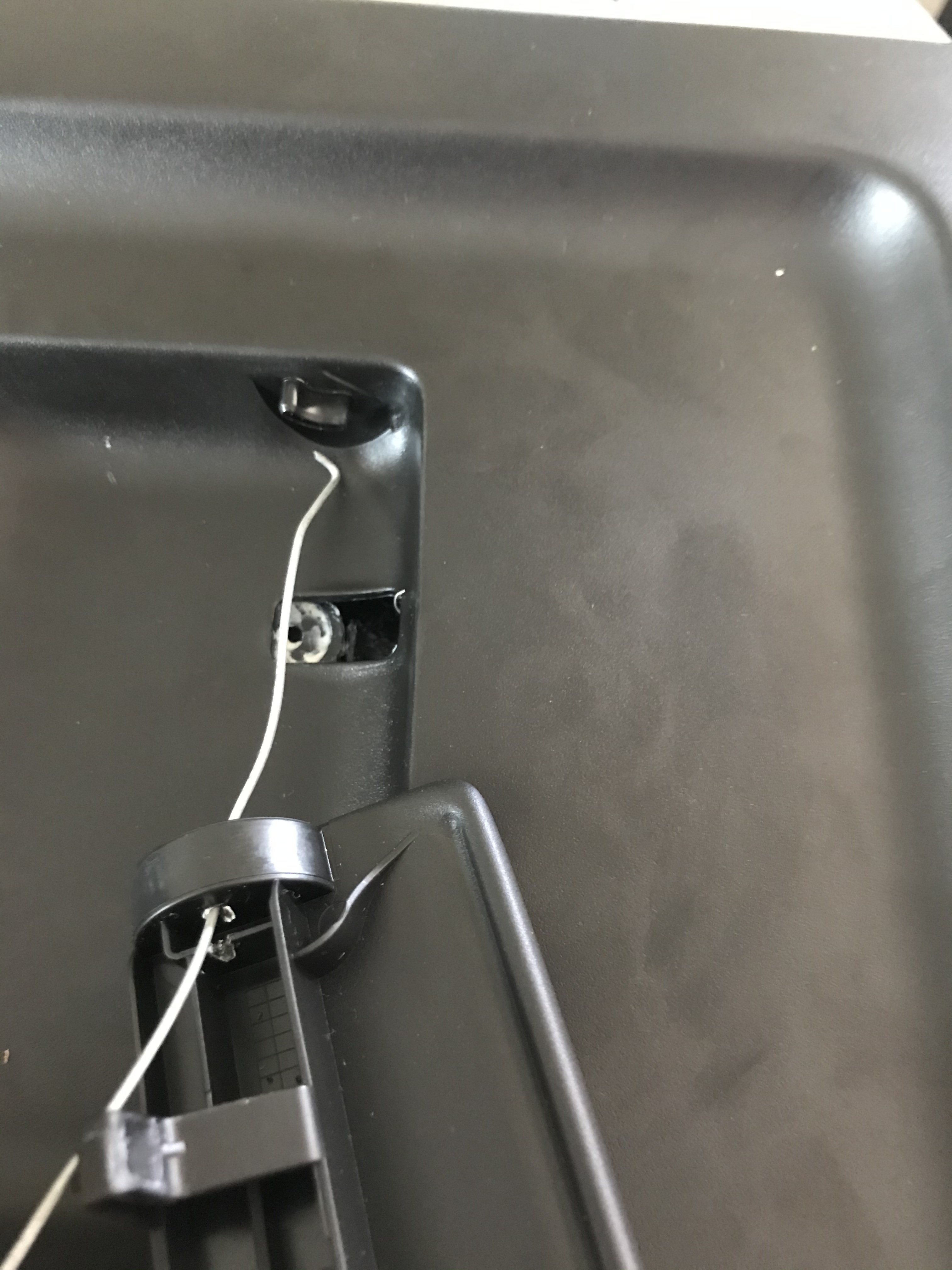

Just managed to fix it! If you can shake out the small clip from the bottom of the arm rest you are half way there. They push fit from the inside. I fed a small but stout piece of wire through the hole for the clip and out the bottom of the arm rest. Put a small 90 degree bend on the end and feed it through the hole in the clip to secure it. (Make sure you feed it on the right way round!  Then use the wire to pull the clip up into the hole. Twist 90 degrees to release the clip. Only problem is you have to hold the handle in place and put the clip in place. So I had to drill few a small holes in the hand end to be able to pull the clip into place straight on with the handle in situ.
all now sorted with a tiny hole under the handle to show for it.
frustrating, awkward, difficult, but not impossible!
