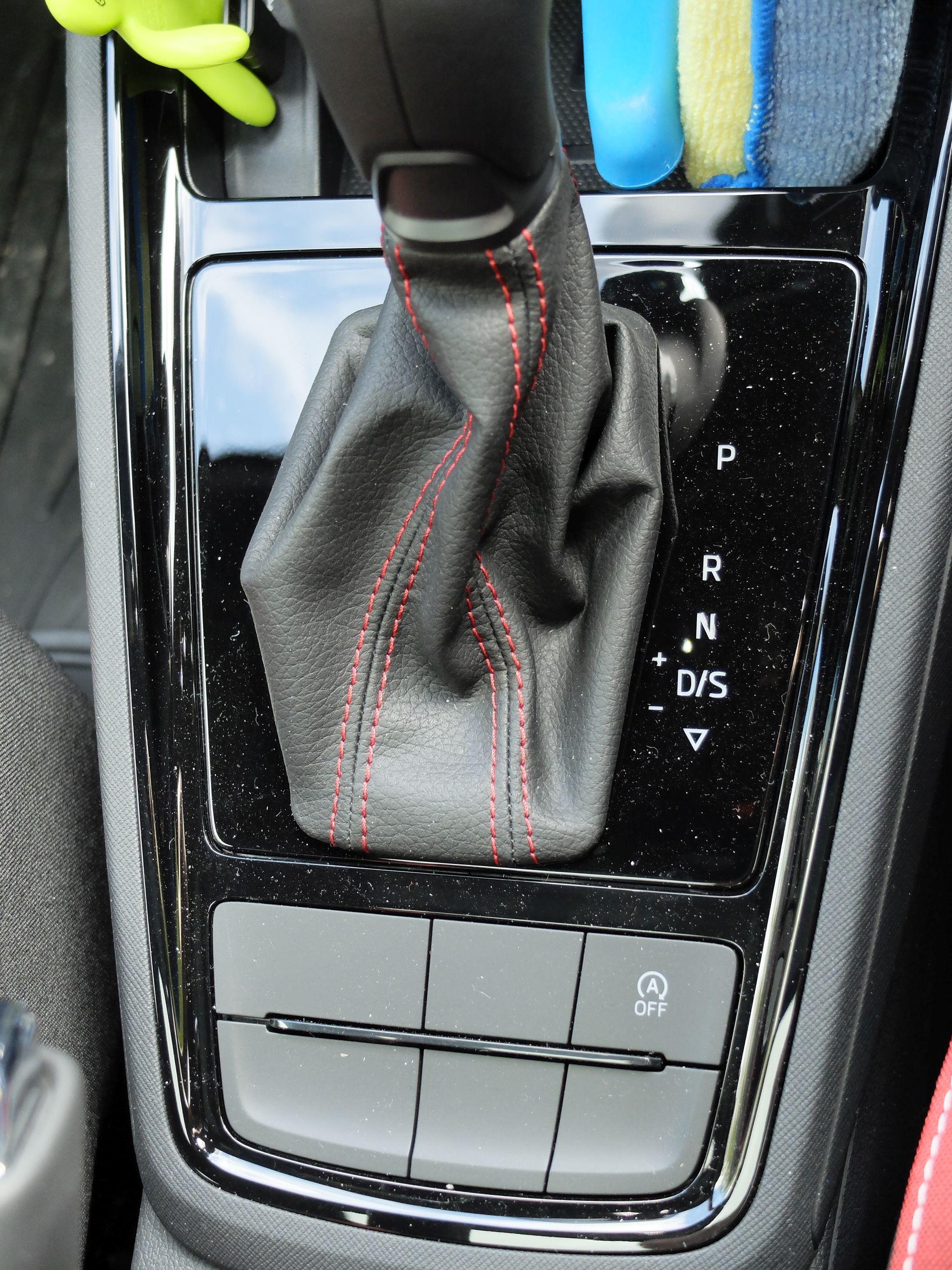

Is this the Auto-hold button?
nope, that's the stop-start function
