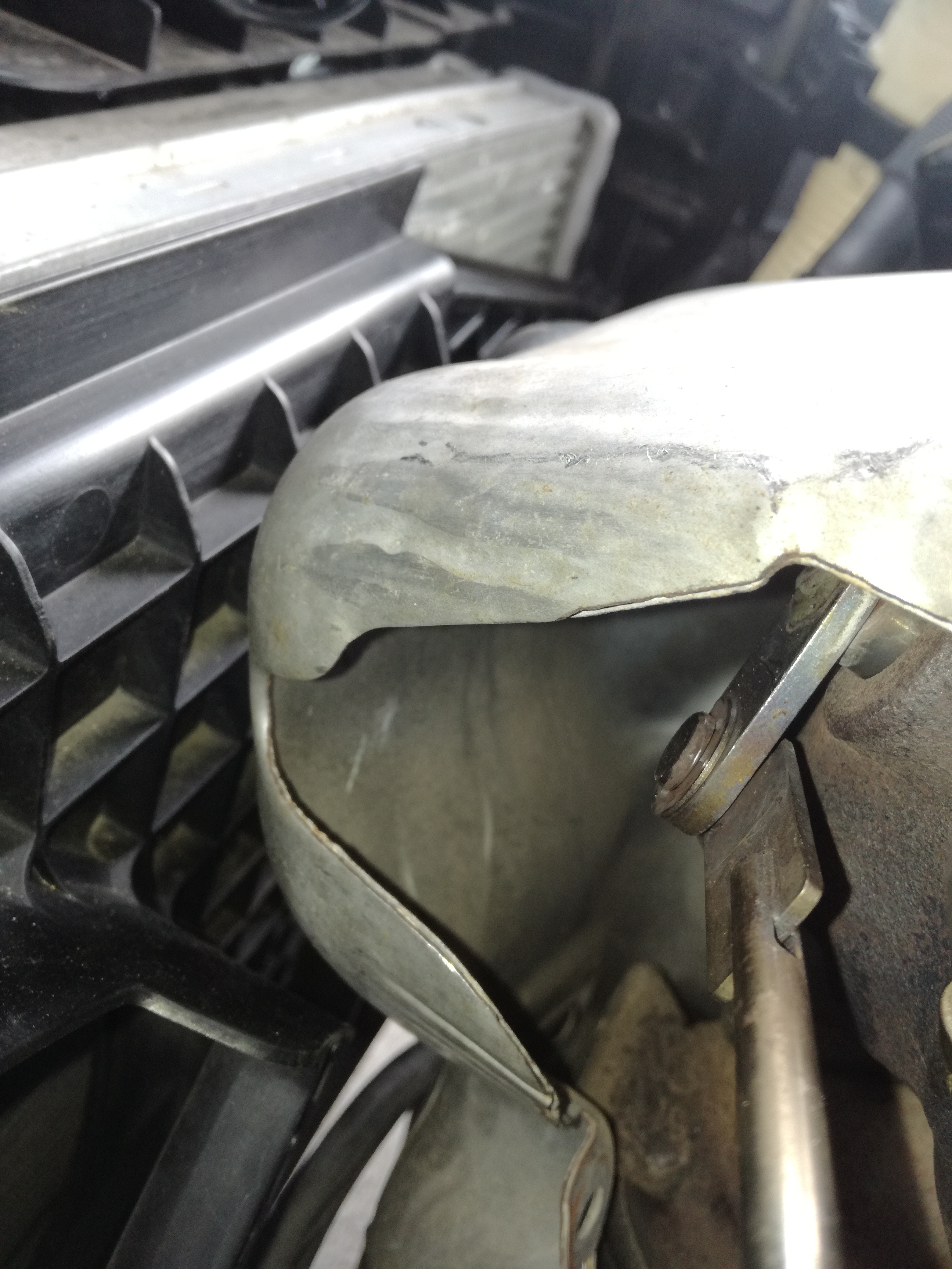

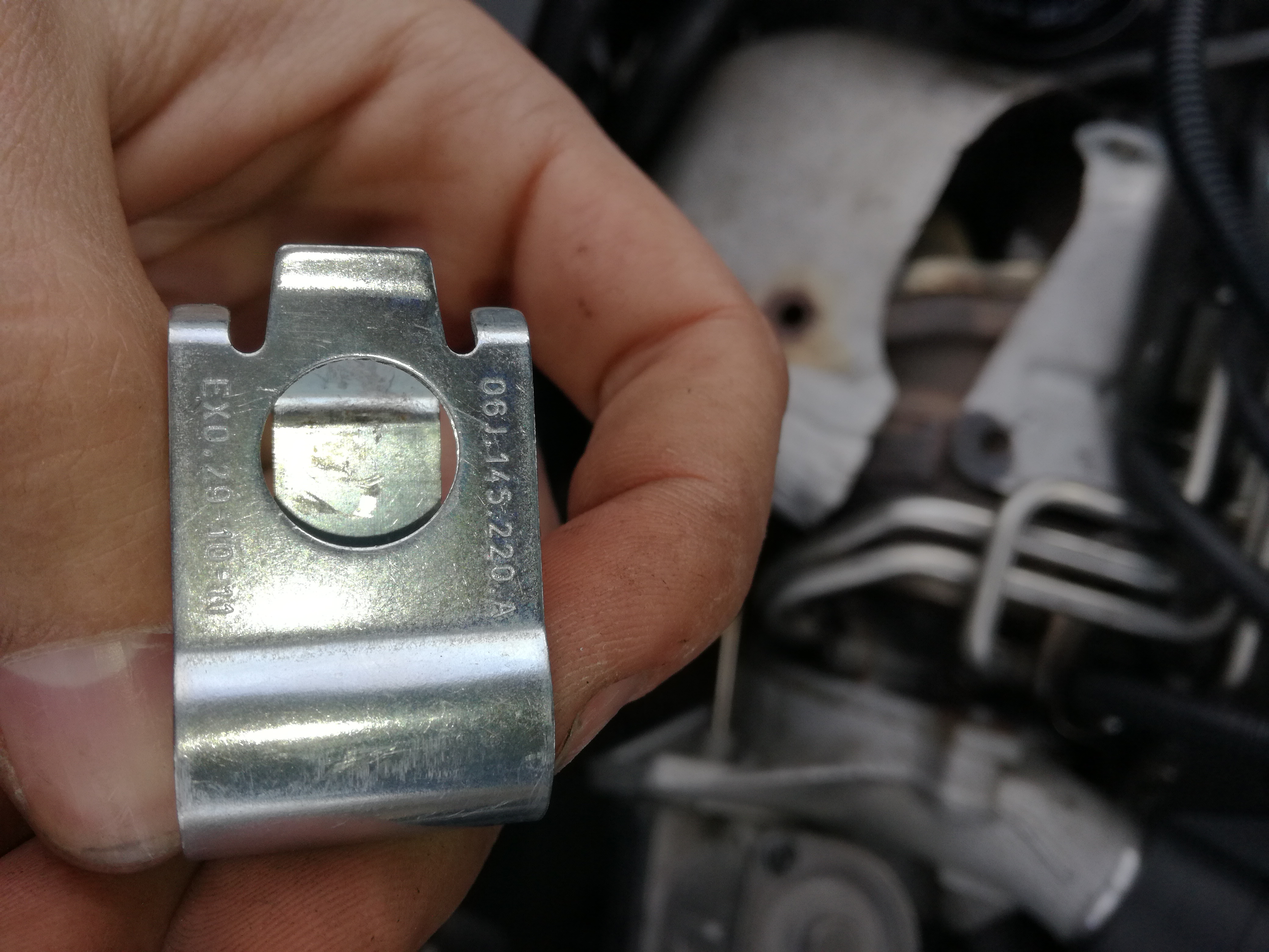

Hello, user @kmackmontecarlo has fixed his waste gate rattle with the clip designed for the 2.0 tsi, I bought the clip but haven't had success clipping it to the rod without restricting movement,  I also couldn't remove the heat shield completely which made it a little harder, has anyone else done it ?
Here is the clip and rod

Afaik the 1.2tsi cbzb/cbza waste gate closure problem was fixed by fitting a shim between the actuator and turbo housing and was done free as a dealer recall on pre 2012 models.
Edited by xman
You are right, but that recall was because the rod would go out of bounds at would get stuck or something like that, this clip is to fix the arm rattle and doesn't affect performance at all.
