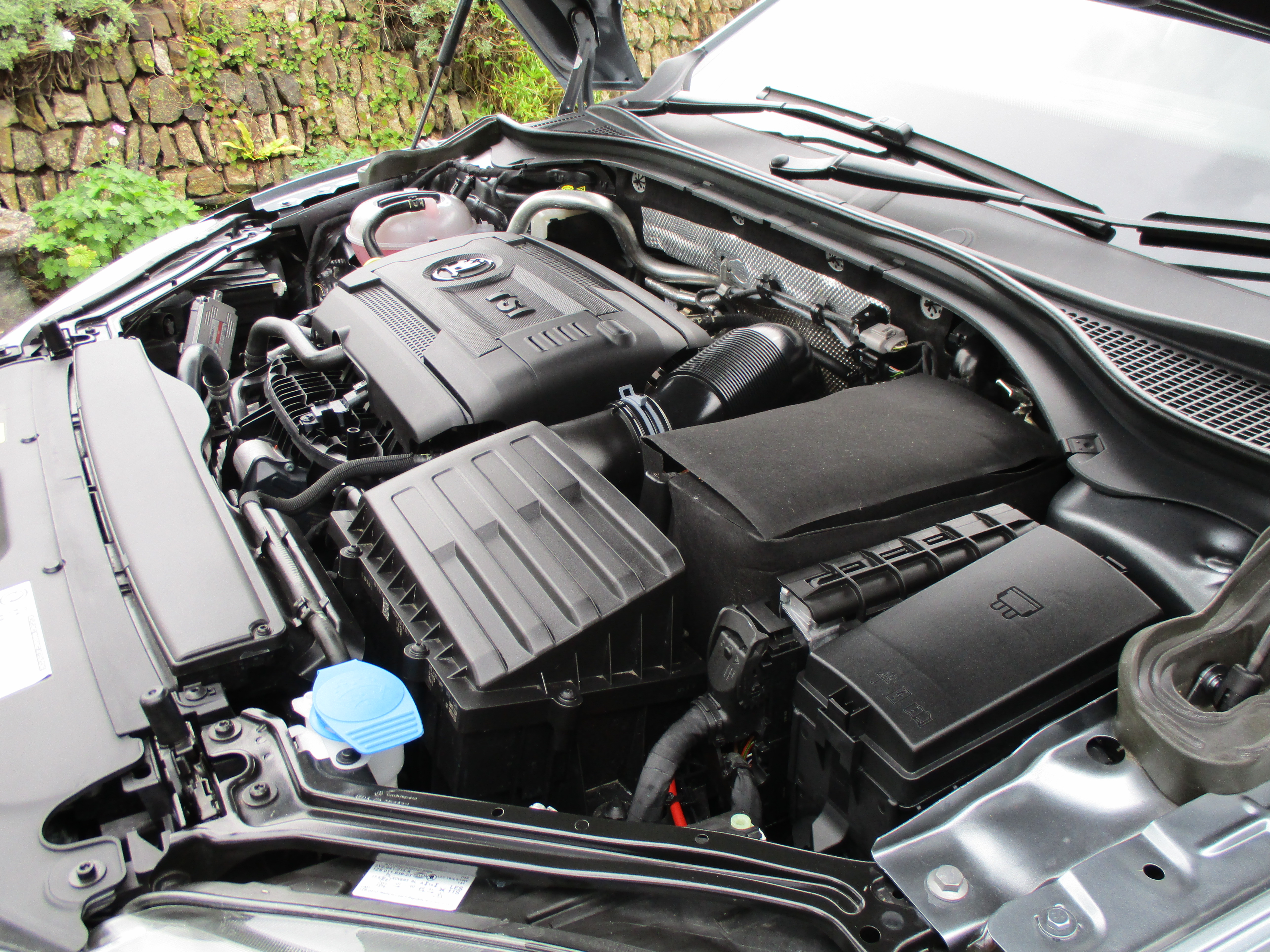

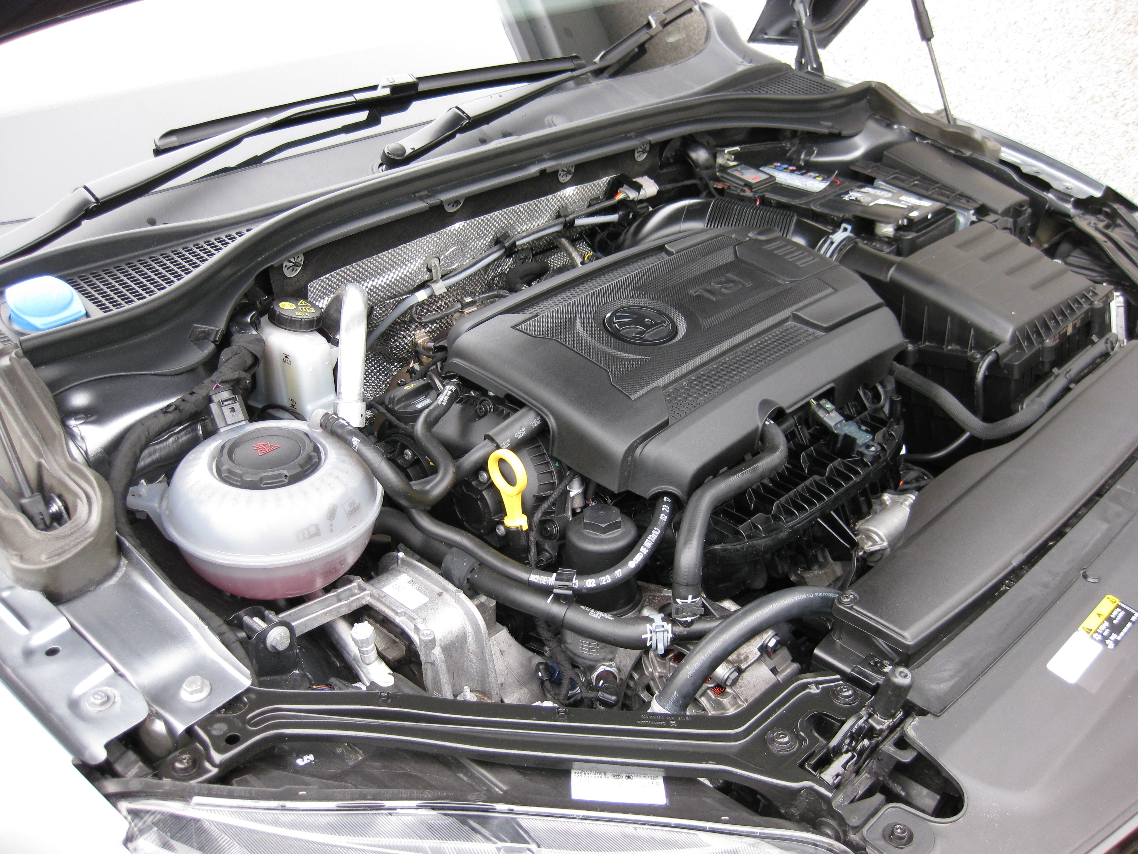

Not sure of routing but the washer bottle does seem to be located much closer to the jets - pic. 1 of my old 220SE-L / pic 2 of my current 280 Sportline.
Isn't the intercooler on the 280 at the front end around the headlight area, perhaps the reason the reservoir is located elsewhere?

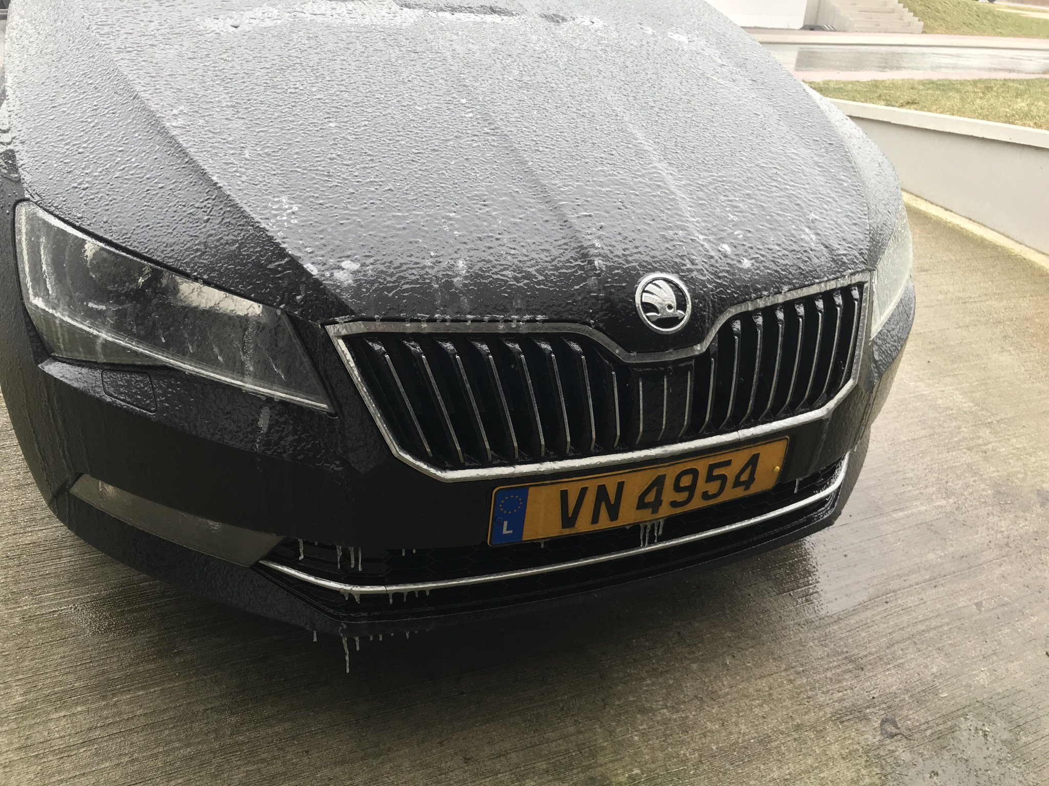

Just been out, temperature has risen to -4C from an overnight low of -11C and the car was covered in a thick layer of frozen rain due to a temperature inversion. Amazingly the washer jets still worked!
None of the external sensors were functioning though, dashboard was like an orange Christmas tree.
Considering -25C is quite common in east European winters, I'm surprised your sensors didn't work. Maybe Skoda will say its the wrong type of frost!
It's not the temperature that's stopping them working, more the 3mm of ice! Same thing when you drive though a snowstorm, snow builds up on the radar and proximity sensors and when they start throwing lots of funky readings the car disables them and shows a warning on the dash.
Same for me on Weds morning, but to a lesser extent.  It was -6C and the two front sensors either side of the reg plate needed to be cleared of ice.   Some of the icicles on the lower bumper were pretty impressive
