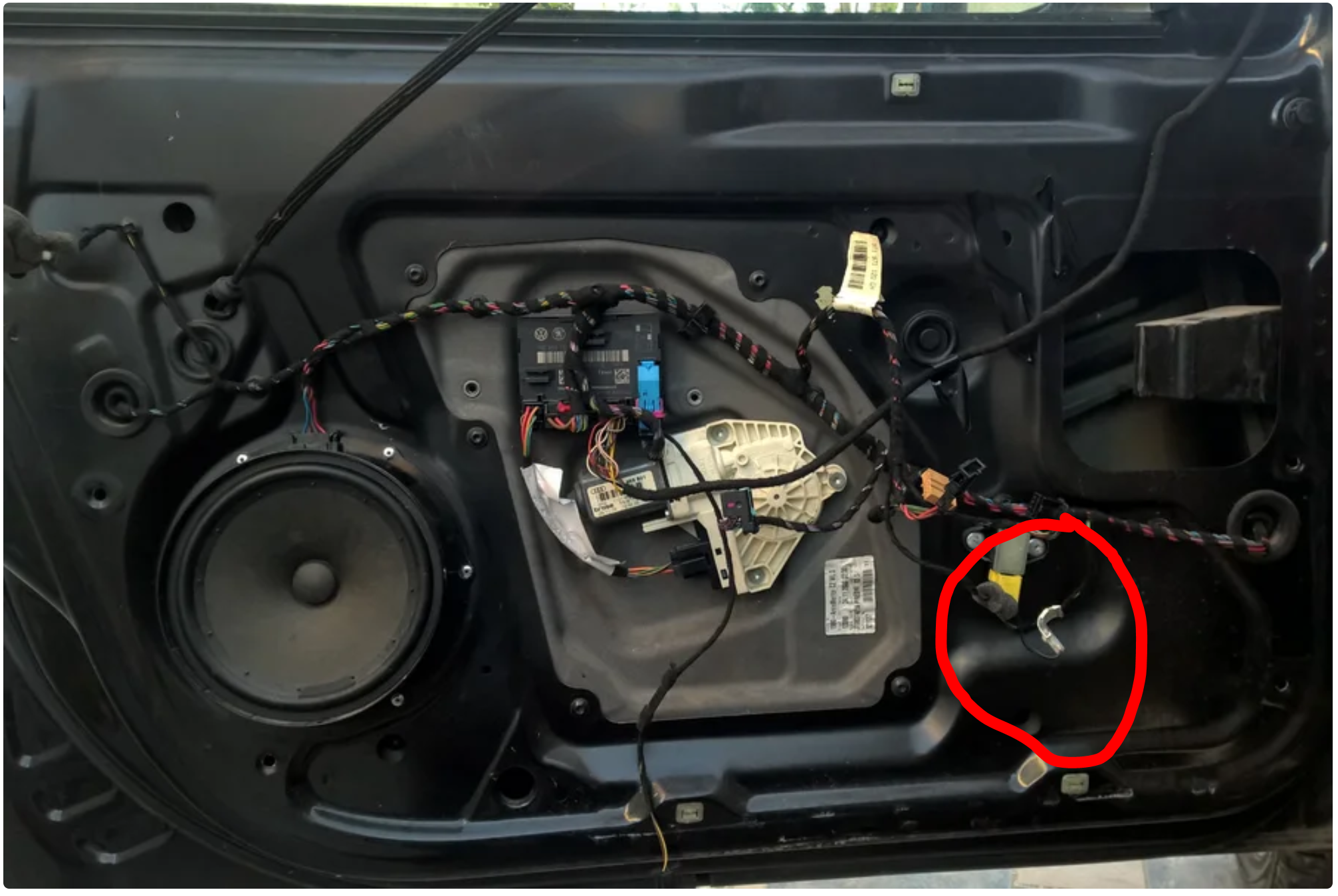

Hi All..
What is that lad I've ringed there in red and where does he go?
Its a curved white plastic clip of some sort with a bulb in it.
I've the airbag light (crash sensor 01221 (G179)) error fixed up but this fella has me flummoxed on the reassembly of the drivers door!
Thanks in advance..
I regret to announce that after having the door electrics working perfectly on reassembly, with the door open, none of it works with the door closed 😩
Any ideas?
Thanks to @Breezy_Pete I took another look at this tonight and found a bent pin on the pillar end. Fat fingers and a nice bit of foul language sorted it and I'm back in business 😁
