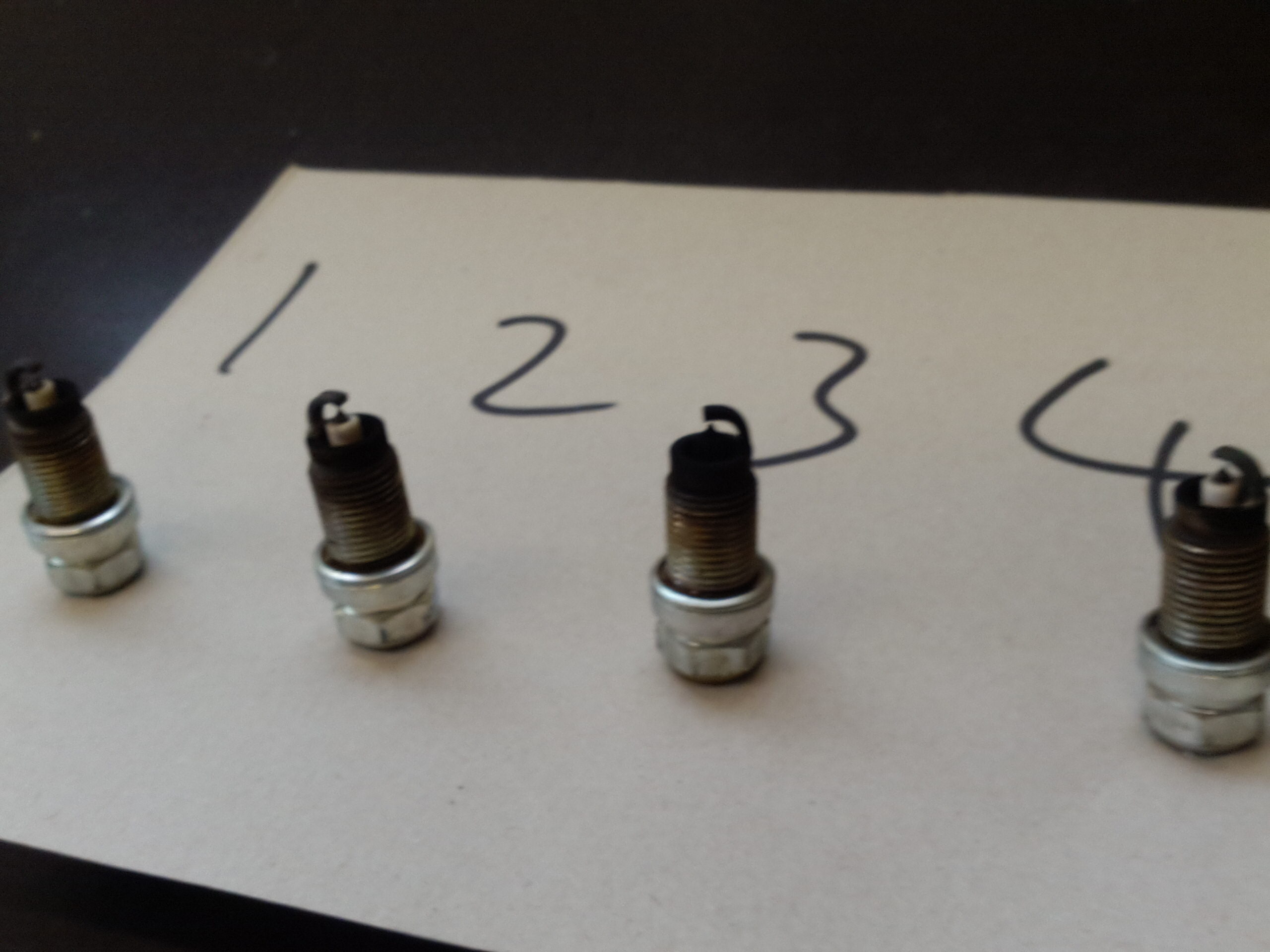

Look at the iridium plugs I just took out.
They look a bit sooted.
Cant see the tips on them.   When they went in what were they pre gapped at, and were all 4 checked that they were gapped correctly?
They all come with 'Iridium' plugs, and you get different Iridium Plugs and some like DENSO can be better than the VW OEM NGK ones.
So what plug gap do you need is it 0.8mm?
What are those plugs showing now if you check the gap?
Do you know about the 3rd leads extra protection?
Yep, new ones to 0.8mm.     BUT what's that about No 3 lead extra protection?

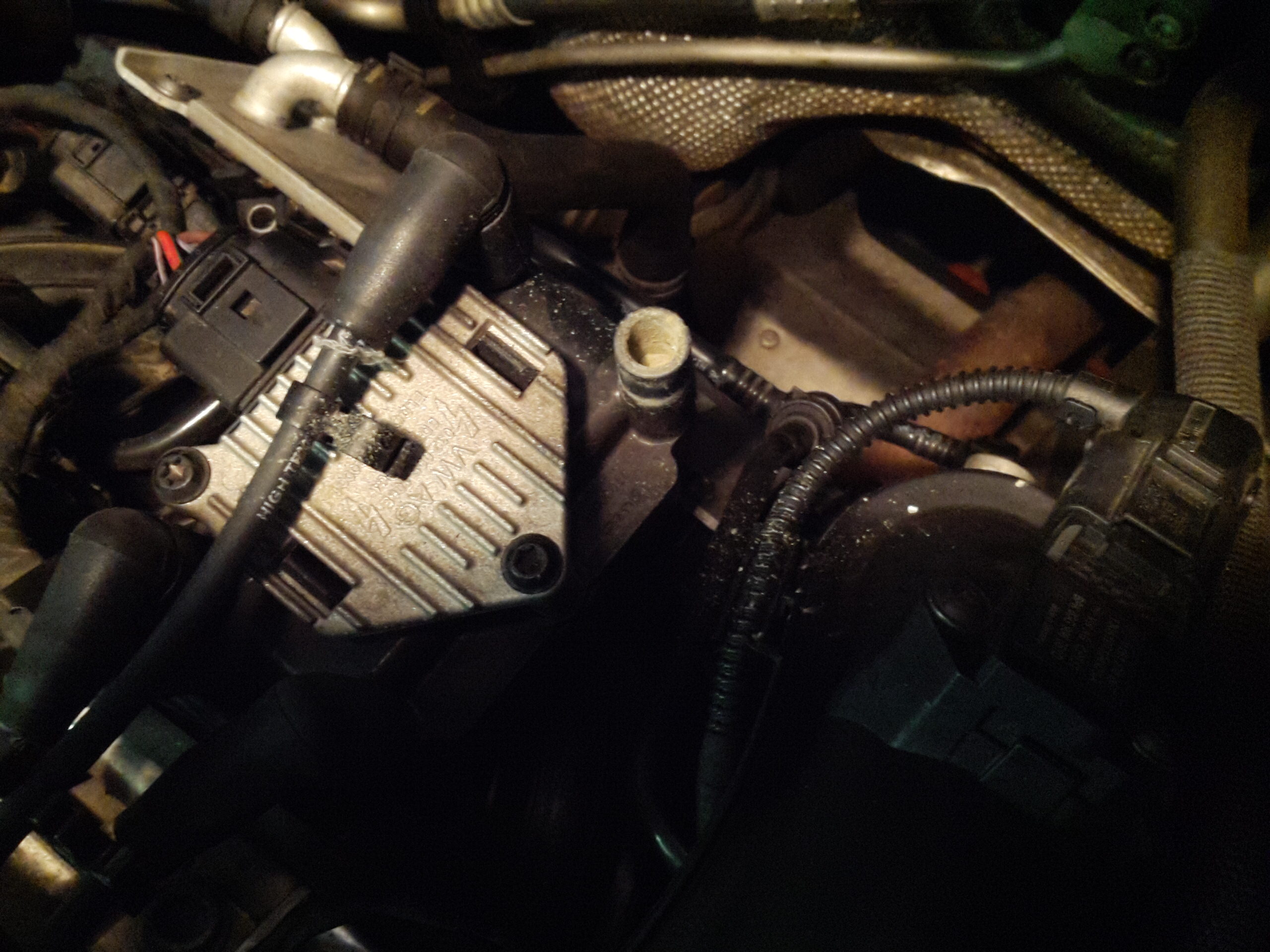

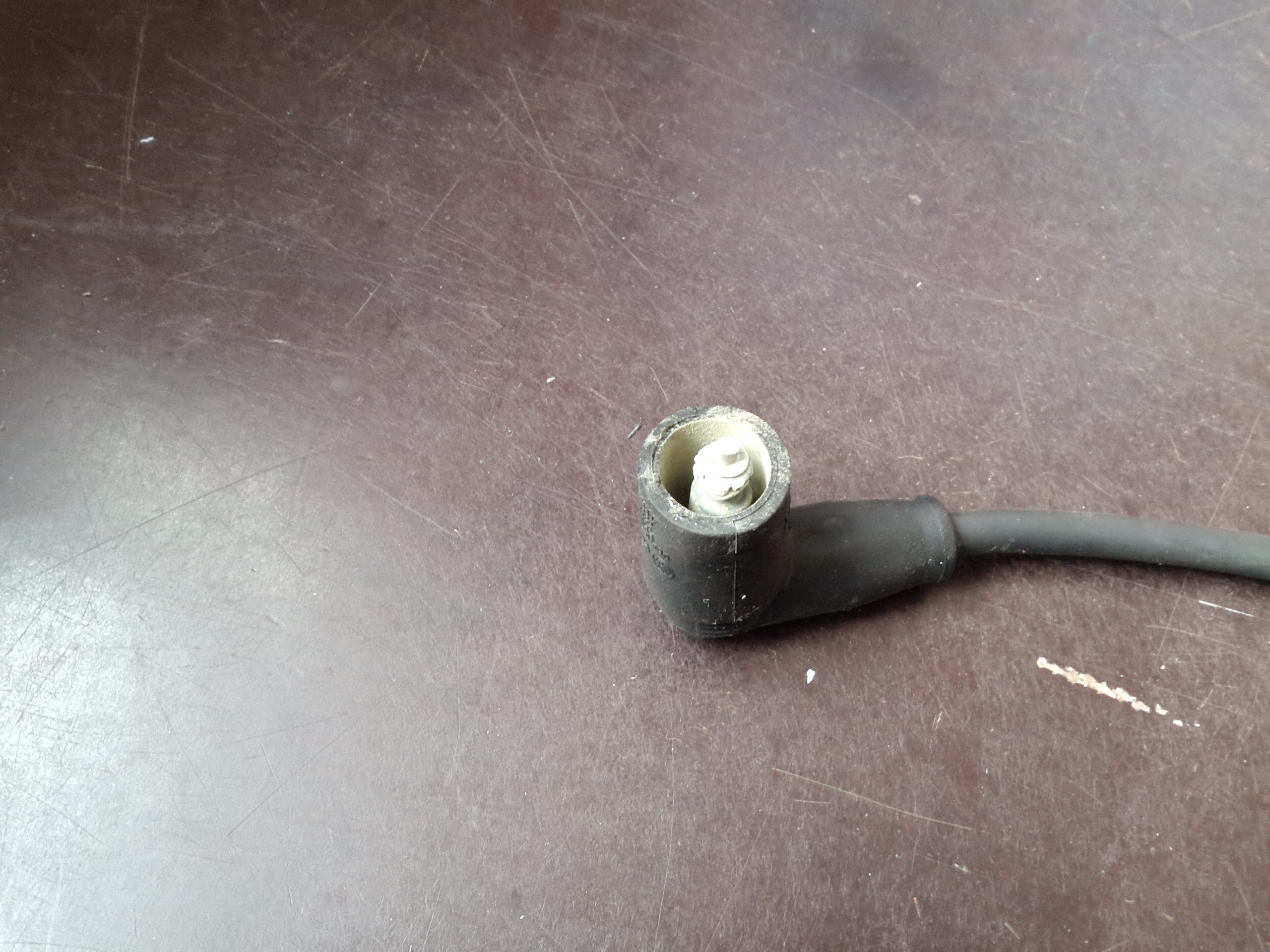

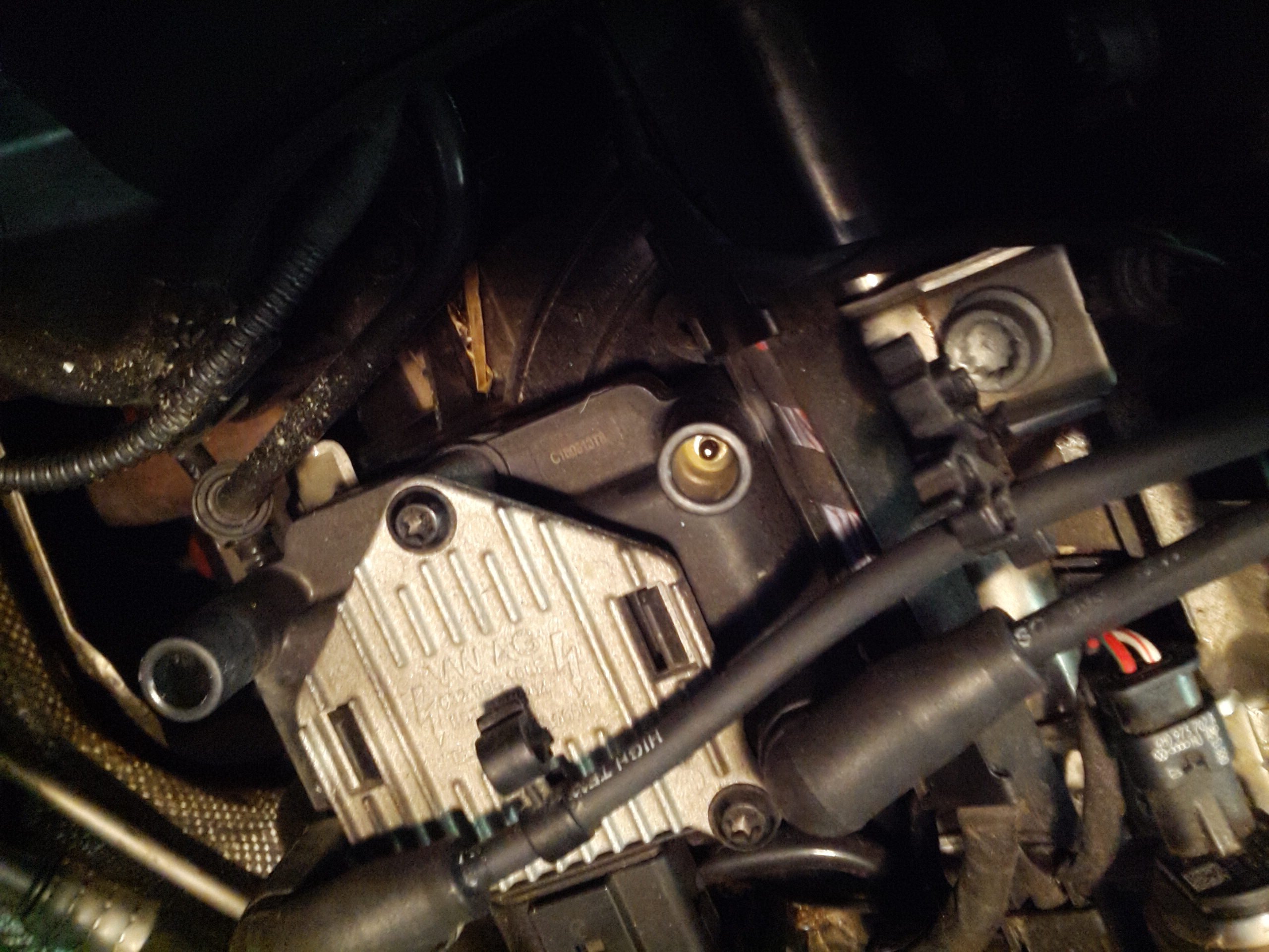

Ah haaah! When removing No3 plug lead from the coil unit  ( with difficulty as it was stuck ) I noticed white dusty residue. The other three were clen and like new.
Sprayed contact cleaner into No3 on coil unit and compared it to the other three, they all had a central pin but No3 had burnt away which was what the residue was.
NOW.....for my theories:- was the burning fault caused because No3 ignition lead was breaking down due to proximity to heat shield OR is it just coincidence that No3 on coil unit failed?
Any discussion welcome.
Photos from left:- No4 on coil unit is good, coil unit end of No3 plug lead in vice showing white dust, No3 on coil unit showing dust and missing central pin.
