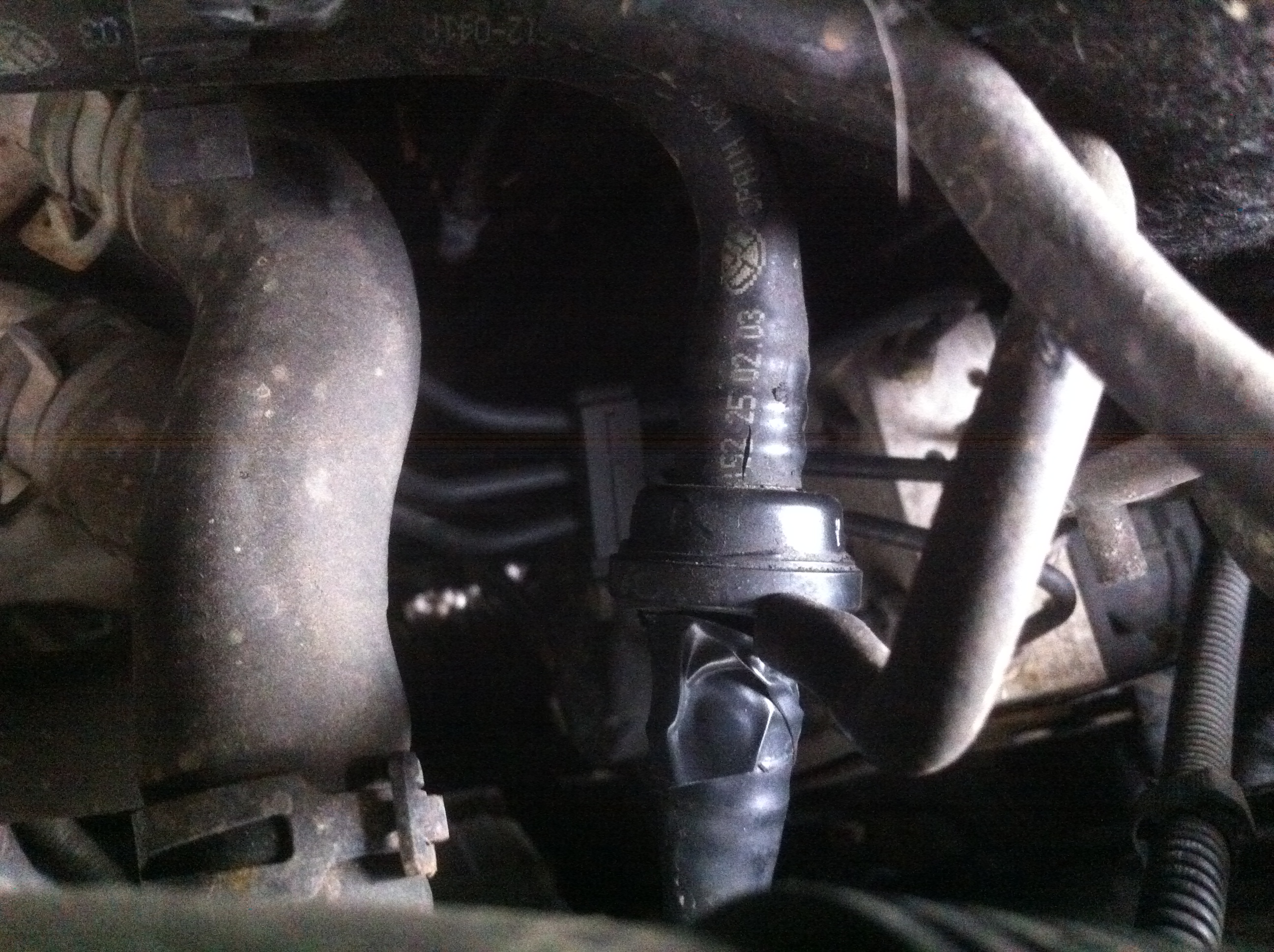

Hi Wino, thanks for that. It looks more like item 5 but the NRV has a small pipe coming off it that goes to a box, is that something to do with the ABS system?
Edited by Grimsby Ranger
picture added
I've wrapped a bit of tape round it for now (I know not ideal) and just seen from the photo the other side seems to be splitting so that's it off the road until fixed!

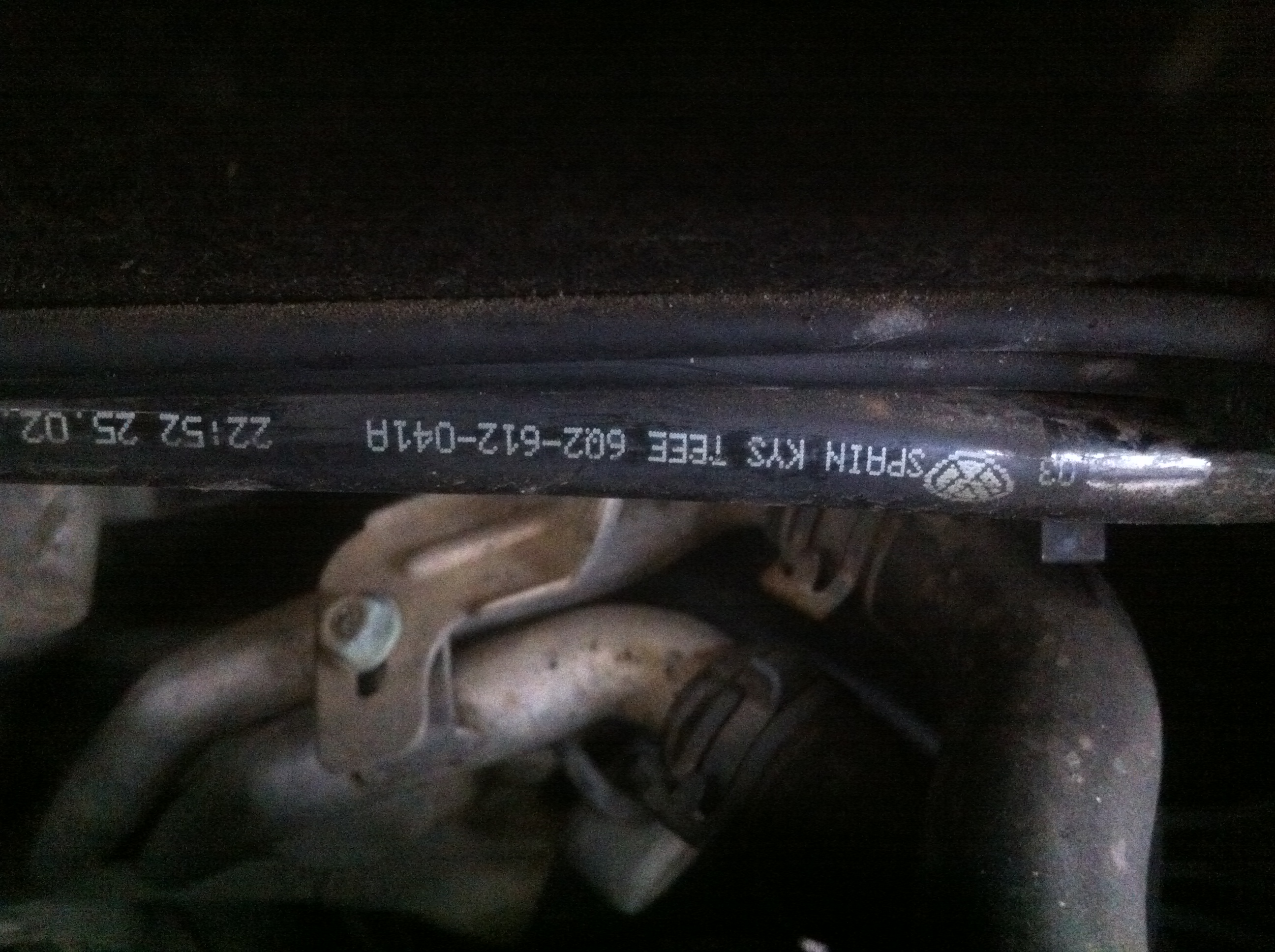

Can almost see the part number in that photo, right along the top edge, upside down on the hard pipe. Ending .....12 041 B something? Maybe the first item 5?
The smaller pipe is probably a feed for vacuum powered stuff like turbo and EGR valve diaphragms, not ABS. Is the box on the offside suspension turret?
Yes, the box is on the offside suspension turret and has pipes going to the EGR valve etc. so a vacuum feed as you say. Managed to get a better picture of the part number. Thanks a lot for your help. Looks like it's awkward to get to the end that connects to the servo.IMG_0568.thumb.JPG.20245f24c48b0e2e9401cfa3c0d0c617.JPG

Cool, the suffix A part has been superceded twice, now at 6Q2612041BS.
Correction, three times, now at suffix CD, I think.

Got the pipe, Audi wouldn't supply it so got my lad to get one from TPS in Lincoln. It was the CD suffix, will be fitting it at the weekend. Thanks everyone for all your help. Cost £31.06.
