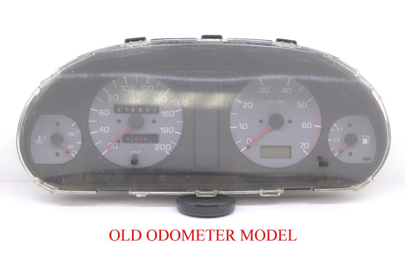

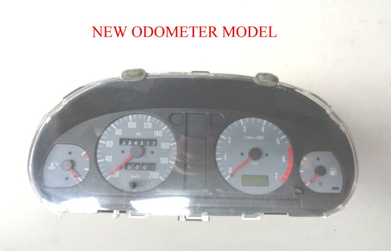

I can help only with some pictures.
Thank you.

It's possible to change the speedo from kph to mph by getting a new mph card.
In the OPs picture, the new instrument COULD be an mph one with a kph card.

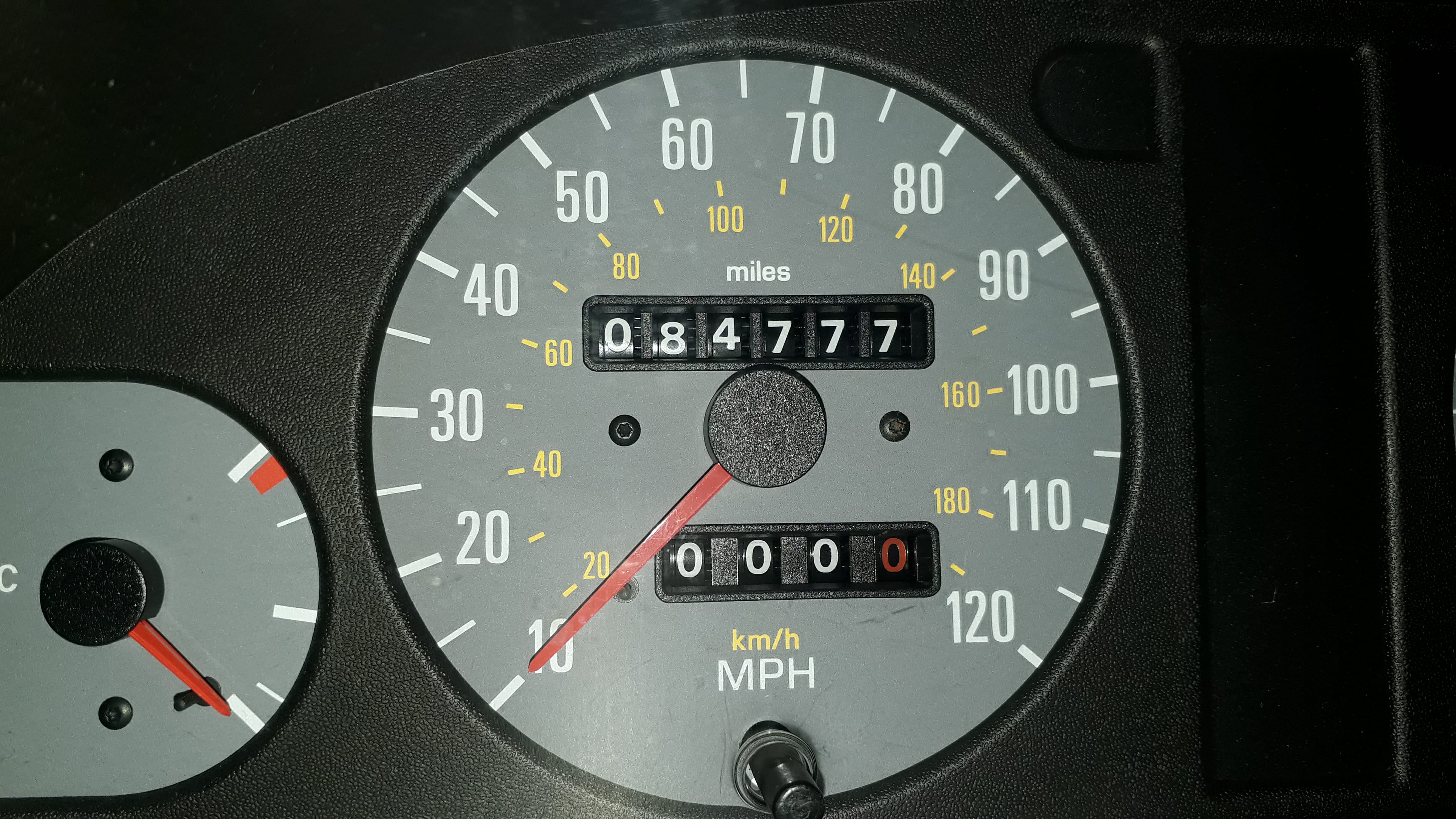

I'm also going to reference @RicardoM photo of the instrument cluster here.
The card immediately behind the needles is just a piece of printed plastic. What we're actually concerned with here is the mechanical system behind that which drives the odometer scales and speedometer needle.
Now the speedometer needle, irrespective of the card markings will move to the same place for a given velocity. For 50kph/30mph the needle will point to 9 o'clock regardless of what the scale card shows. Similarly, presuming the rolling diameter of the tyres is constant, tyre revolutions per unit distance will be constant. What needs to change for mph/kph calibration is the reduction gearing from the speedo drive to the odometer scales.
So, if you bought a complete cluster, someone has fitted a kph card with an mph odometer.

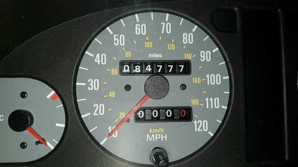

The speedometer will work the same for both a km/h only one and a dual km/h and mph one check out mine below thats a UK version. 5aa9a30367d8f_UKFeliciaspeedo.thumb.jpg.dfc9355075ca83c32d42bcfb97bfe311.jpg
As someone else said above at about the 9 o'clock position you get 30mph and 50km/h.
You can see how rubbish UK speedos look from this image, why they put the km/h on the inside when its a finer scale and needs more space than mph I will never understand, you could still read mph well enough if that was the inner scale. Sorry slight off topic, but its easily seen in this image.
