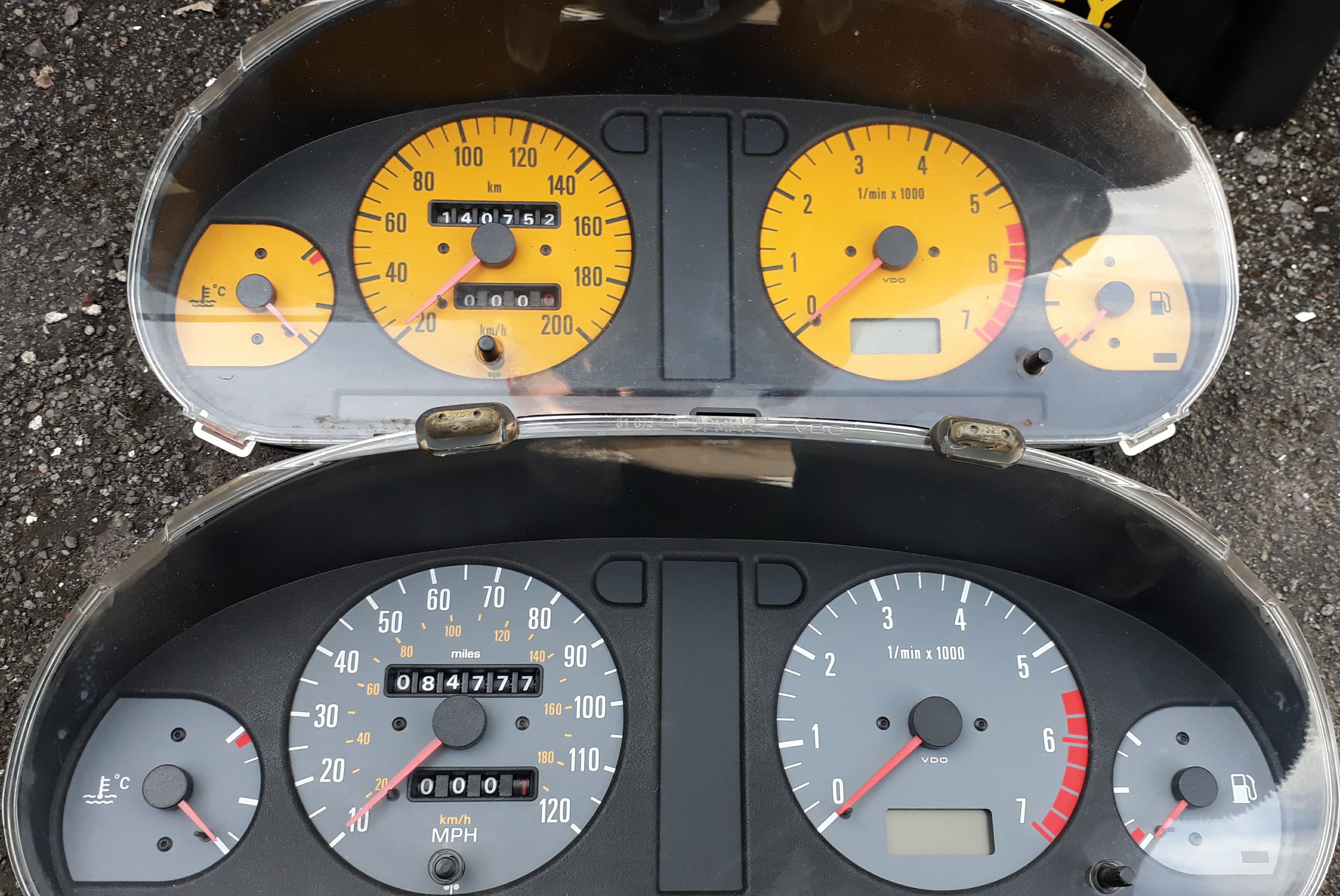

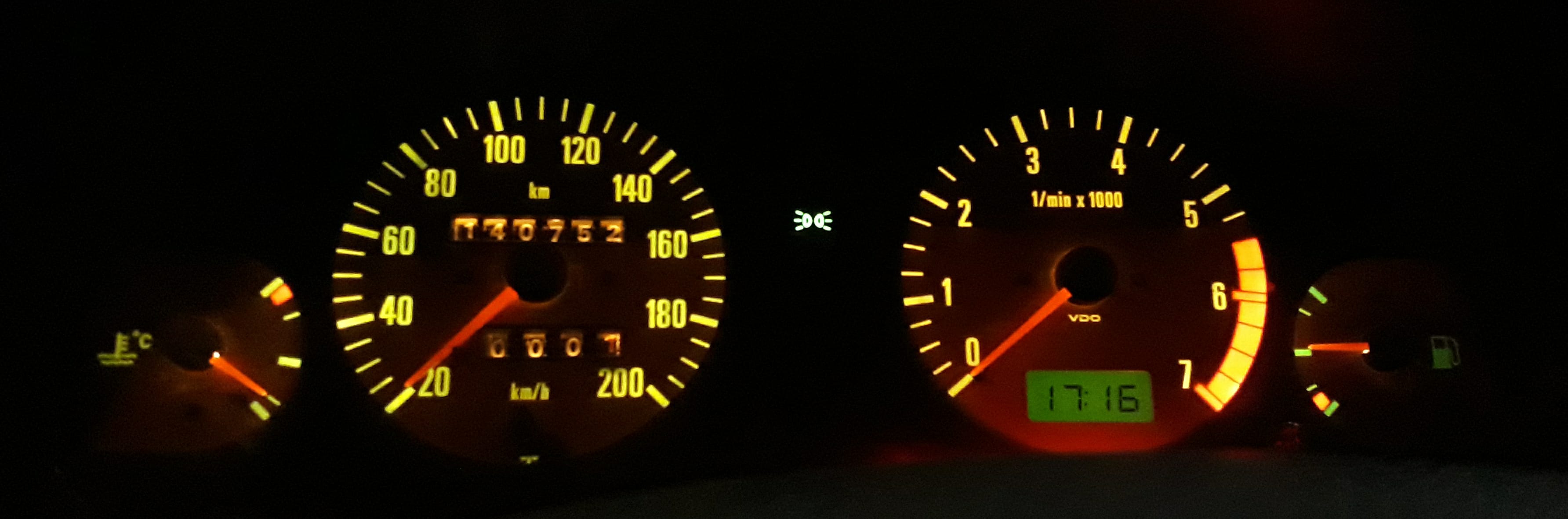

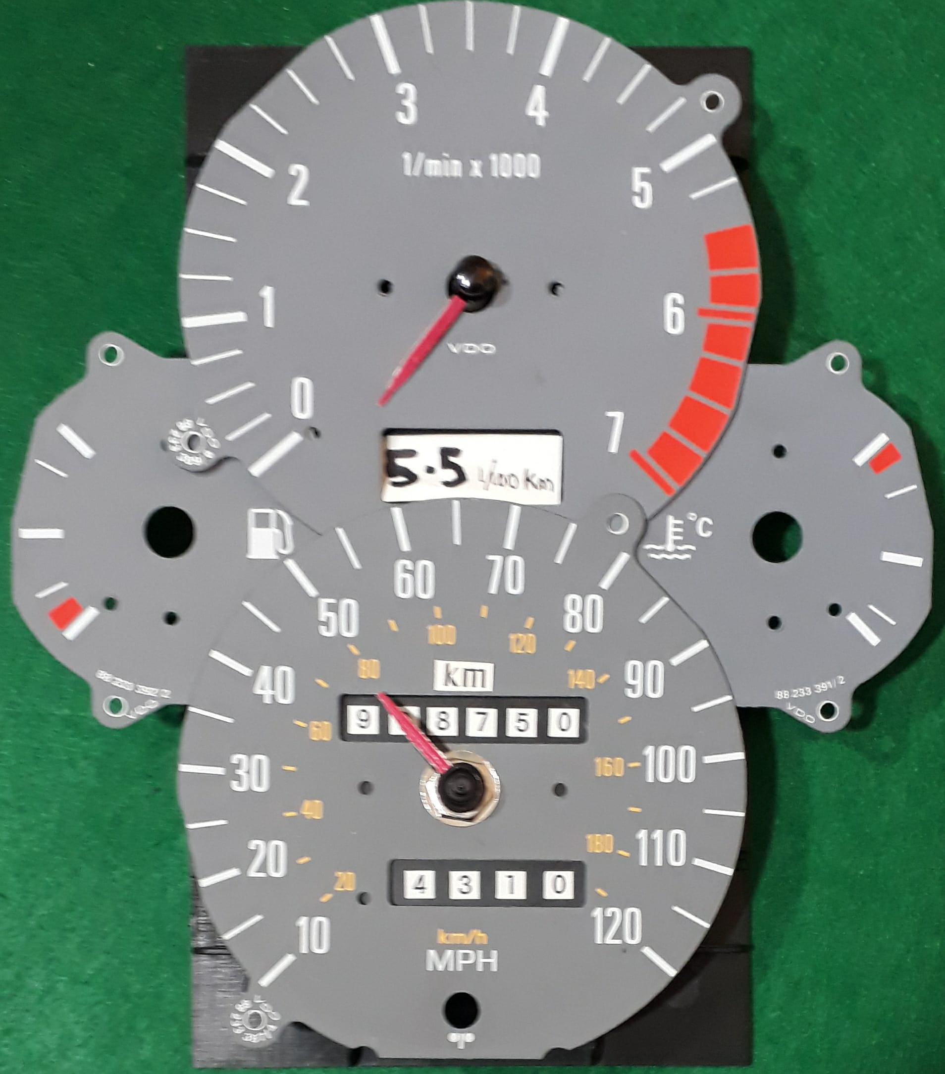

I did with my old one after changing my instrument cluster from standard grey to yellow fun truck style yesterday and made a clock from the plastic backings.
Yellow color looks nice.
Where did you found this color instruments or this is complete cluster?
It was a complete cluster and I found it on ebay by accident really. I was thinking I might not find the yellow and otherwise would have just got the speed clock in metric, it was just a good find though.
@lotrjw - Nice piece of crafting making the clock, and it does confirm what I've been saying all along that it's possible to put a km+kpm speedometer backing card on a km geared head (or vice versa.

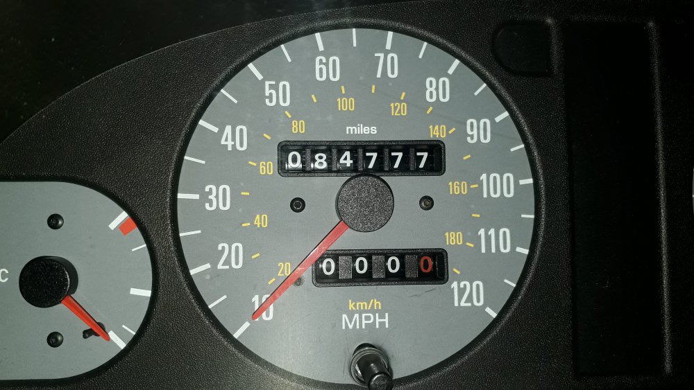

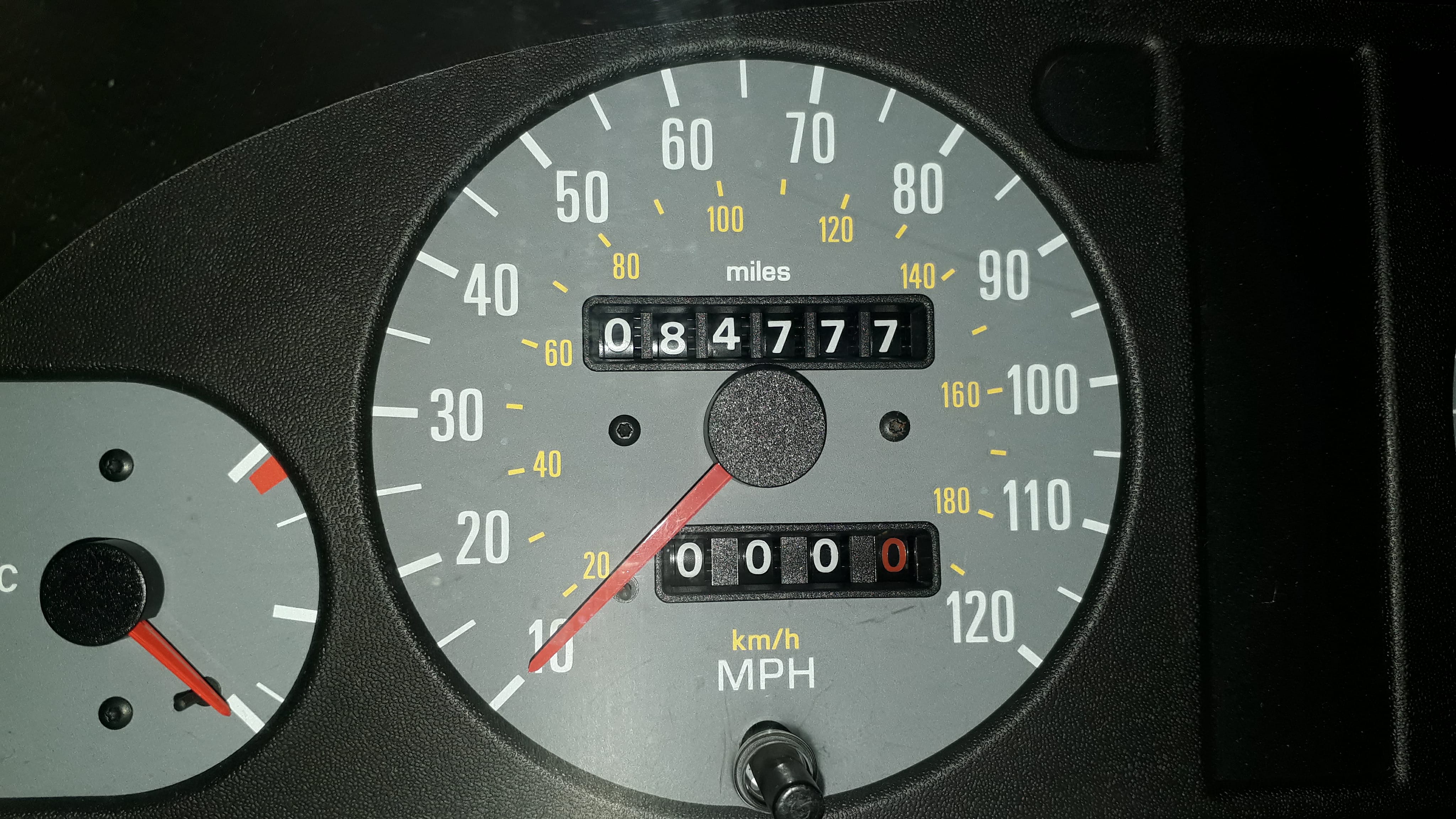

True, after changing them over and taking the old one apart, I was surprised with what ease I could access the inside of the ODO and change the numbers! As old one is now not used I took it back to 0 to see how easy that was.
You can do it the long way of winding it backwards using the white cog that goes in tenths, or you can sort of make it skip with a bit of effort, meaning that you can get the thousands and tens of thousands to move to 0 quickly!
Its then easy to put back together as if nothing had been changed, so its no wonder people 'clock' cars and knock off thousands of miles or kilometres if they think they can get away with it.
Im glad that the MOT records the mileage of vehicles, that way you can get an idea of if its been tampered with suspiciously and deceitfully.
I plan to let anyone who I sell the car too know there has been a clock change and show them a picture of the two clocks together that I took before fitting the new one so Im legal. I dont actually plan on selling the car though, but best to stay legal.

Whlist the needle calibration would be the same, the odometers would be different: the km would turn 1.6 revolutions in 1 mile.

I guess its all down to the metal circular think at the back of the speedo/odo mechanism? Anyway the speedo needle has to be the same on both, as it has to read  0-200km/h and 0-120mph in the same space. Also the UK one does both scales at once in a weird way.
