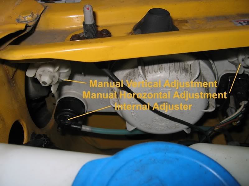

This model Felicia 1.6 GLX have rear light regulator with hydraulic fluid.
You probably see this function here on forum?

This Felicia model 1.6 GLX have internal rear light adjuster with hydraulic fluid. You probably see this function here if your car have no adjuster.
Here is the picture from this forum, take a look.
You mean hydraulic headlight adjuster. When you say "rear light" that means the light is situated at the back of the car...
OK, that installation fails after a few years. That is not a reason to condemn the whole car. Especially when you can buy an electrical headlight adjuster kit.
I would complain more about the 1.6 engine and gearbox. Heavy engine, low power for its capacity.

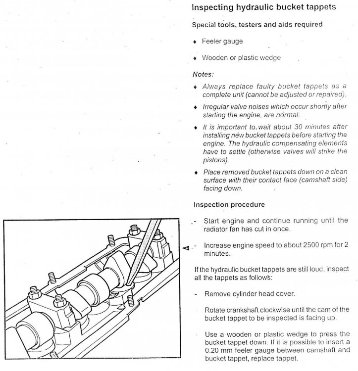

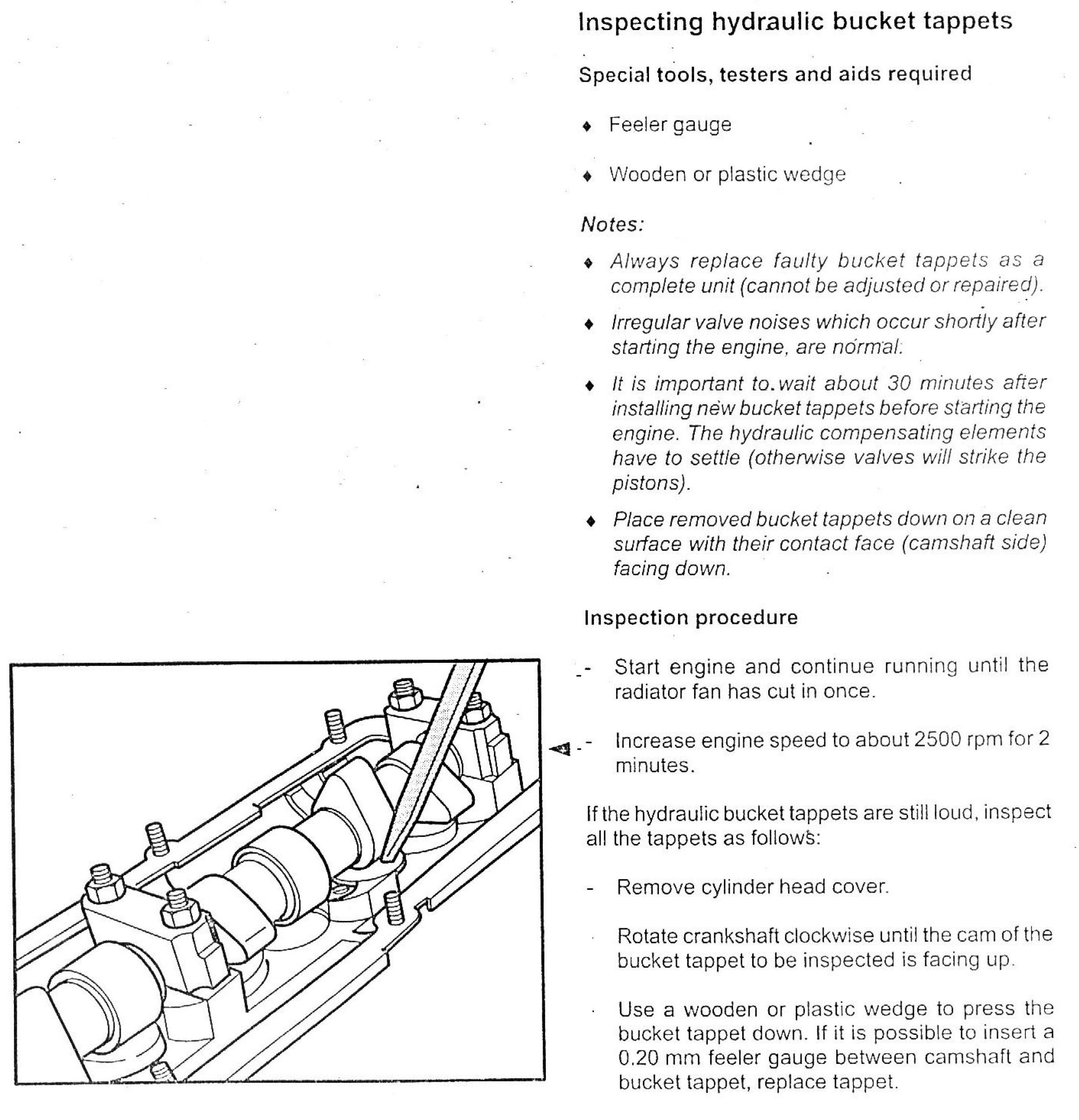

4 hours ago, Johnglx said:
Valves are auto adjusted is that so?
You mean the valves clearance. Yes, they are self-adjusted. Yet the bucket tappets can develop play,
