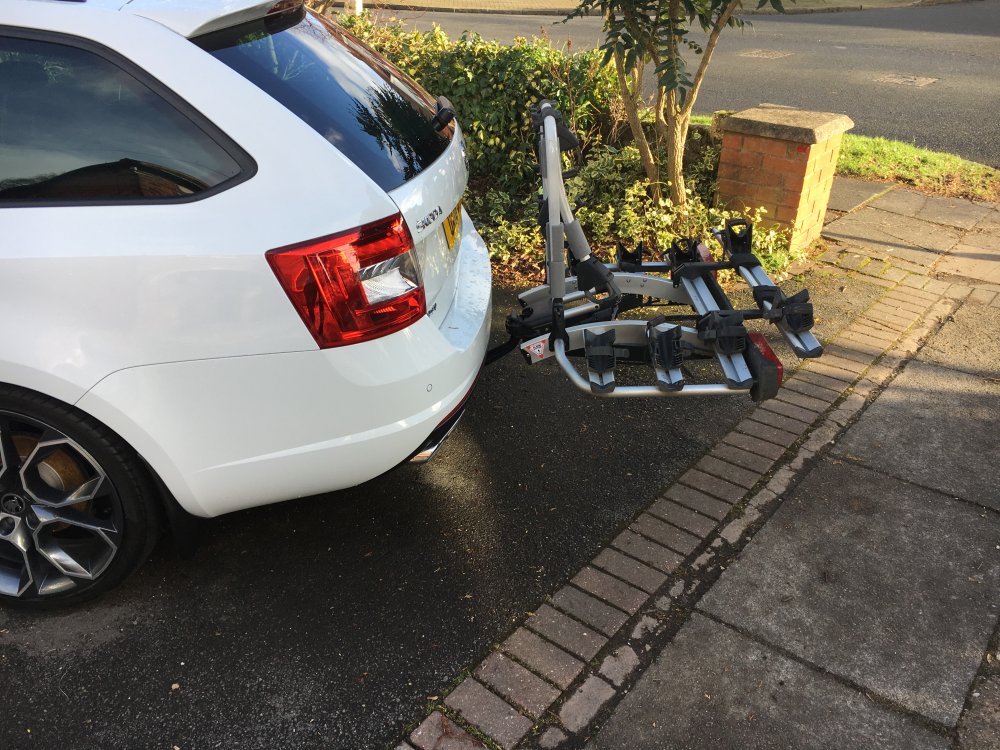

I have used a towbar mounted rack on two Octavias. Currently got an aluminium Thule rack, no tools required to mount it and has integrated  lighting and easy drop down to access the luggage  area via a foot pedal . Not cheap however, but easy to mount and securely attach bikes.
Down side is that the mpg is well down. 30% or so at motorway speeds. I speak from experience and would recommend this way of carrying bikes.
