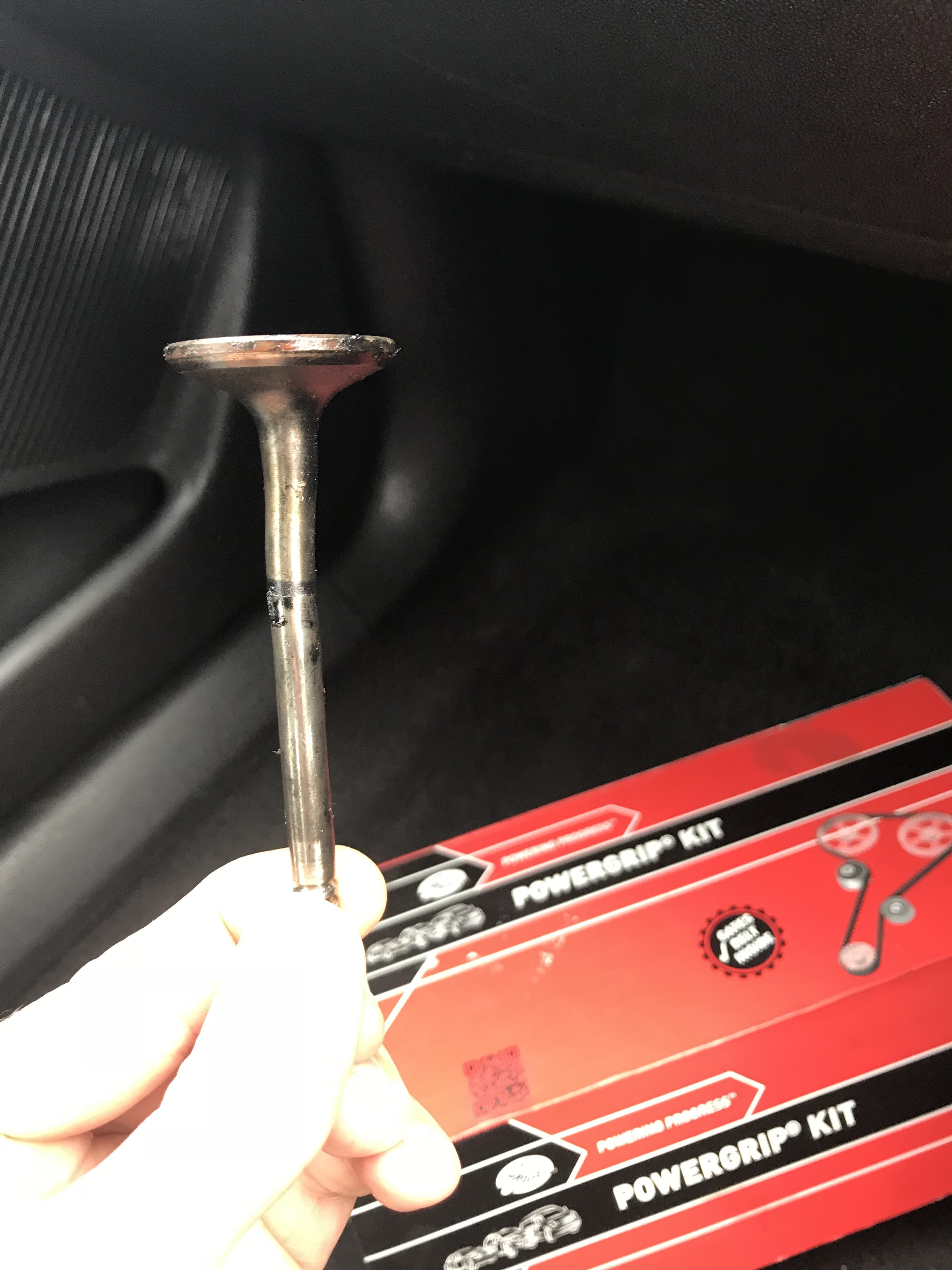

Whilst I’m at it..... anyone know the cost of changing all the valves?! (Not expecting an answers to this :tongueout:)
No difference, they're the same engine.
Guesstimate for the head job is about £150 for the valves and seals, then labour for recutting the seats and a truth skim about £200, that's inc. VAT and assuming you've removed and stripped the head already.
Then labour, gaskets, cambelt kit, water pump and all bolts to reassemble.

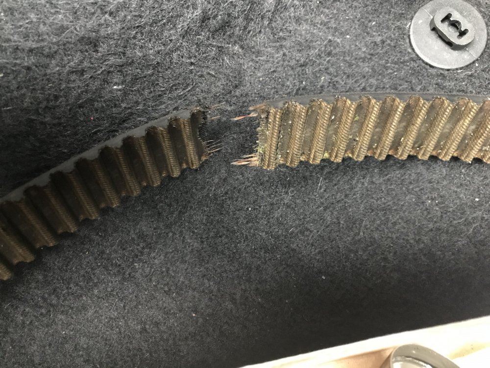

Still debating with the garage what the service time is for the belt .... they’re insisting it’s 5yrs/80k??
This is what the belt and one of the valve looks like ....

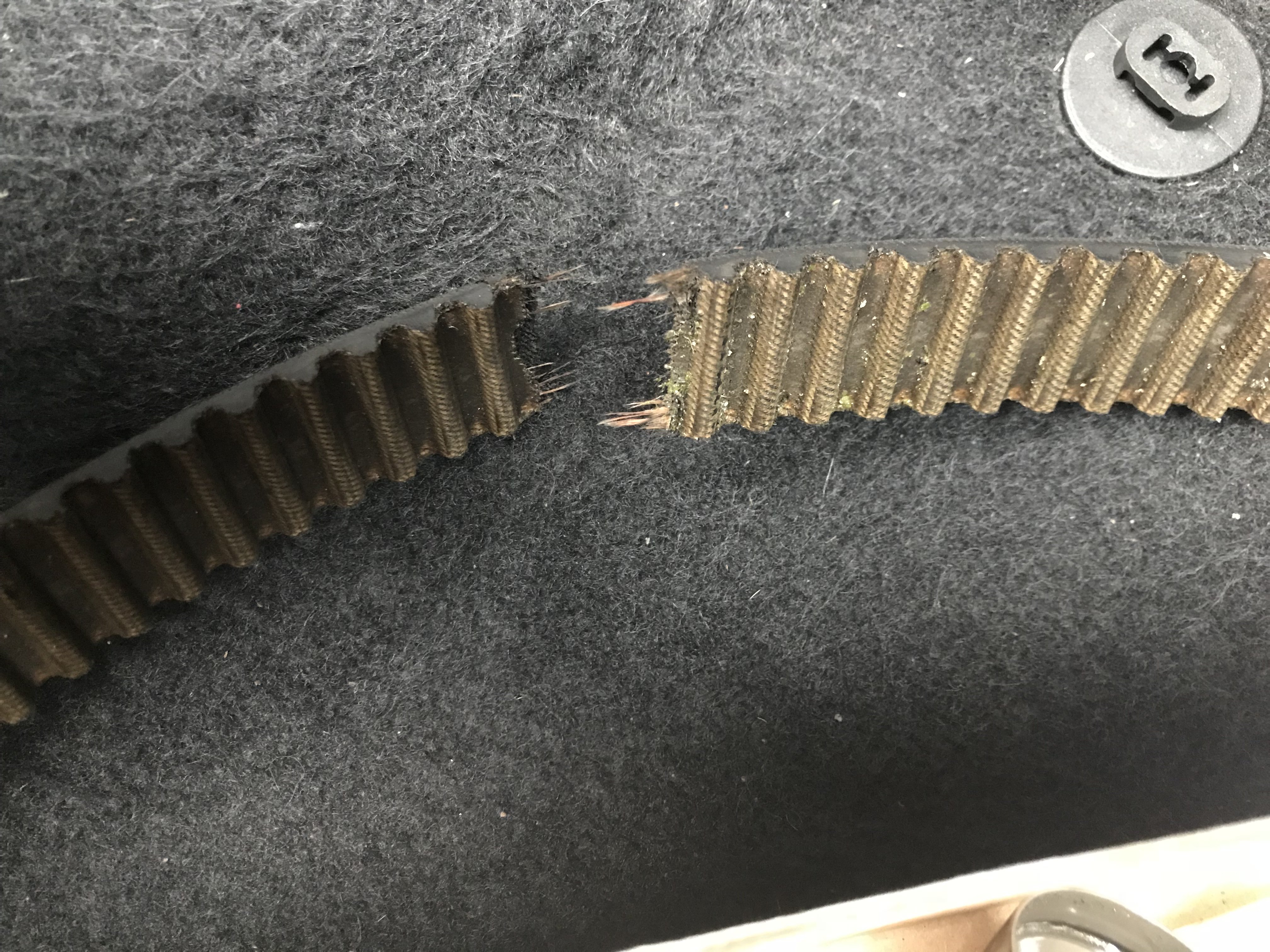

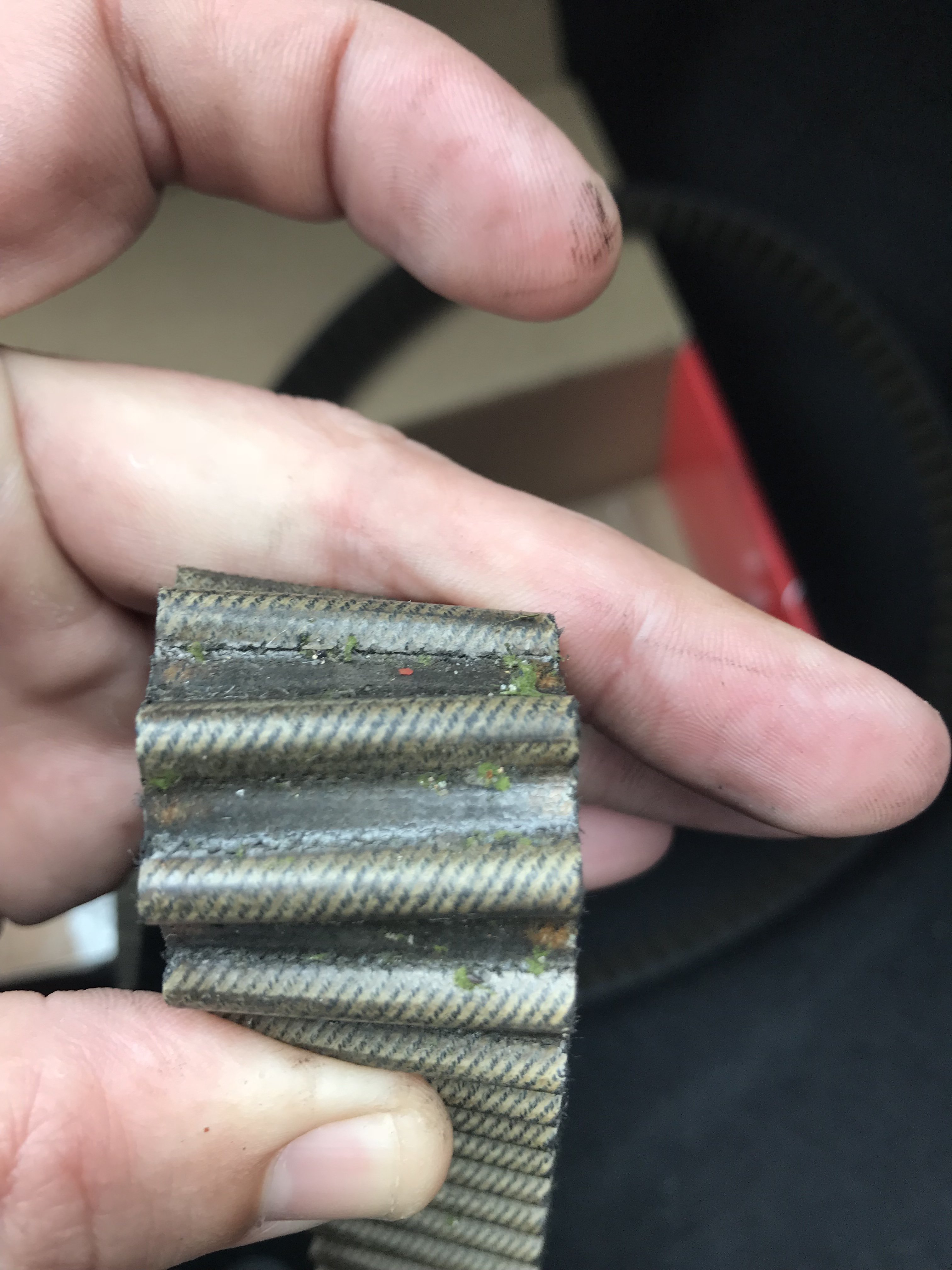

Incidentally, is that MOSS growing in your old cambelt, you really need to drive that thing a bit more, no point in owning a diesel if you don't do the miles.

Whilst I don’t do astronomical mileage, what I use it for is fine. It’s used every single day and very rarely started without getting up to full temperature. (literally only time it’s not used every single day is when I go away with work or holiday) and gets a good motorway run every month.
Is it moss and where has it come from? I dunno, but will ask when I catch up with my mate to talk finances.

I've seen plenty, PD's are VERY hard on cam belts because the belt is also providing the energy to compress the unit injectors, you don't see that many on here because this forum is very proactive in persuading members that changing it on schedule is essential.
At a tuning firm with a machine shop I briefly worked at back in the noughties taxi drivers brought in a steady stream of VW PD, Ford Zetec and GM Ecotec engines with wrecked top-ends because they wouldn't maintain them on schedule, they always thought they could push 'em a bit further and they always went BANG! with no warning.
