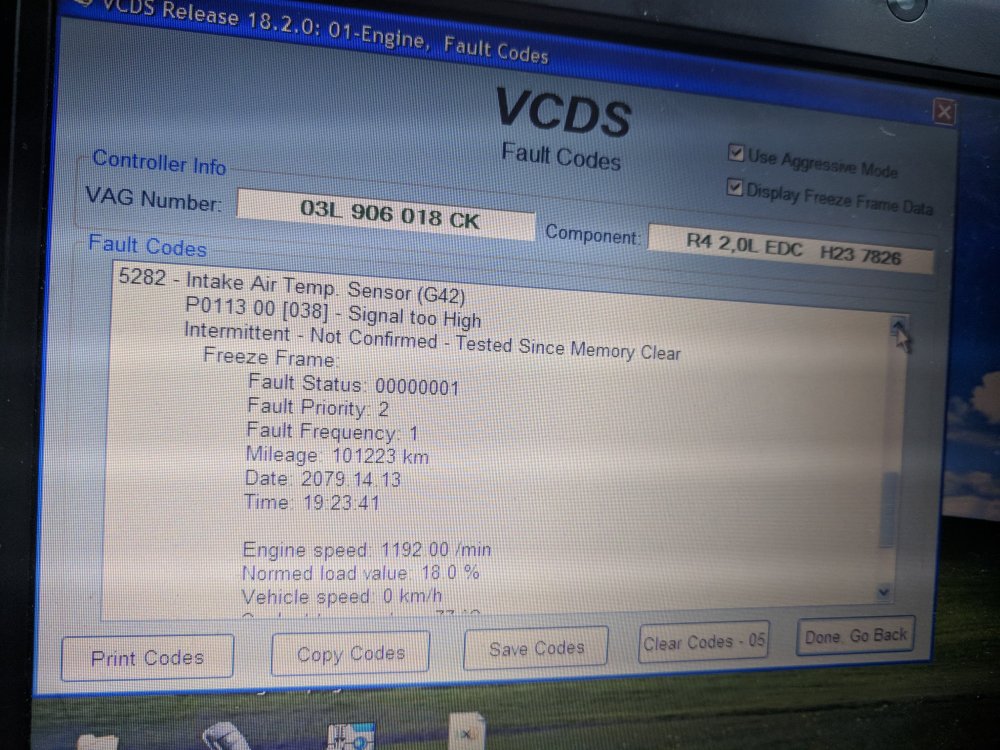

Hi i have a 2011 skoda superb 2.0tdi 170bhp and the car goes into limp mode with check engine and the glow light on.  have had it on VCDS and it  came up with
5282 - Intake Air Temp. Sensor (g42)
P0113 00 (038) - Signal too High
Intermittent - Not Confirmed - Tested Since Memory Clear
Freeze Frame:
  Fault Status: 0000001
                    Fault Priority: 2
                    Fault Frequency: 1
                    Mileage: 101223 km
                    Date: 2079 14 13
                    Time: 19.23.41
and
5169 - Manifold Pressure / Boost Sensor (G31)
               P0238 - 00 (167) - Signal too High
               MIL ON- Not Confirmed - tested Since Memory Clear
             Freeze Frame:
                    Fault Status: 00000001
                    Fault Priority: 2
                    Fault Frequency: 1
                    Mileage: 101223 km
                    Date: 2079 14 13
                    Time: 19.23.41
can anyone shed more light on these code please, as what could becausing this.
also is it an easy fix? expensive?
help and advice much appreciated

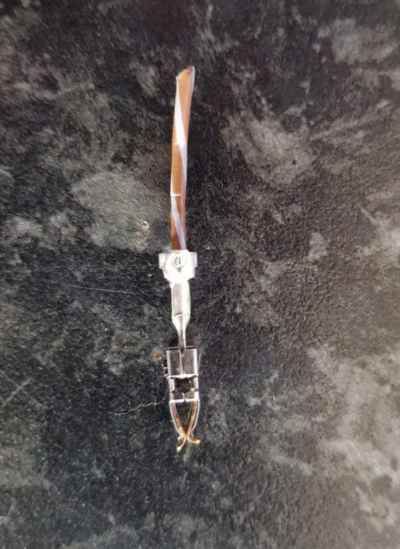

It was this broken  wire on the air temp  sensor
is that air temp sensor on the end  of the wire? as it looks diff to MAP sensor/air temp sensor?  or where exactely was it?
not sure to be honest, think it looks more just like a connector
