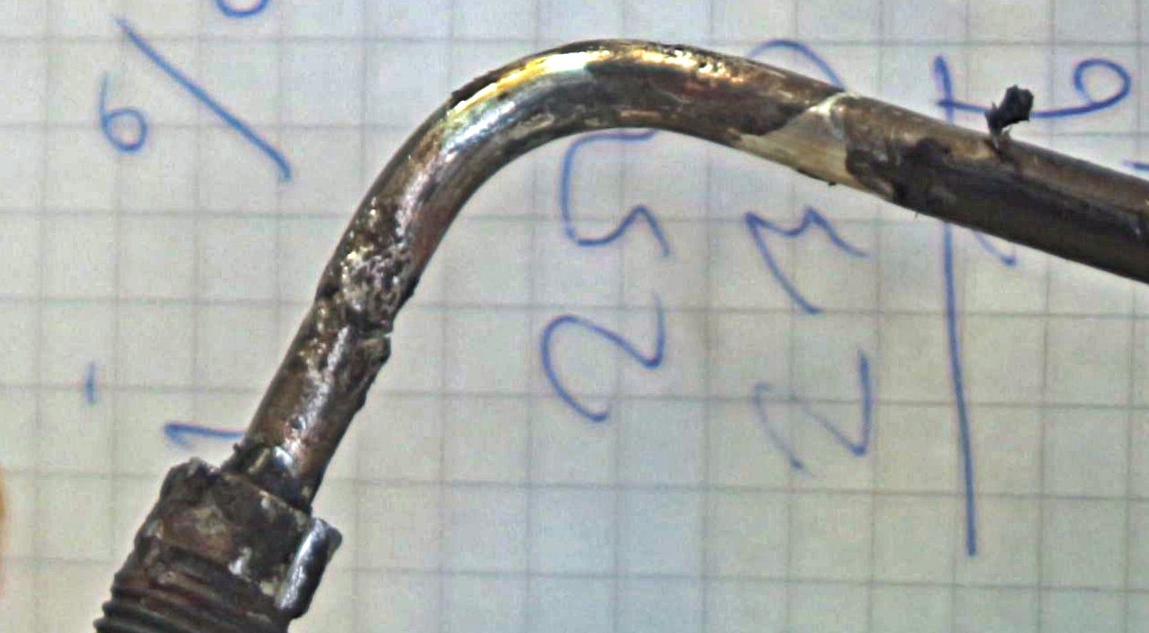

May be heck the brake pipes? I had to change on the left rear, and brake tube to.
