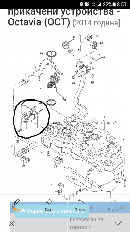

can anyone tell me what is surrounded by black?
and what is the scheme of the vent?

Hello, I disassembled the backbone today and released the well of the lawn to get to the vent, and I realized it was not a vacuum but a pressure, the vent only works in one direction, that is, when the car is overturned in an accident, it prevents fuel leakage type vent can only be obtained pressure and vacuum. Greet friends.
