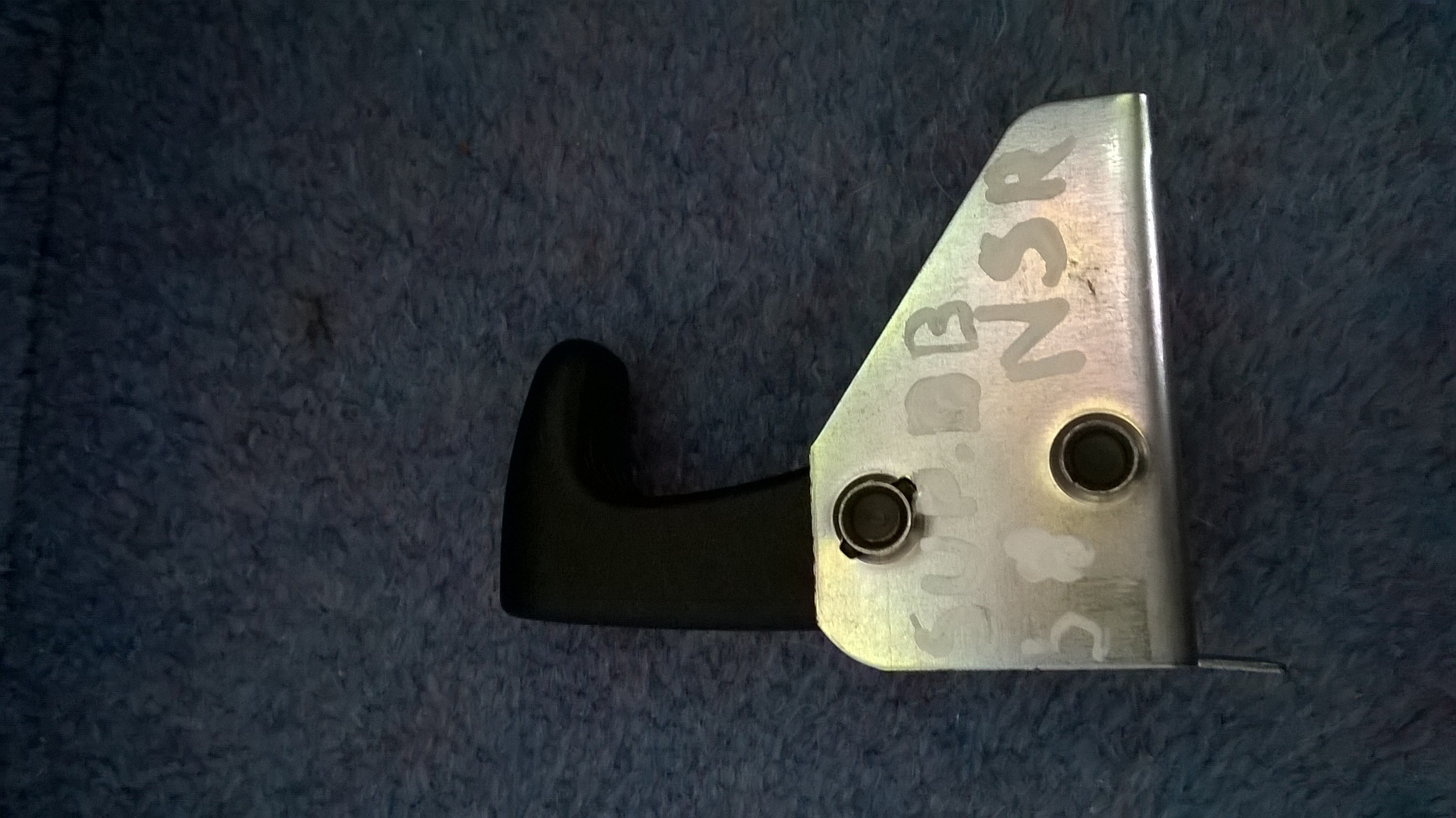

If you want to fit curry hooks to a base model Fabia, you need Torx  T25 and T15  screwdrvers, Allen keys, large flat blade screwdriver and the curry hooks themselves. I didn't investigate the dealer for curry hooks , although it is usually worth enquiring as some things are surprisingly cheap. I got mine from fleabay £15 for the pair, posted. Search for any model as they are common throughout the range. One of mine is marked up as a Fabia item, one from a Superb.

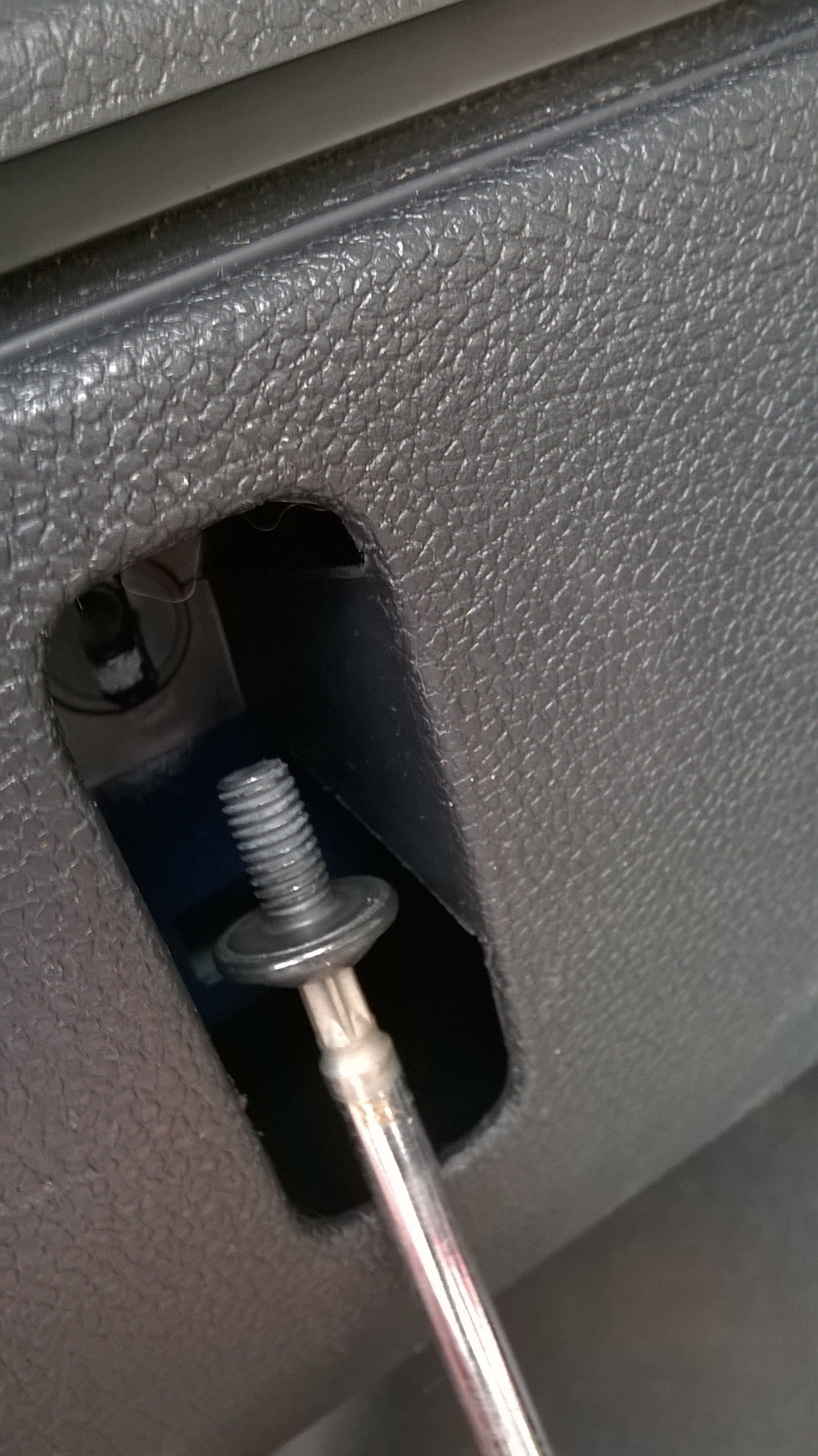

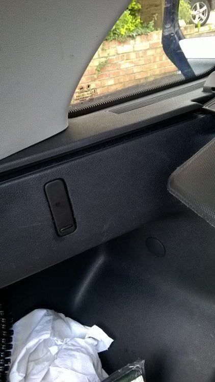

Take out the rectangular blanking plates to reveal the fixing bolt and undo it with a T25.

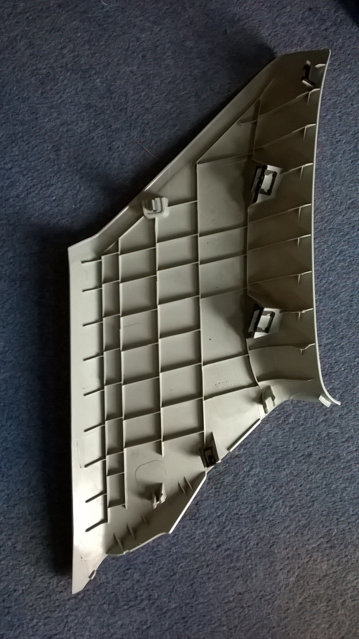

Pull off the tailgate aperture seal and remove the D pillar plastic trim by inserting a wide bladed screwdriver at the bottom and, using a rag to protect the car, levering between the  plastic trim and the bodywork. As you do this all the clips securing the trim will become apparent the further you ease the panel off. The  picture shows the back of the trim to show  the clips and fixings.WP_20180423_09_21_05_Pro.thumb.jpg.37c191a320c3234a5d2398d6c97c21db.jpg

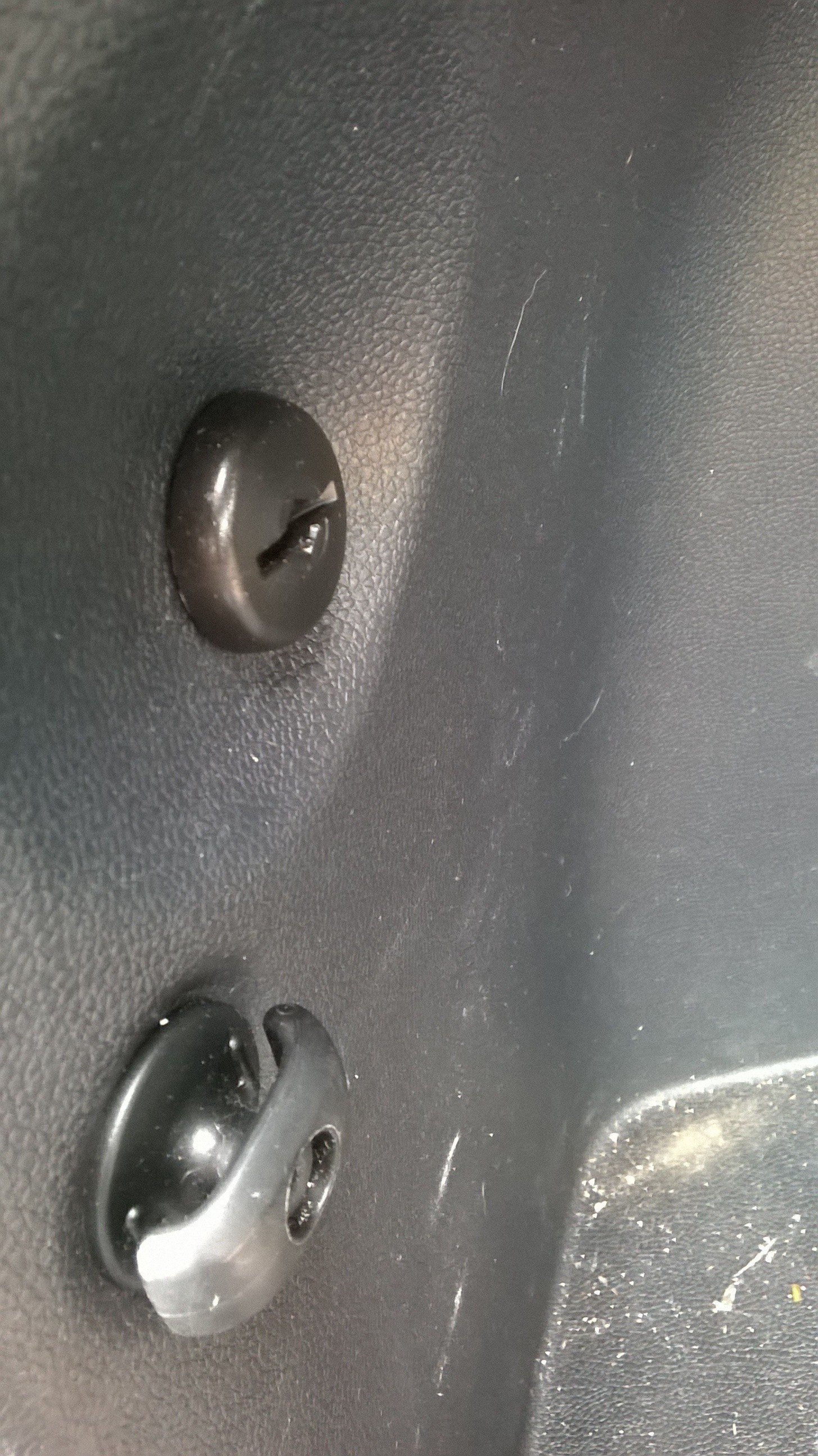

Now remove to plastic rivet holding the side trim to the trim below the tailgate latch by levering the centre out with a screwdriver then levering the rivet itself out. Now remove the plastic bolt securing the tail light( undo with a 2p peice or an Allen key) and the luggage net securing hook (T15 screw) below it

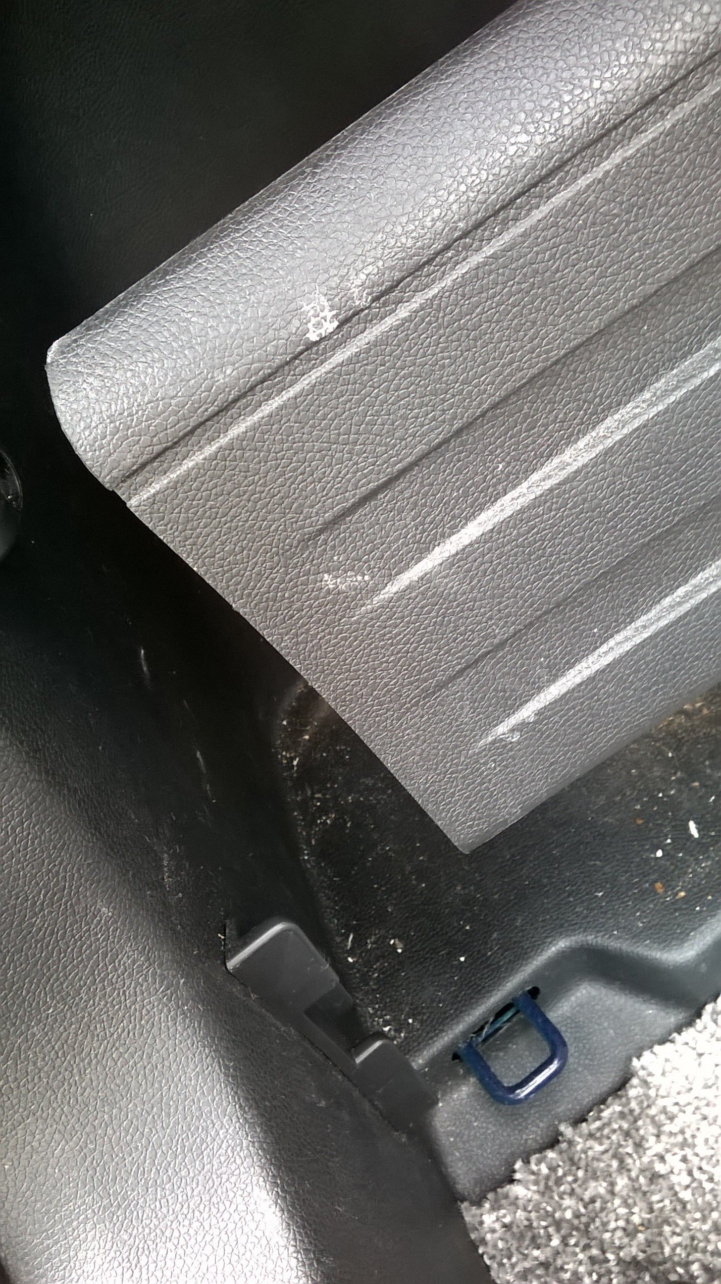

WP_20180423_09_43_34_Pro.thumb.jpg.171e8d5cd2d5be93e05991c6aeb7ead2.jpgRemove the vertical panel forming the storage compartment at the sides of the boot, if fitted ,by pulling sharply up to make the whole side trim panel more flexible.
There is a section at its top rear edge normal covered by the D pillar trim which will need to be eased out with the screwdriver and this allows you to pull the side panel away enough to get your hand in. You can manoeuvre the curry hook in behind the trim and line it up with the hole left by removing the blanking plug. The metal component of the hook goes behind the formed plastic of the trim panel  and the hook part should be in the 'down' position.
