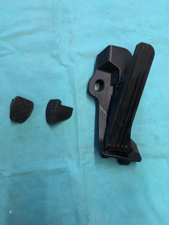

If it helps i changed my accelerator to the stainless steel one off superskoda. So i have the original in the box and i would happily sell to you and post if needed. It works perfectly fine

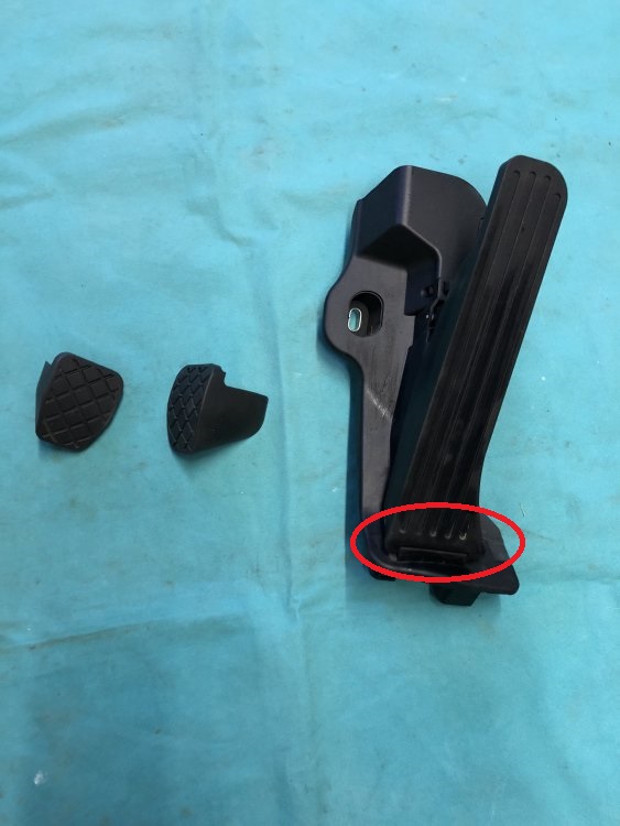

I find it hard to believe that a stone could cause this damage the pedal which is/was very well made ,I just hooked my spare one out from when I replaced it for the metal ones when I first bought the car
@Sad555
Mine is cracked right at the base of the pedal where it pivots, borrowed your pic!

I neither have a hefty boot nor does my partner, if there had been a stone in there we would have felt resistance or even heard a crack as the pivot broke. We didn't , just a gradual sense of pushing pedal and nothing happening, then a sudden surge, this was due to pedal leaning to the right and  not engaging properly, when looked at you could see it leaning to the right, that's why I took it in. As for checking for stones every time we enter the car, I couldn't find anything in the handbook referring to this! (sic) The car is cleaned and vacced out every week and we don't wear heavy boots! The fact that someone got it replaced under warranty also suggests they know about this. I still think it could have been designed better.
When I looked at the pedal after removal there were no signs of a stone or other impact marks on the inside of the pedal, so who know what caused it, fatigue? All manufactured goods don't always have the same reliability, there are some that get past  quality inspection at times.

Well it wasn't a barb, just couldn't see how a stone could cause the hinge/ plastic to crack. Whilst I was on my knees, I tried a stone and found it near impossible to get one in there at all, enough to cause a restriction in opening the throttle.

Just what I said about a stone when looking at removed pedal, no sign of damage on the inside of pedal.
