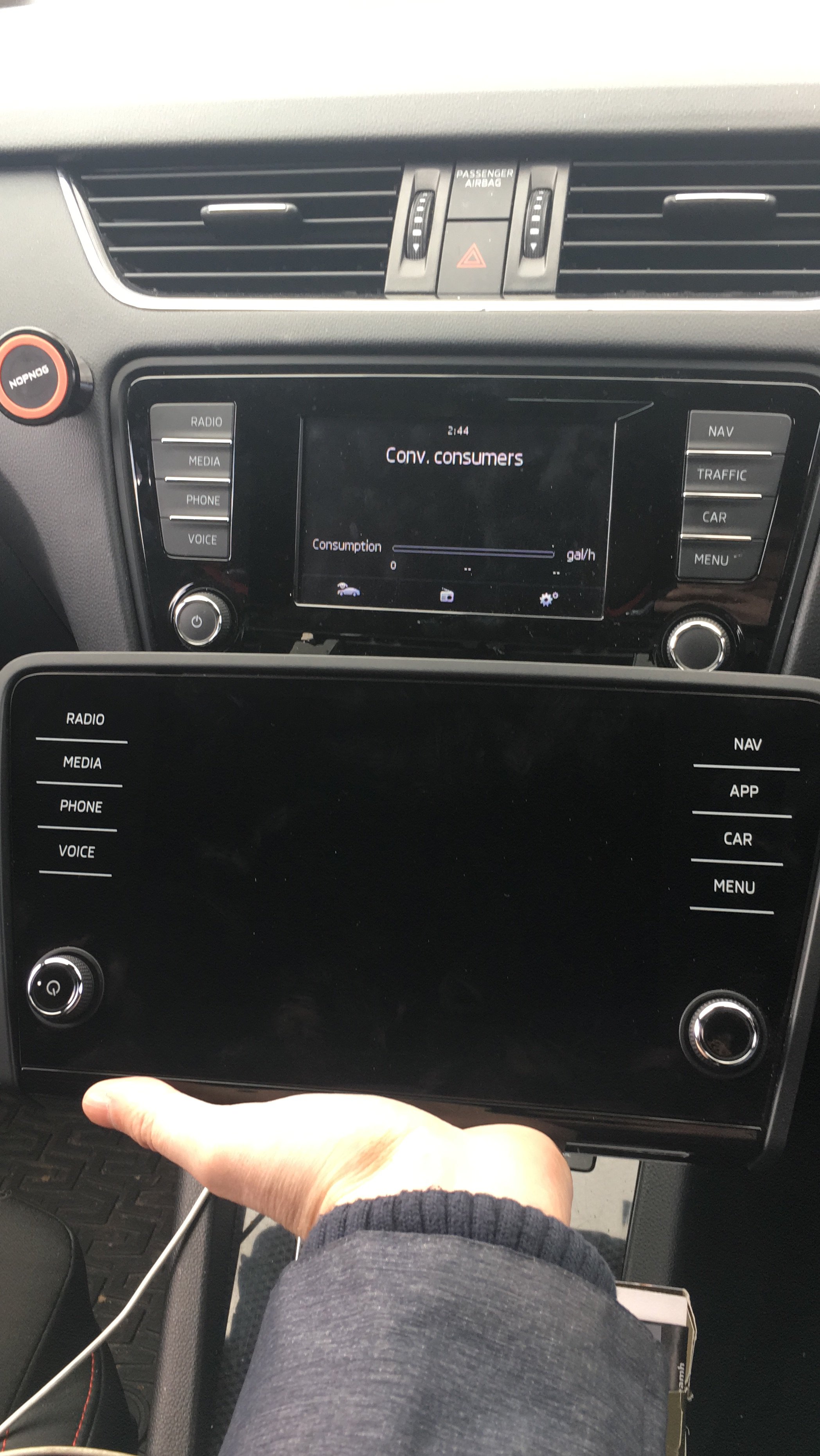

My FL screen arrived today! like @SashaGrace says £200 would be the going rate also the lighting is white not green like the pre FL you will need the shave a bit of the male plug to fit into the female connection but nothing major
Plugged it in with mib1 unit but due to res diff I only get lines , mib 2 unit next week happy days
