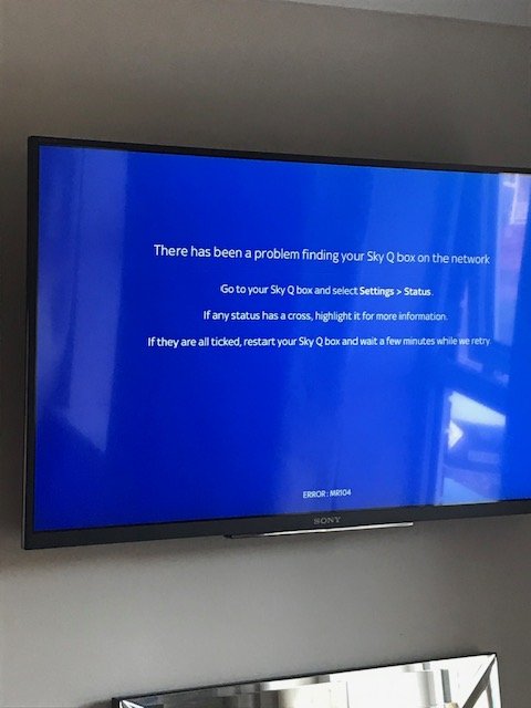

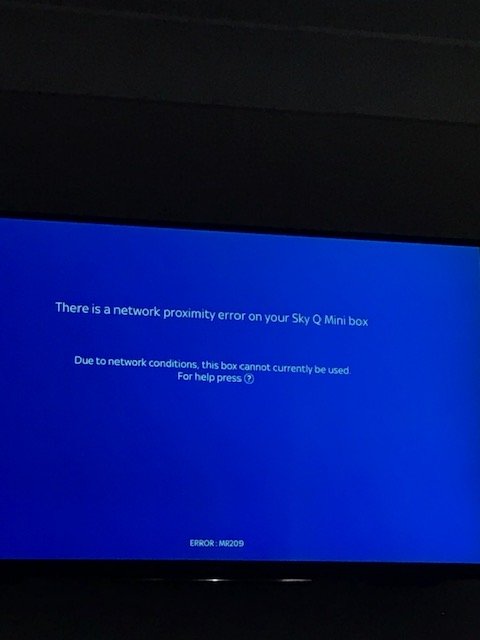

Every morning we have a connectivity problem with the mini box in the bedroom. Not just occasionally, virtually every morning it shows some sort of freakish behaviour ranging from not connecting to the network,  to trying to play a recorded program and freezing.

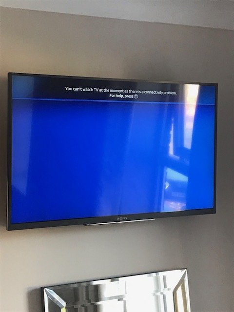

And it's failed again, mid afternoon. Along with the main box which crapped out stating it failed to connect to the internet. Quite why a failure to connect to the internet would bomb out a satellite feed I don't know, but then I guess Sky don't know either...
Currently the mini box is showing this..
Meaning the two boxes are connected and working on mesh, but our home network has failed. So now when the mesh fails there's no back up network (home wifi) available to fall back on, and the system will stall. Yet whenever we contact Sky they just try and fix our (admittedly poor) wifi connection. In reality they should be making sure their own network is stable enough to function correctly
From that photo I'd initially think that you were connected on your home network but that wasn't communicating to the outside world.

Nope, that's not correct. The boxes are connected on their own network, but are not connected on my home wifi. Home wifi is working fine (laptops etc. all connected and working), router is fine, everything on my broadband & wifi is working okay except the Sky system, although it's still working on its own network.
