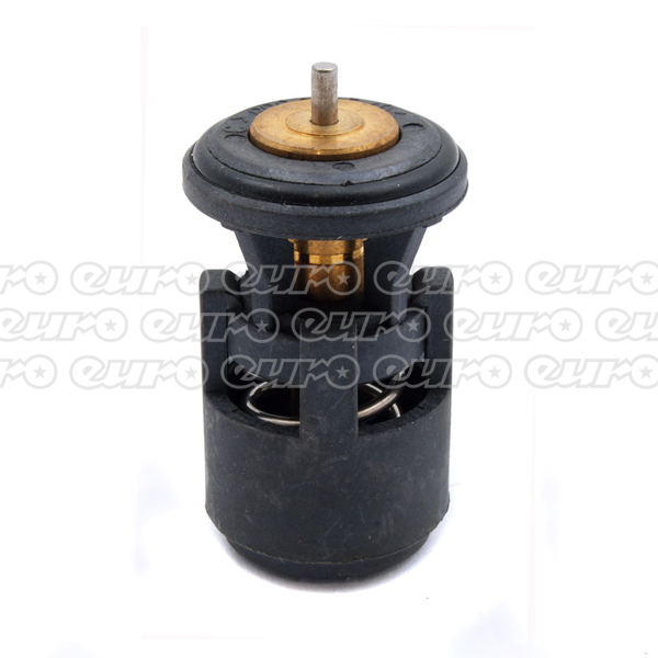

209440210.jpg.103d8832e983d4cc363a4ada5309fd52.jpgIS this the right thermostat ?
Quote
1 hour ago, sepulchrave said:
AUB has the thermostat that looks like a black plastic shotgun cartridge and it's much more expensive, it also has the two-wire ECT sensor, push-in type, radiators are all the same as long as you get the one for use with aircon.
Yes it is.

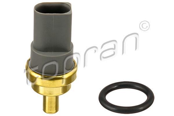

thumb.jpg.47b4f67efa6f6ab1840fccf94cfc2d03.jpgWould this one be the right ECT sensor ?
Also yes, as long as it has two pins not three.
Yes it has two pins not three. Thanks for the help greatly appreciated.
