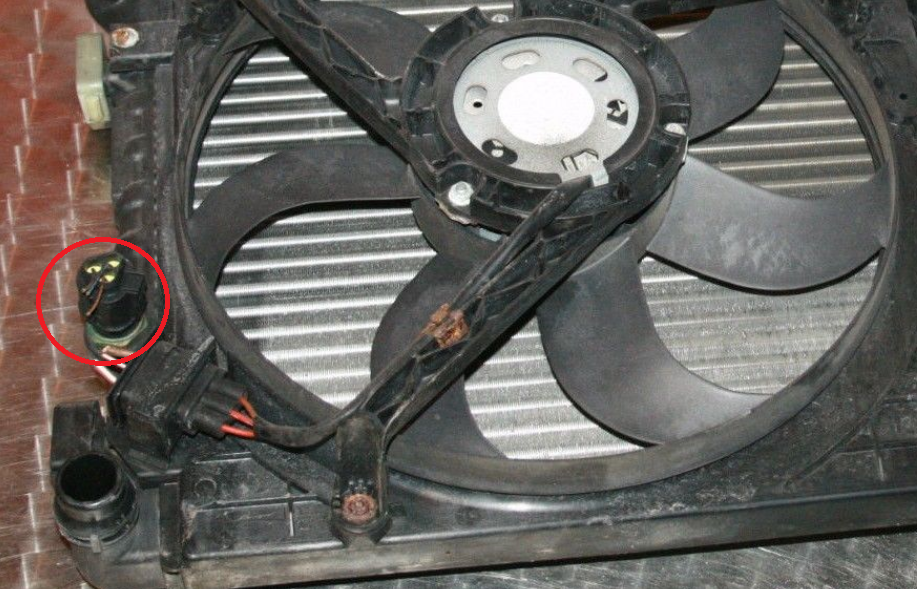

With undertray removed, have a close look at the radiator thermoswitch (circled in this pic). Common source of leakage.  I know you said driver's side, and this isn't, but well worth a look anyway.

Ok I will check later today and update.I know the dripping only starts when I top up the coolant and it gets  midway between the min and max levels on the header tank
Took top off header tank and the dripping started on drivers side I checked the area in the photo and it's totally dry on all that area and along the bottom  until where the dripping is.
