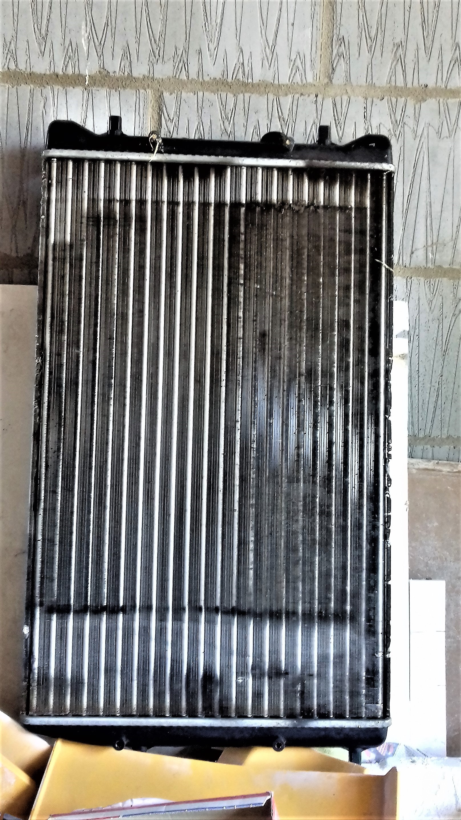

Hi yes I put Seal it in and it did work to begin with but the leak has got worse so unfortunately rad needs replacing now.
Make sure the systems is drained and flushed to get rid of the seal - if you have air in the system it can block other things , such as the heater matrix ( I speak from previous bitter experience!)
Also make sure you also replace the "O" rings connecting the radiator - these can be a leak point post radiator replacement. Also depending on the fan sensor be careful not to overtighten!
I've just had to replace the rad on my Octavia I which was a pain in the ar$£ . As the car is 17 years old two of the mount bolts and one of the fan bolts seized/snapped and on the new rad a couple of the plastic mounts were in a slightly different spot. Managed to sort , filled with good G12 coolant. The metal frame that the radiator was attached to had become somewhat rusty (not seriously) so I rustproofed whilst the rad was removed.
When the old rad was removed you could see the pink/purple stains either side of the radiator core.
It's been great since.

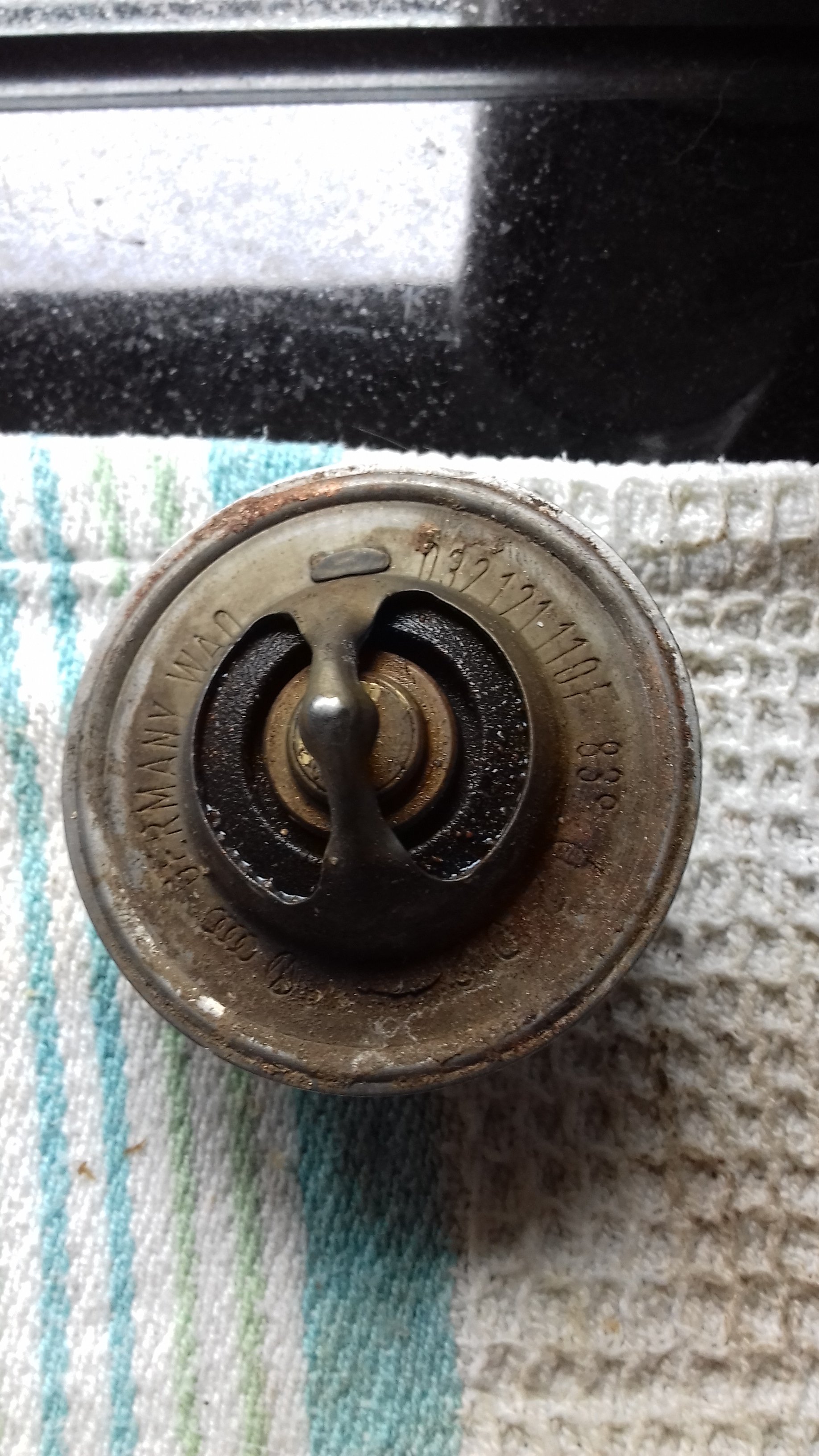

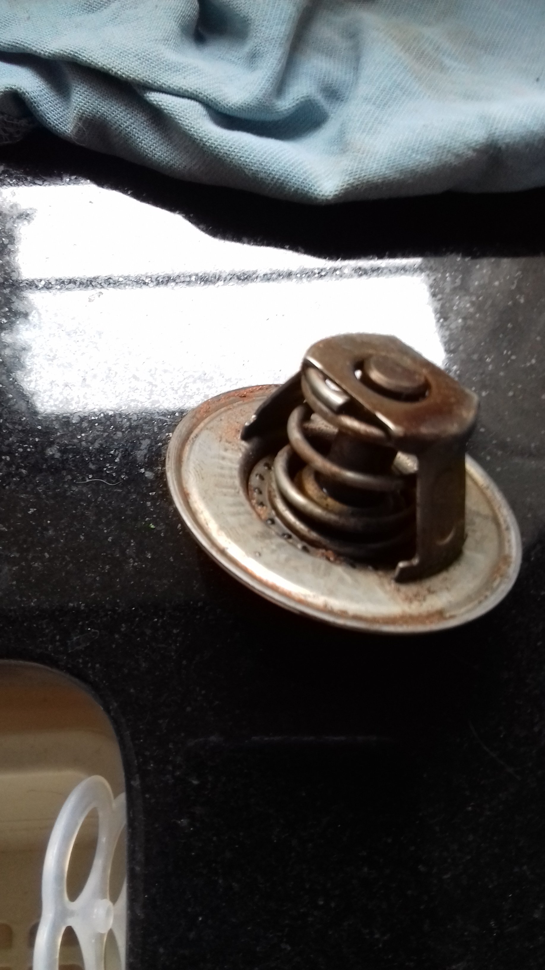

Update. Spent yesterday afternoon dismantling the front of the car. old rad off new one on.Mechanic friend James checked the head gasket to make sure that was ok. Flushed the system. Took thermostat out unfortunately mine turned out to the other one. James dropped it into container with hot water in to see if it opened up and it didn't, it didn't very good when it was removed so looks like that wasn't working, so left  that out for now right thermostat ordered. New header tank on no more warning light and alarm going off as soon as you start the car:). Car all back together apart from under tray. Took about two and a half to three hours to do. James did say if the thermostat wasn't working then that could have caused the rad to spring a leak. He also said i was lucky that it hadn't done any damage to the engine. :) I've got to adjust headlights still and give them a good clean as going cloudy again. I was told by the small family run garage i take my car to for MOTs and repairs when Jame's is to busy to do it that if you clean the headlights up as good as you can get them that if you put K2 lacquer on them it will protect them from the UV ?

It's not an AUB engine then if it's that type of thermostat.
On the service book it says AUB code though.
Weird, I know the BBZ has the metal capsule type and I have an AUB which has the plastic cartridge type. Go figure.
