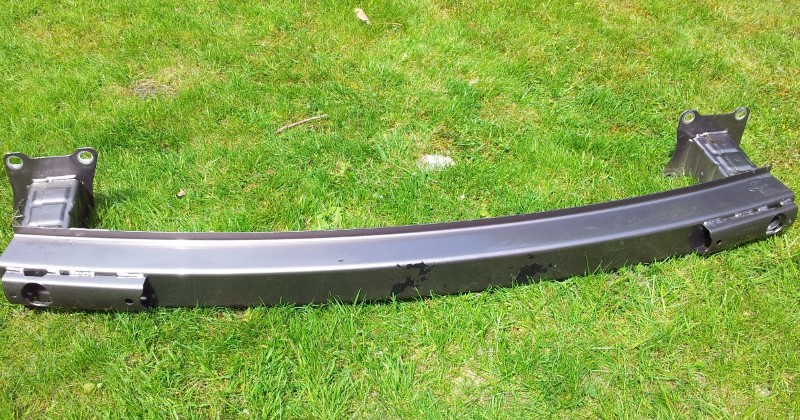

You need the steel structure that sits behind the bumper which is removed to make way for the tow bar.

When removing the tow bar, you definitely have to refit the inner (steel) bumper bar. Here's a picture of mine in 2012 (when I tried to sell it, but didn't manage to...):
Without this inner bumper, you're practically driving without a bumper, the outer plastic cover is not very strong...
