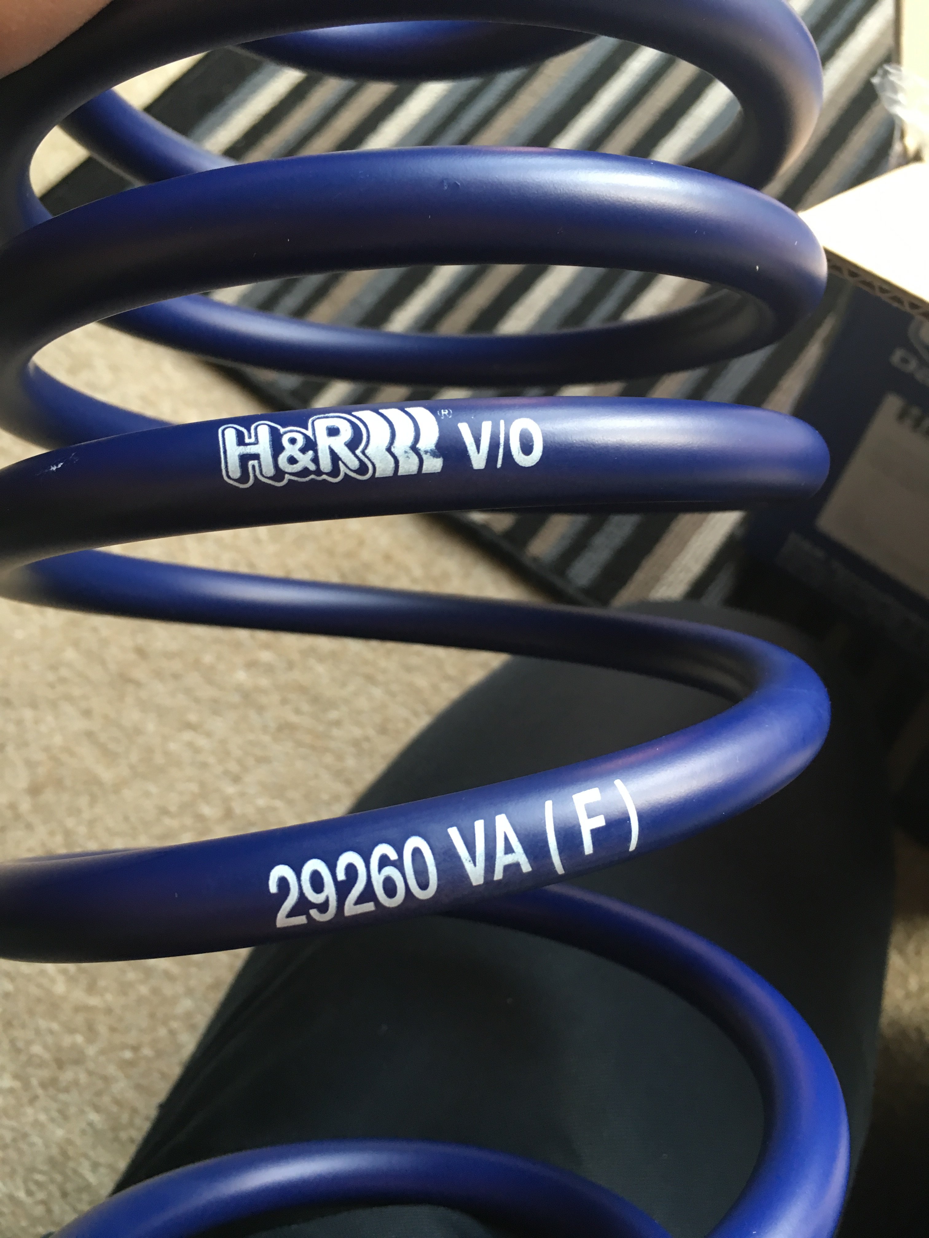

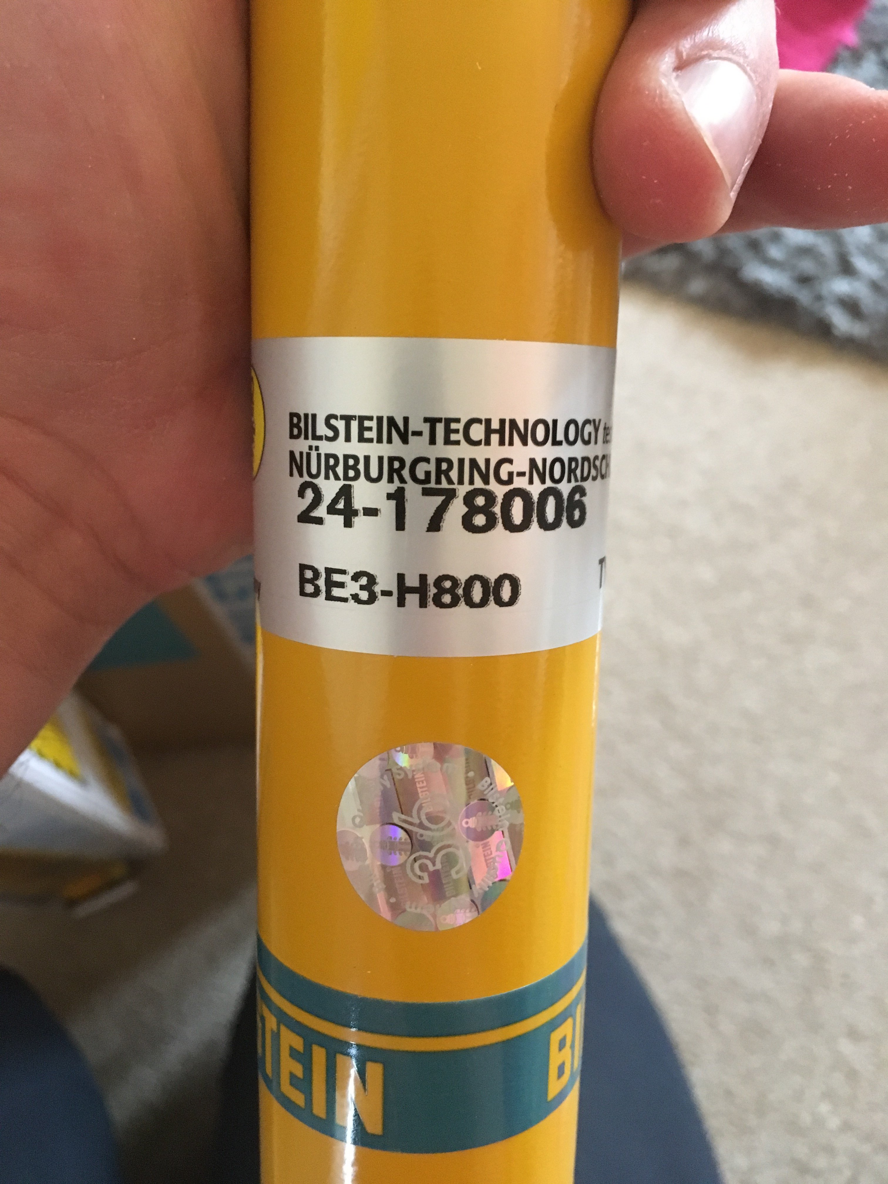

Hi guys, just got a set of Bilstein b8 and matched lowered HR s (50mm) from Damian. Will put them on car next week probably; can’t wait to see how it looks and drives.

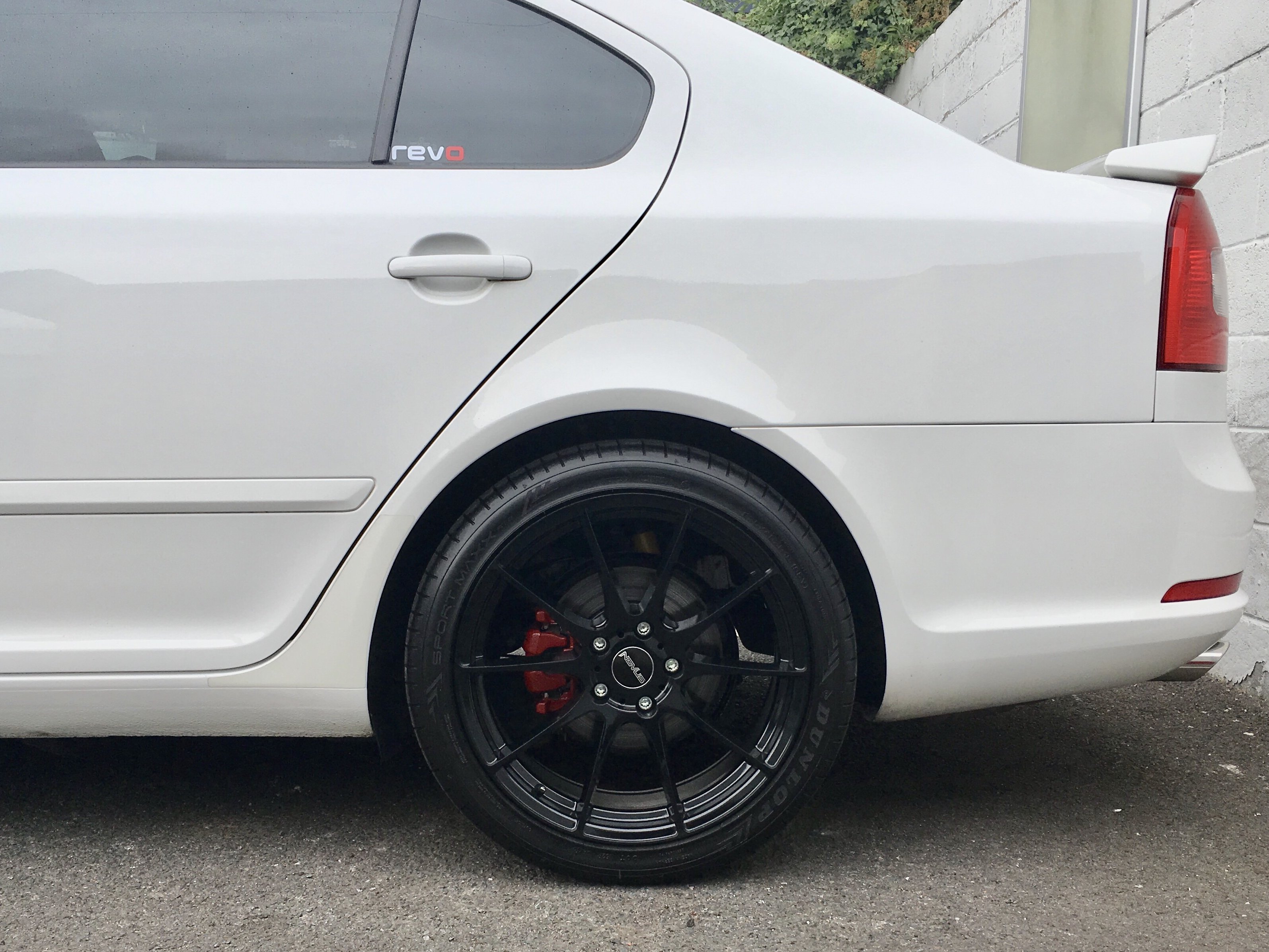

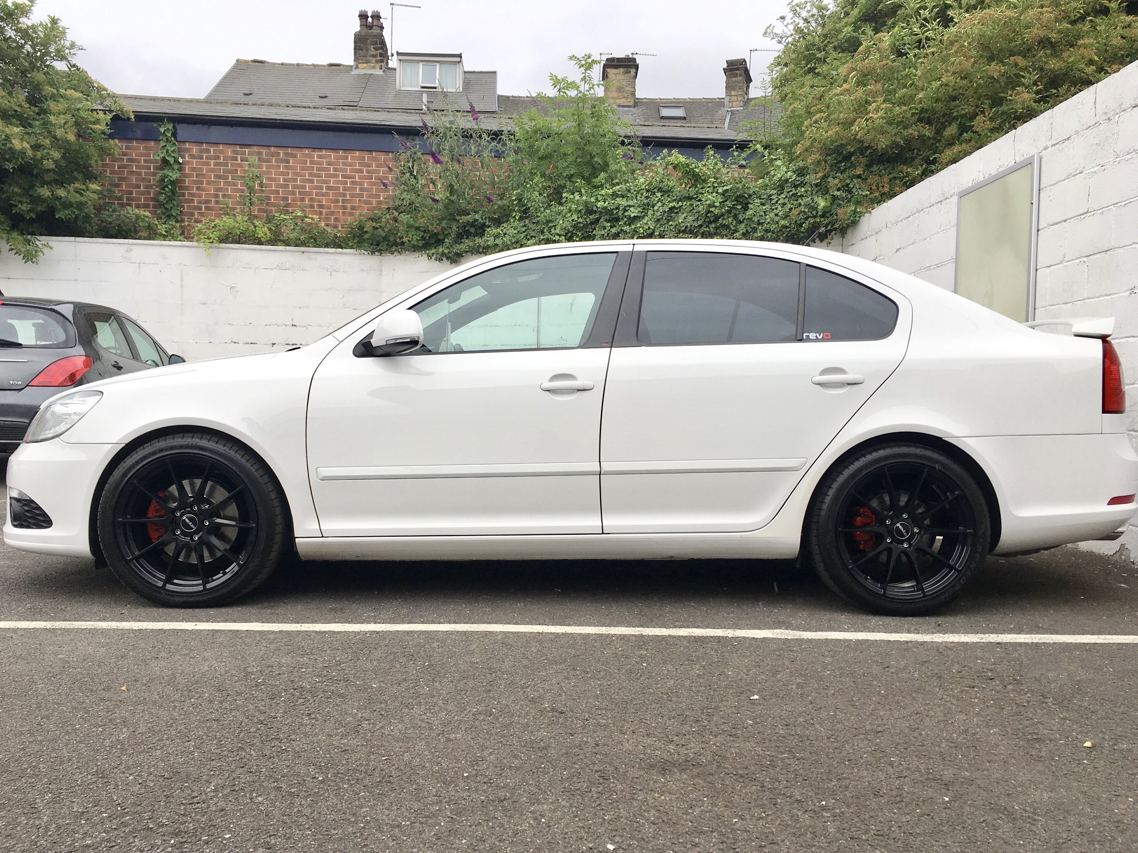

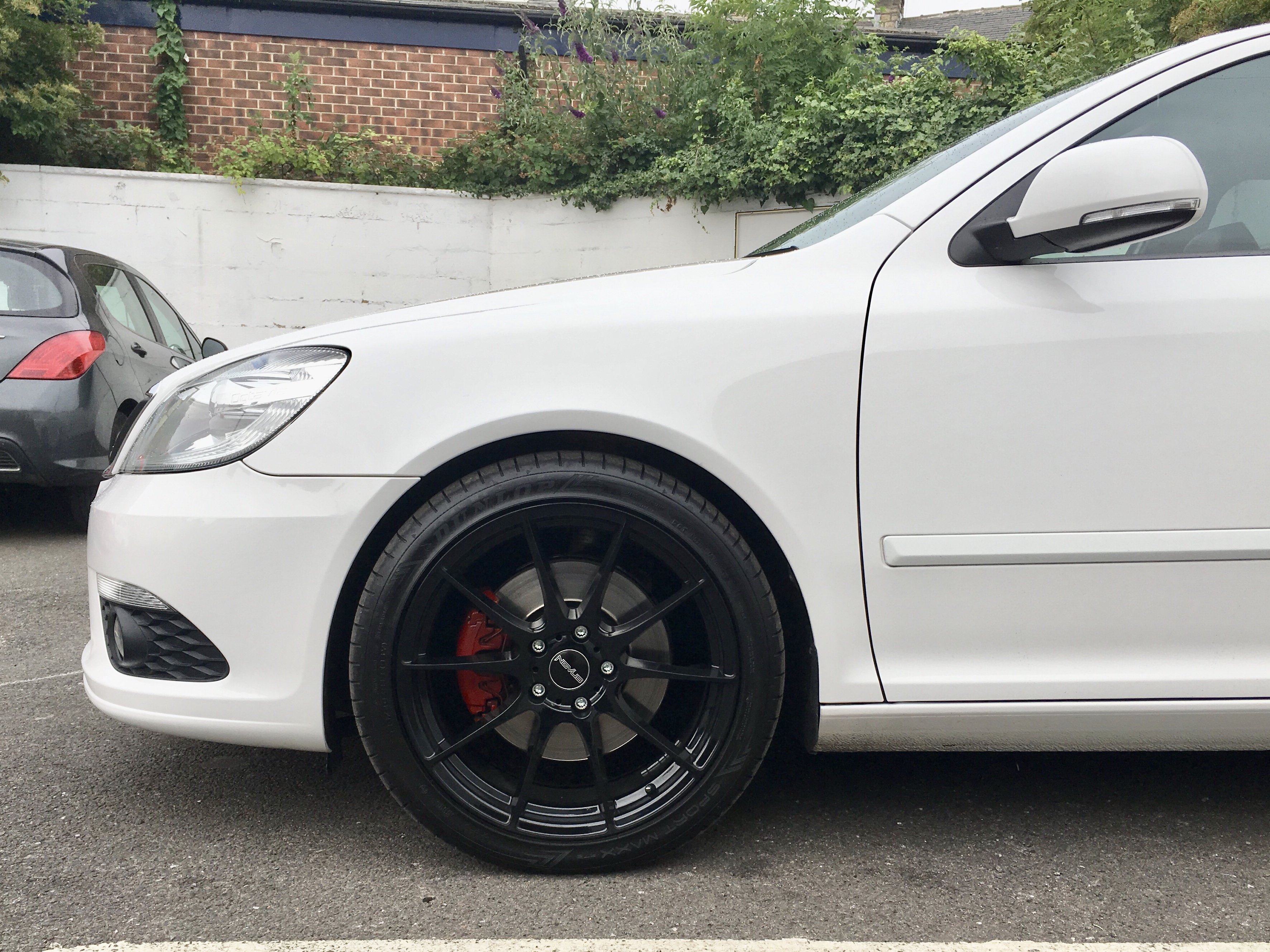

Will take some pics, anyway I expect settling a bit. Car was about 55mm (3 fingers) from tyre to fenders all around now about 35-40mm back and 30mm front. Front it’s Lower than back so looks good. I expect another 10mm all around and will be perfect. I’m happy

3. Looks have been improved dramatically: I ve started from 55mm in between tyres and fender - measured with 2 rulers, one on top of tyre the other perpendicular on it touching car - . By the book car should have get lowered by 35mm (50- 15, cos it’s vrs already lowered from factory). In reality it went down about 25mm on front ( now gap it’s 25-30mm, driver side it’s a bit lower than passenger don’t know why, but it was the same before so it’s not springs fault) and 15-20mm on rear ( now gap is 35-40mm).
I have read than it might settle down with about 1/4- 1/2 inches so 8-10mm probably which will actually look perfect and end up with a total of 30-35mm at front and 25-30mm rear which is close to what b8 and h£r specifications say.
Im happy that front it’s lower than rear so it has the nose down stance.

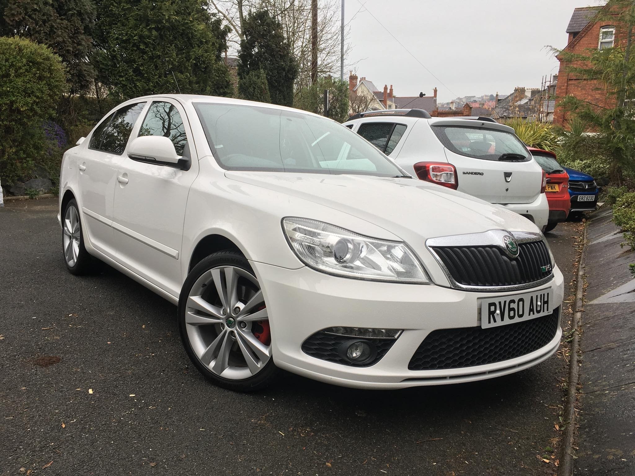

Got only one pic with car before, but you can measure your tyre- fender gap so you get an idea, 55mm it’s about 3 fingers.

Hi guys new to the site today! I have just removed a set of the 45-55mm H&R lowering springs from my 60 plate VRS & put a bilstein B14 coilover kit on,very impressed with the coilovers great handling & ride is pretty much the same as the springs was
This was on the H&R springs once it settled
