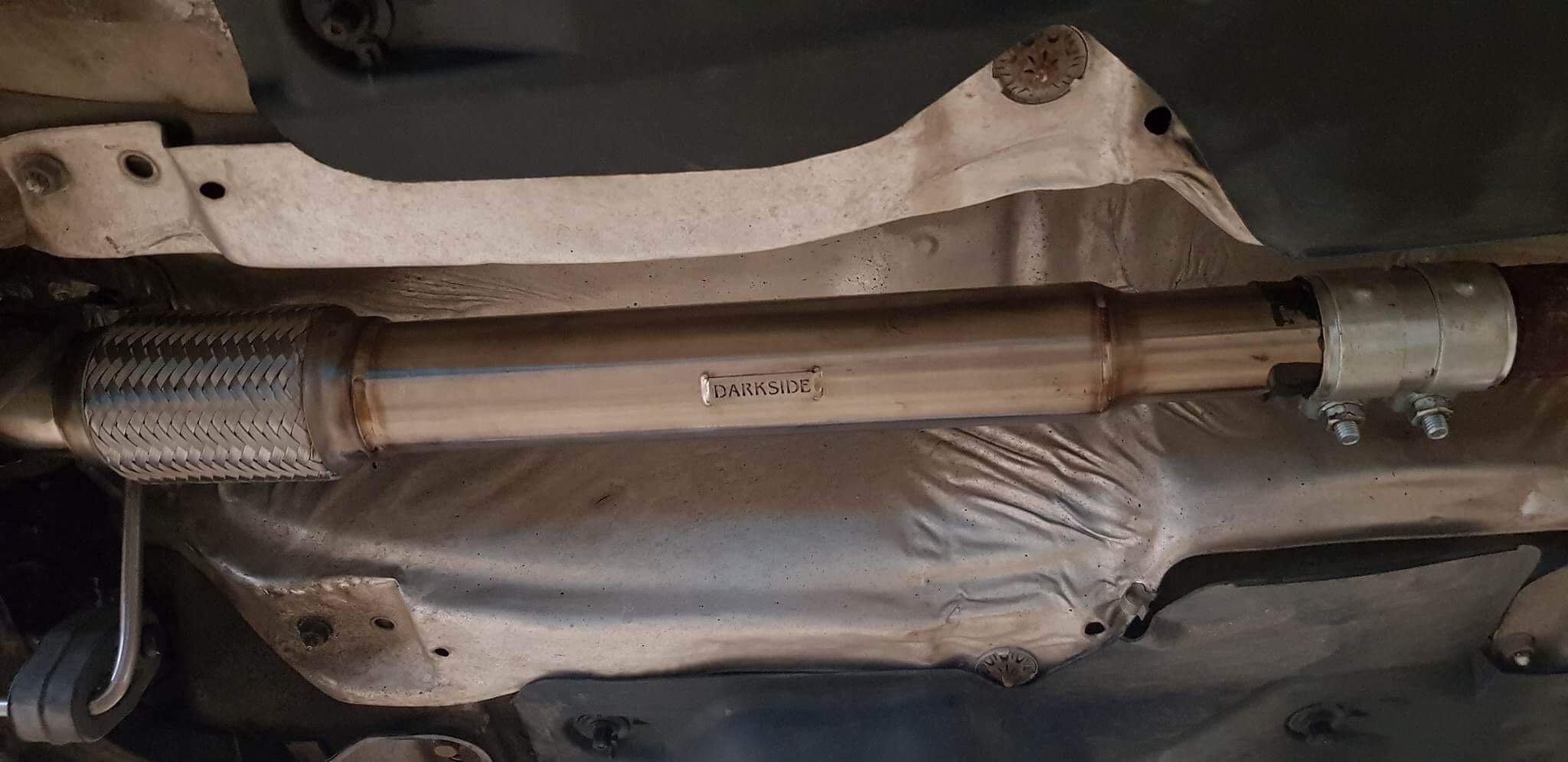

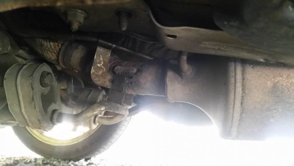

Sticking my head under the car, I've also found that the exhaust has broken just in front of what I assume is the DPF. I'll try to attach a picture of that.

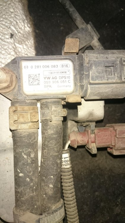

The other picture is of what I think is the DPF sensor?
Replacing the DPF sensor looks relatively simple, except I believe that it needs calibrated to the car- and there's no point doing that if the system is faulty elsewhere.

What year is your car? My DPF is at the top of the engine I have a 2010 1.6tdi elegance model. The break in your exhaust appears to be after the DPF.

The item in the picture looks like the cat to me. DPF will be straight after the turbo usually on  VW engines.

I'm guessing I'll need access to VCDS in order to install/calibrate the DPF differential pressure sensor- unless the sensor is actually fine and it was just a symptom of the exhaust starting to leak?

I would still fix the exhaust leak first and then do some diagnostics. You could attempt to take the car on a good run and try and let it regenerate but if the sensor is the issue its not going to and you risk blocking your DPF to the point it needs to come off to be replaced or I believe some places can clean them.
VCDS is a really helpful tool in the VAG world, you can manage without it but it makes life a whole lot easier and can pay for itself instantly if it stops you having to take it to a garage.

Update: car has now been into the garage and they've said that the exhaust break is indeed at the DPF, not the cat.
Bad news is that they don't think it can be repaired- not possible to weld onto the dpf itself. They reckon somebody has bodged a repair here previously and added a section of flexi.

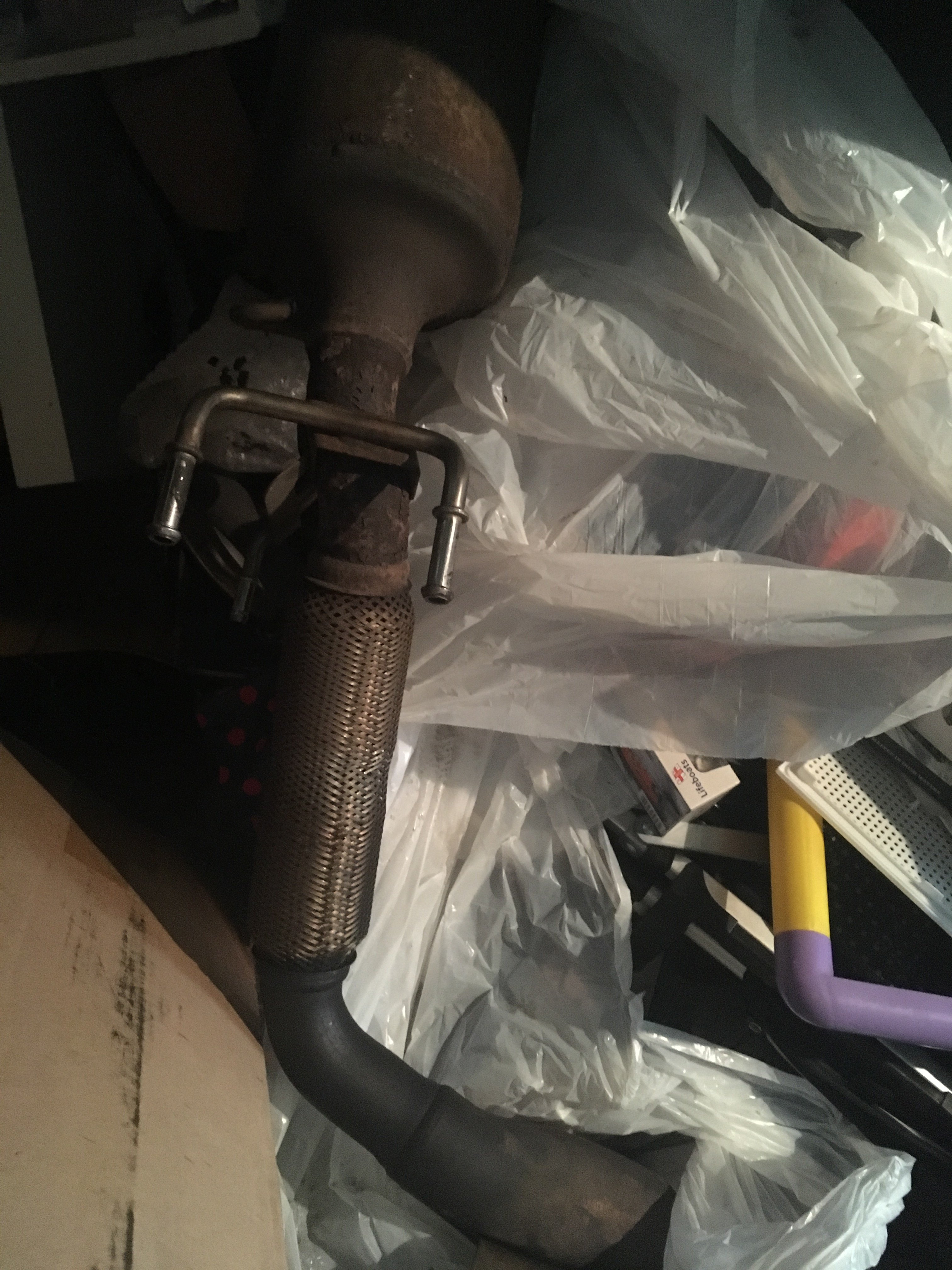

Ah I’ve got a downpipe with a cat and a dpf sitting here.
Only thing wrong with it is we had to cut out the sensor between the cat and dpf for my new downpipe but you could easily cut that out yours and weld it in.

Its sitting in a spare room came off my 1.6tdi 105 monte did 55k standard and 11k stage 1 before I went big turbo and fitted this.
@AMD87 you might have to translate that for me, but as I understand you had a DPF clean carried out and then removed it altogether with 66k on it? So should have a bit of life left.

Yeah the full downpipe was taken off at 66k.
