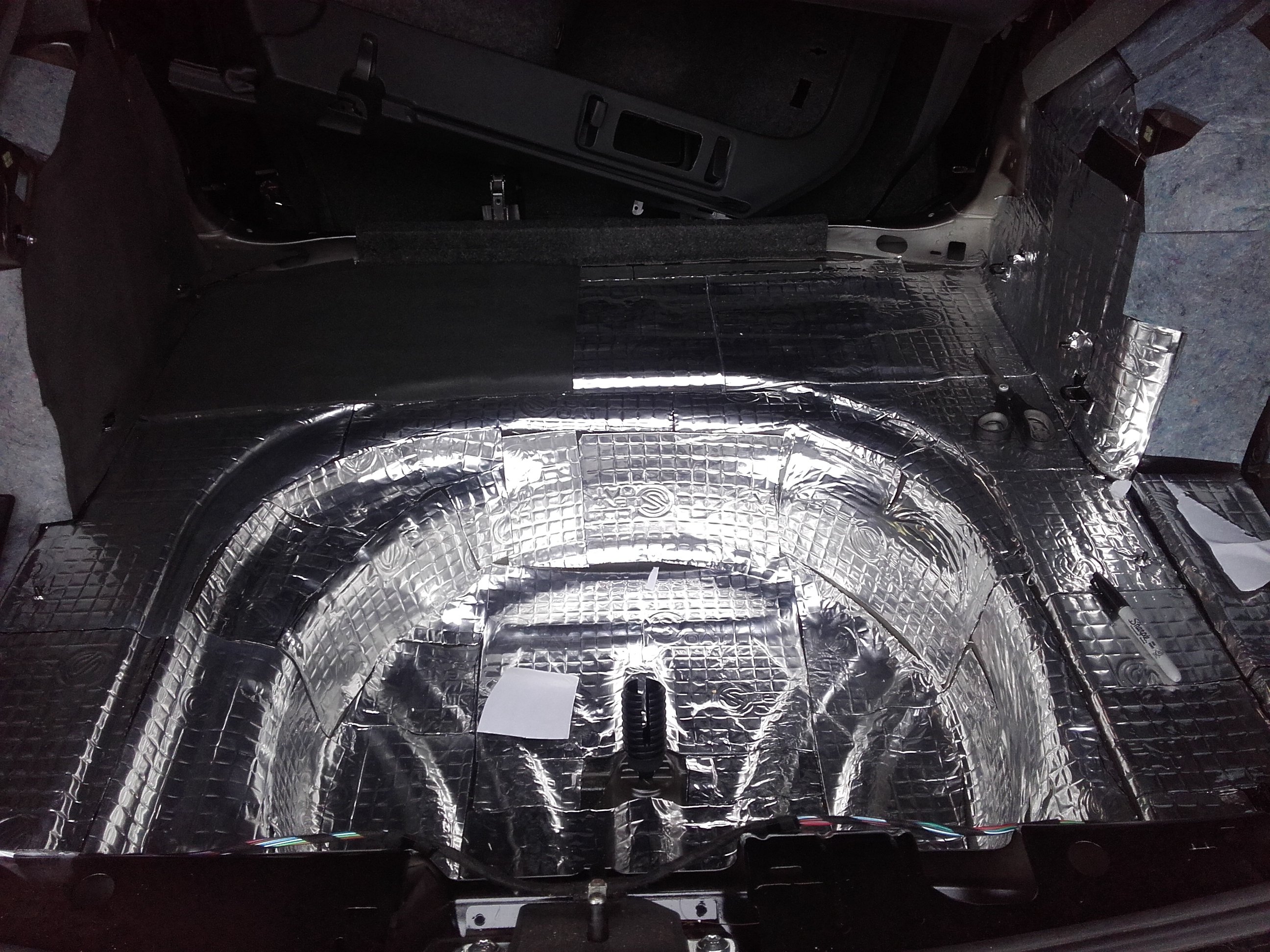

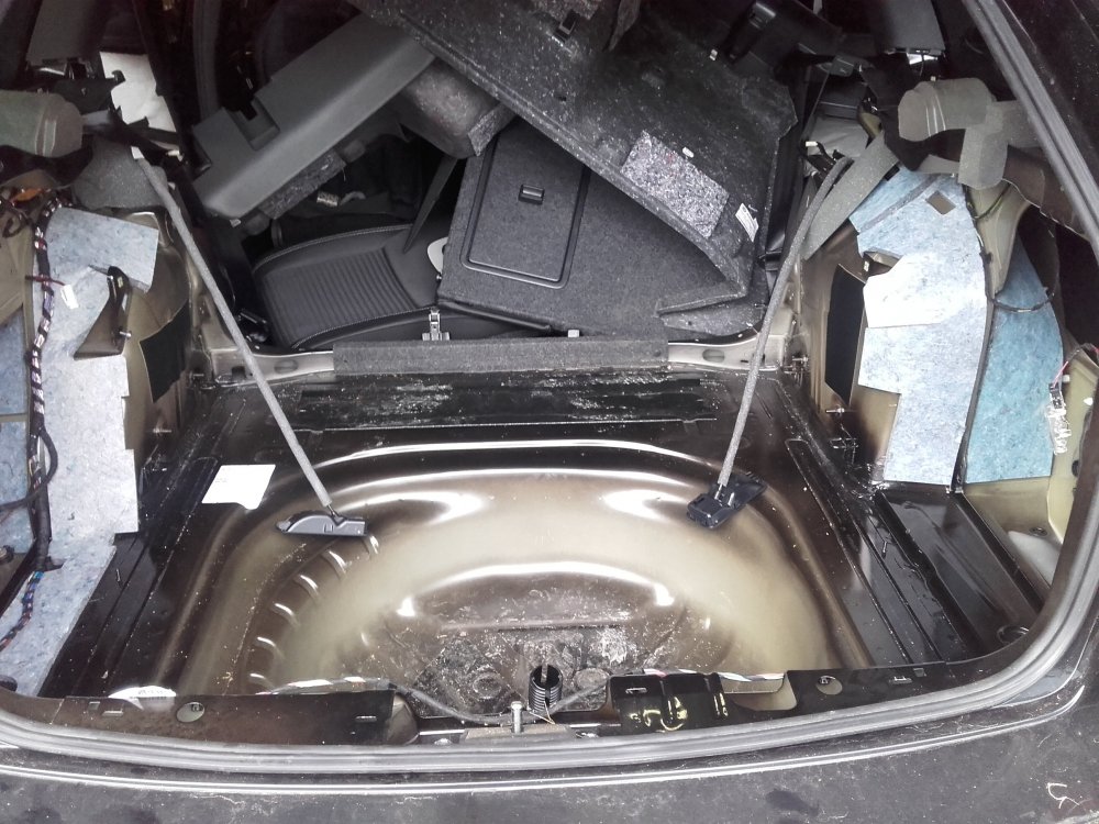

This weekend's project was to do sound proof the back of the wife's 2014 TDI vRS. 2mm Silent-coat followed by 6mm Super Liner. The result was very good. Strangely, although there was still not much insulation in as standard there was more than in my 2017 FL TSI vRS.  The TDI does have Canton so maybe they added more insulation for sound quality reasons.
Pictures attached.
